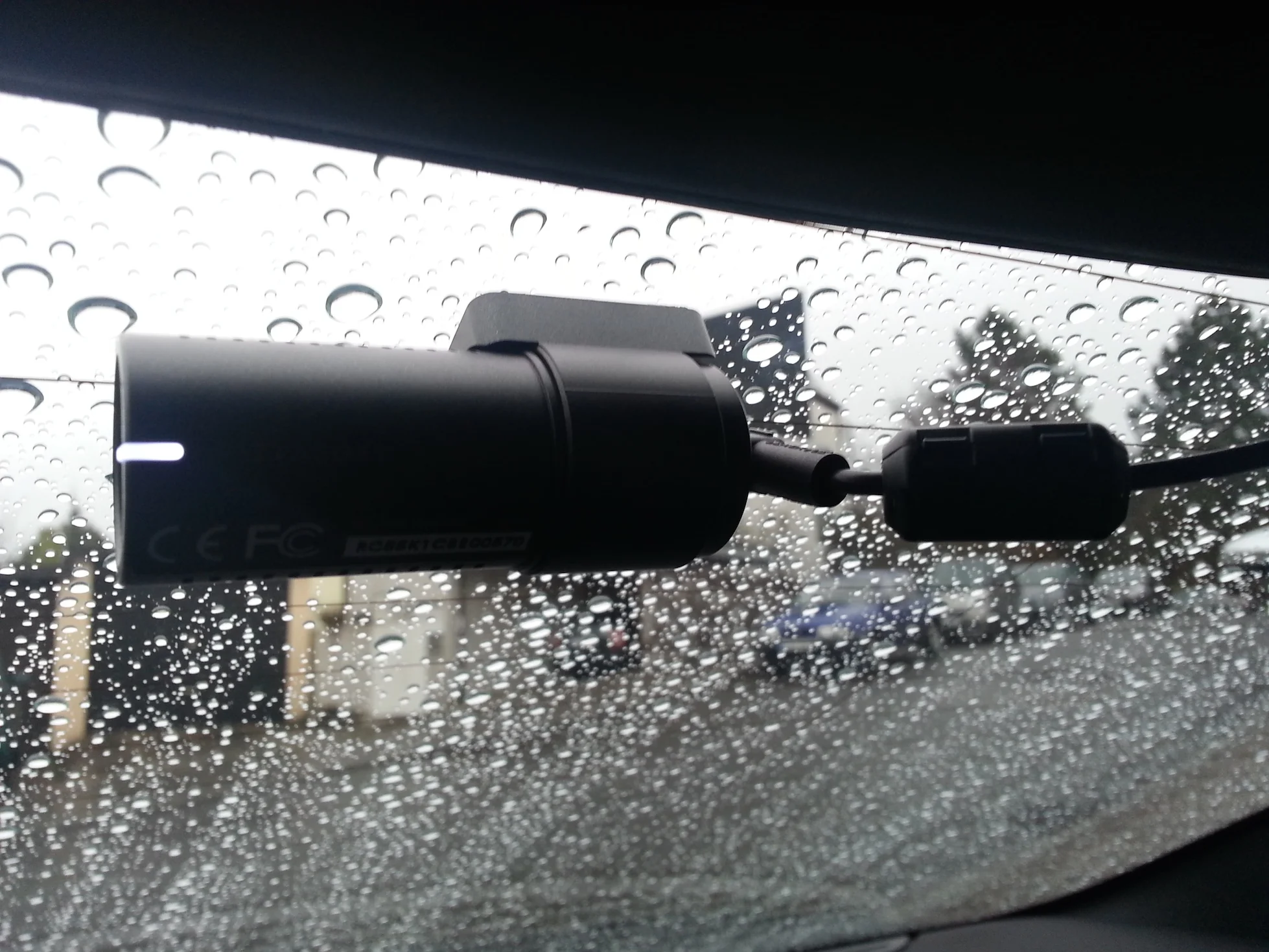

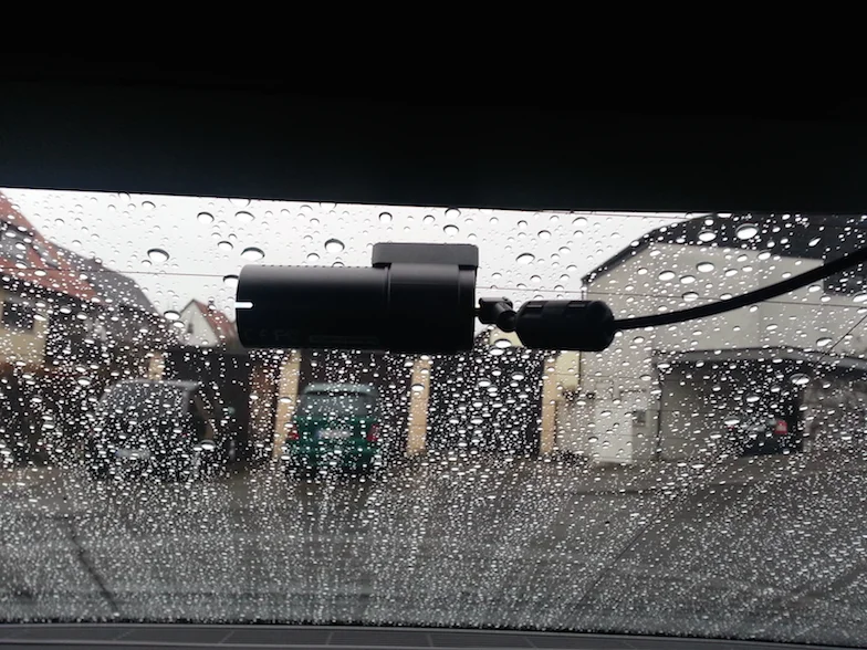

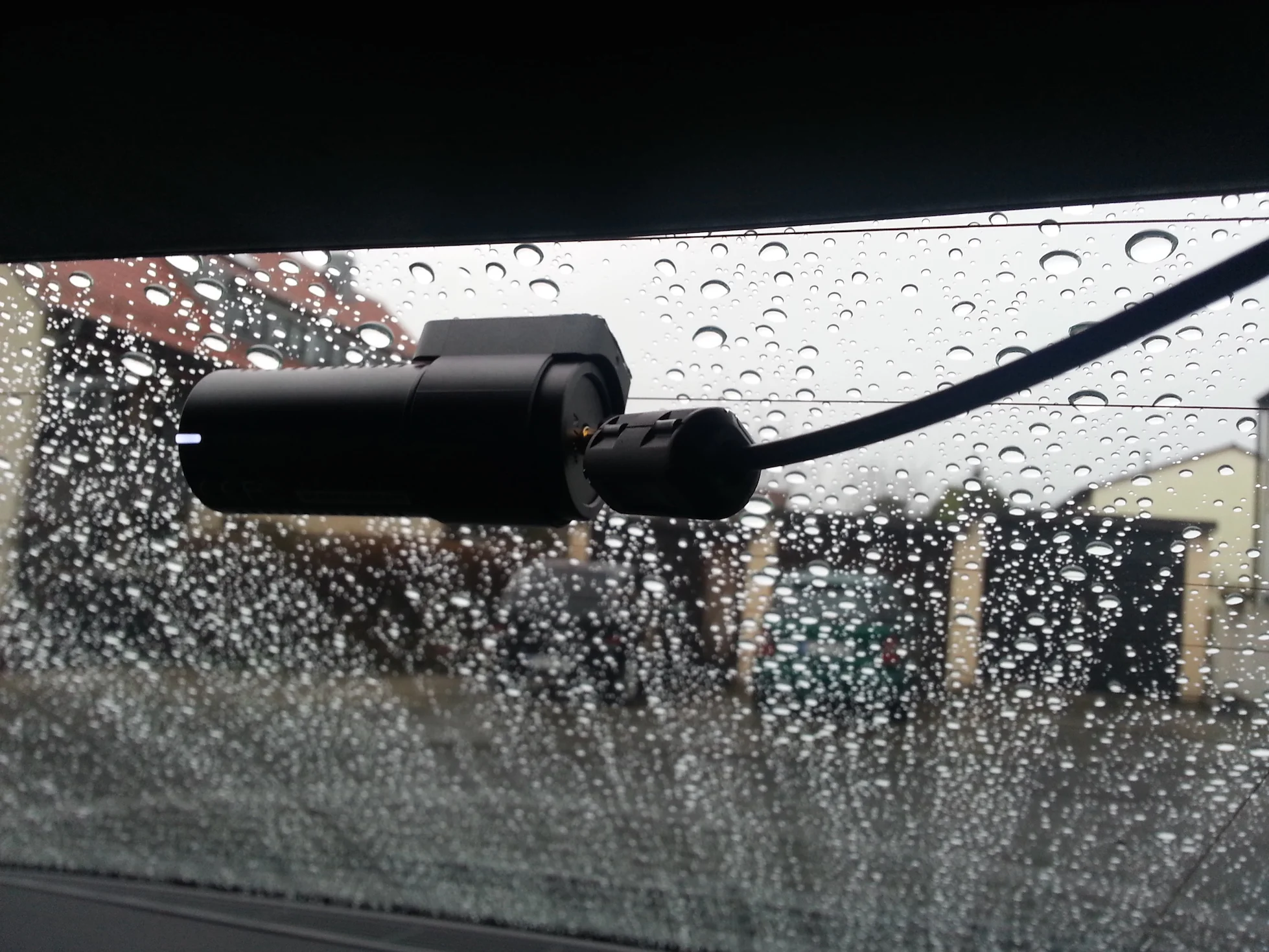

With the new cables I could now completely get rid of the interference problem. I added just one ferrit ring close to the rear cam and the interference has completely disappeared. I took the smallest ferrit core with diameter same as the thickness of the cable and closed the core without any loop. DVB-T reception has no difference now with and without the cam on. Thanks Pittasoft for the near perfect work.

On a BMW 5-series, the ferrit and the new cable did the job. Attached are some pics
