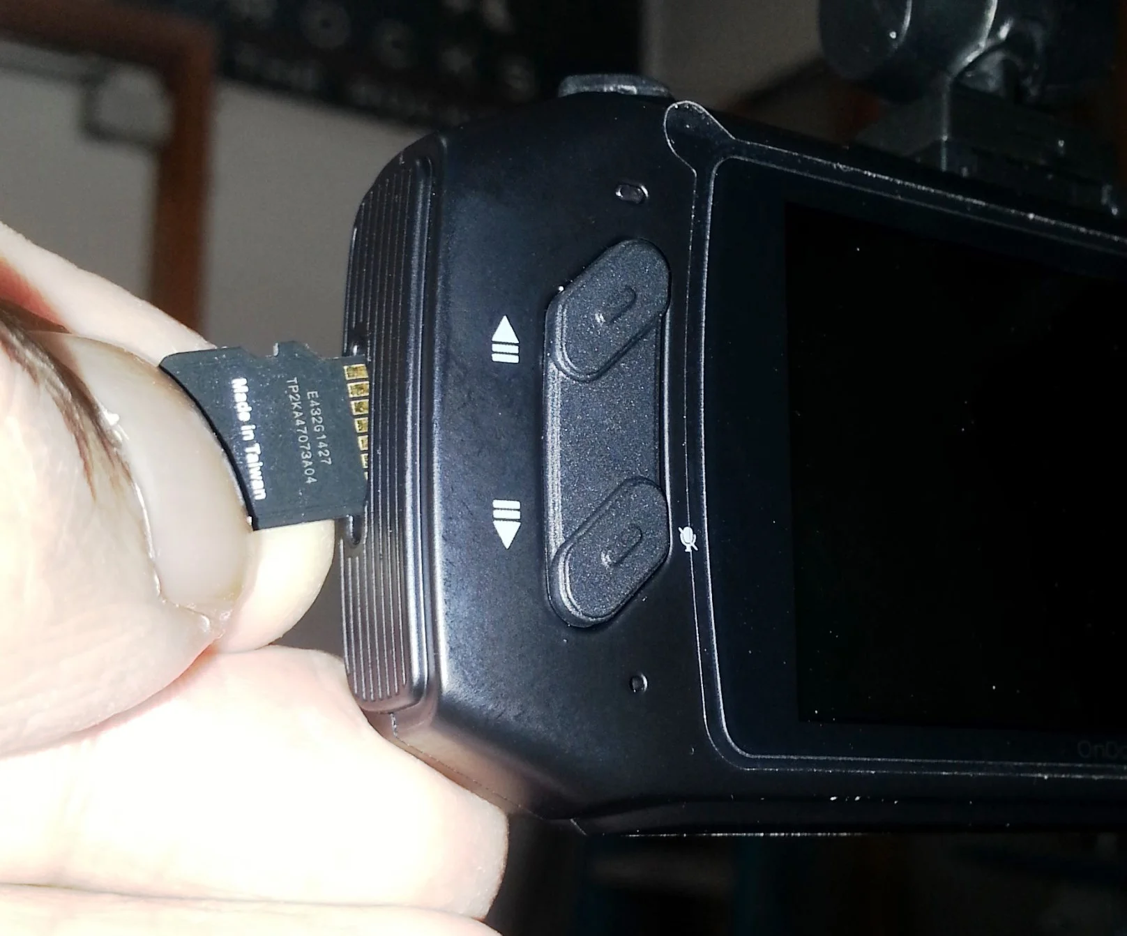

MicroSD card goes in with pin stripes on the back:

Left edge has microSD slot:

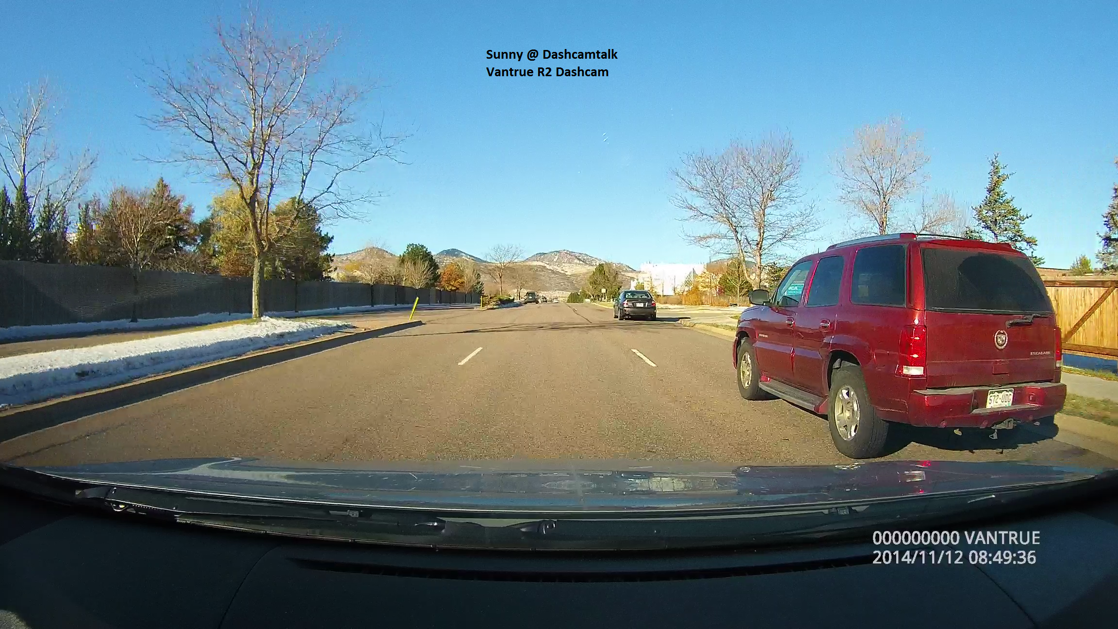

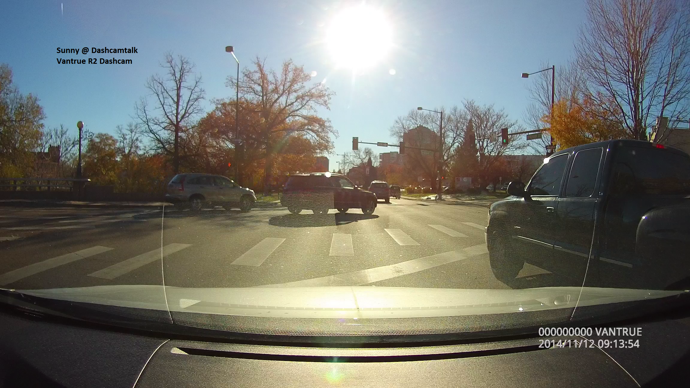

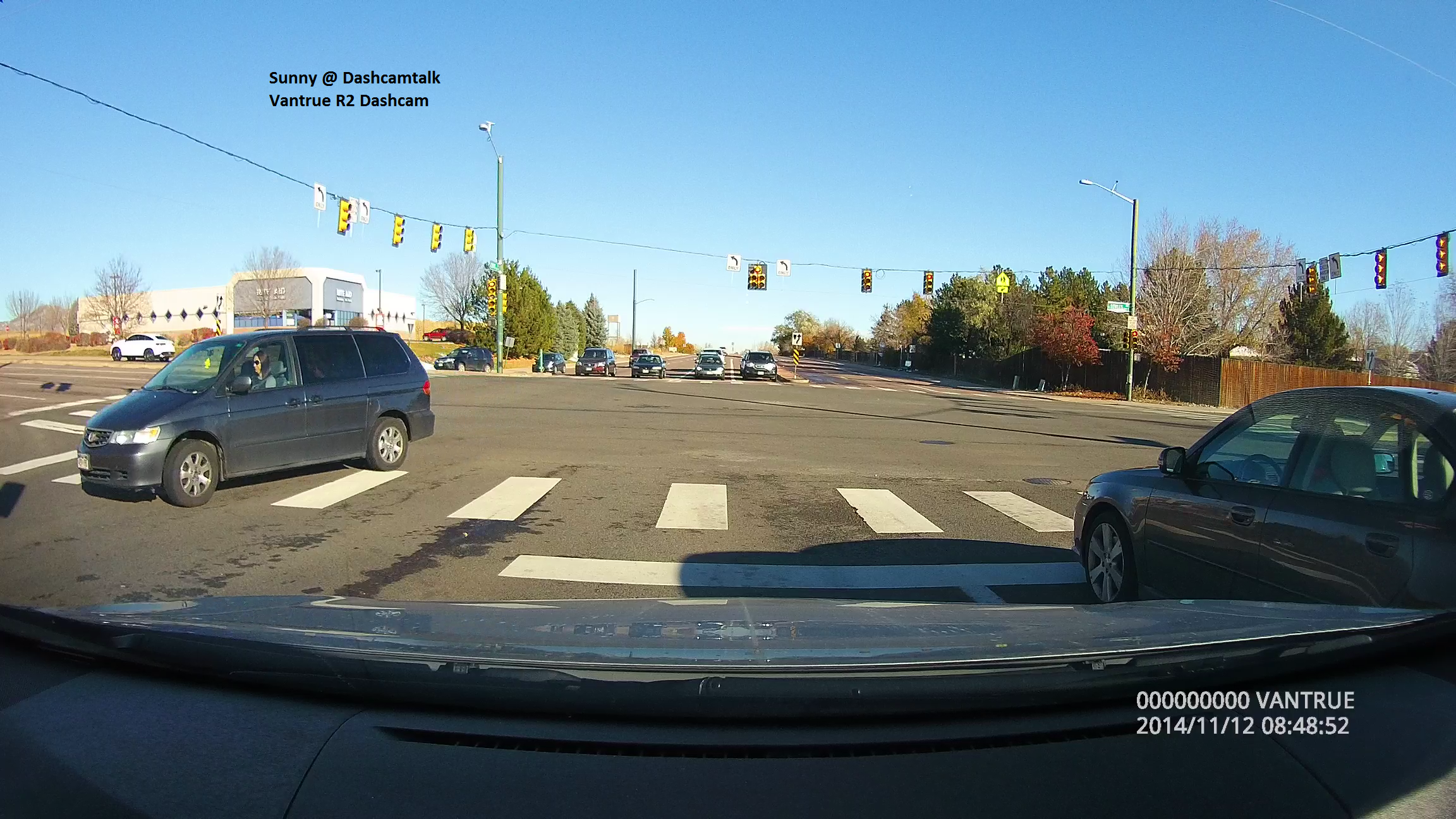

Daytime video screenshots:

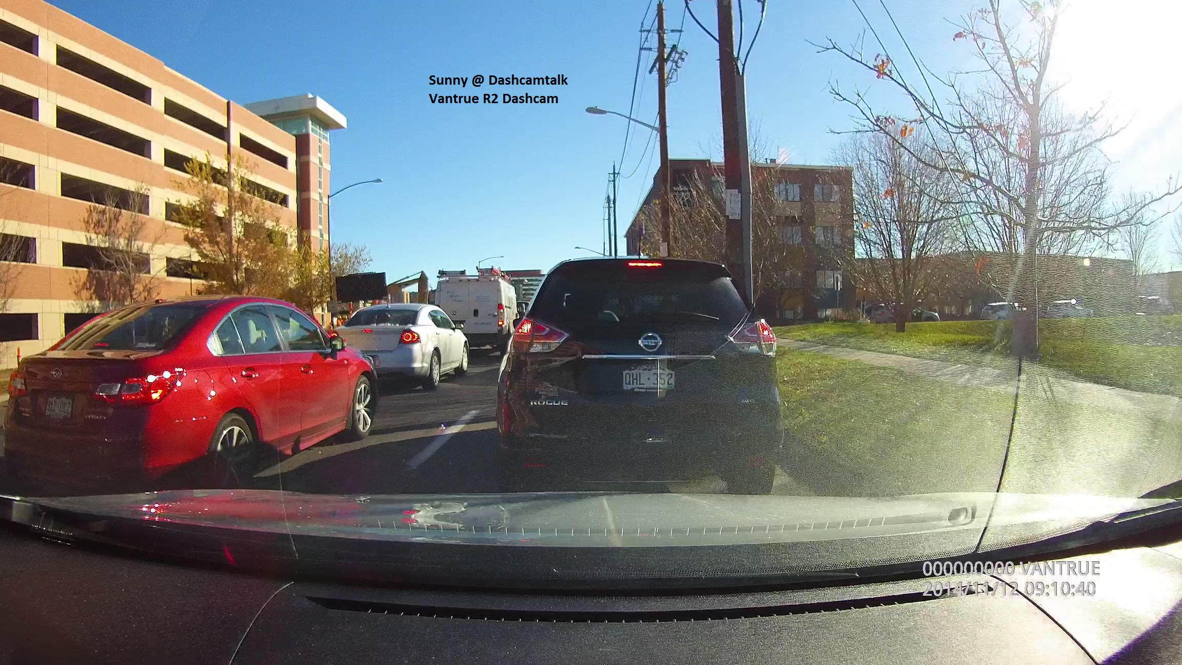

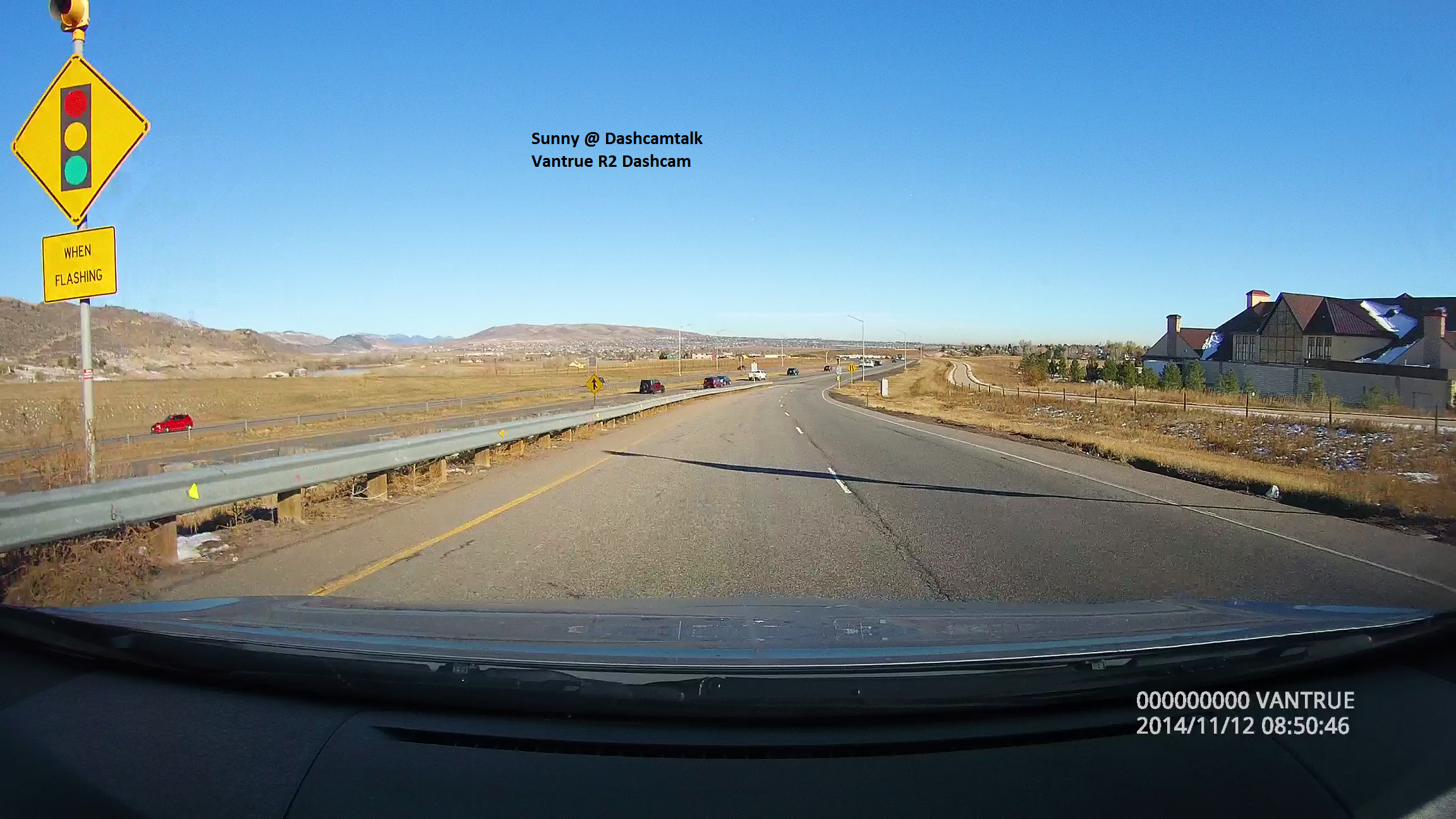

Daytime video is very good.
All areas/corners are in good focus and colors are natural.
I like how it's not overly bright like some other Ambarella based dashcams.
Most screenshots are from the spots that I normally use for other dashcams so it'll be easy to compare.

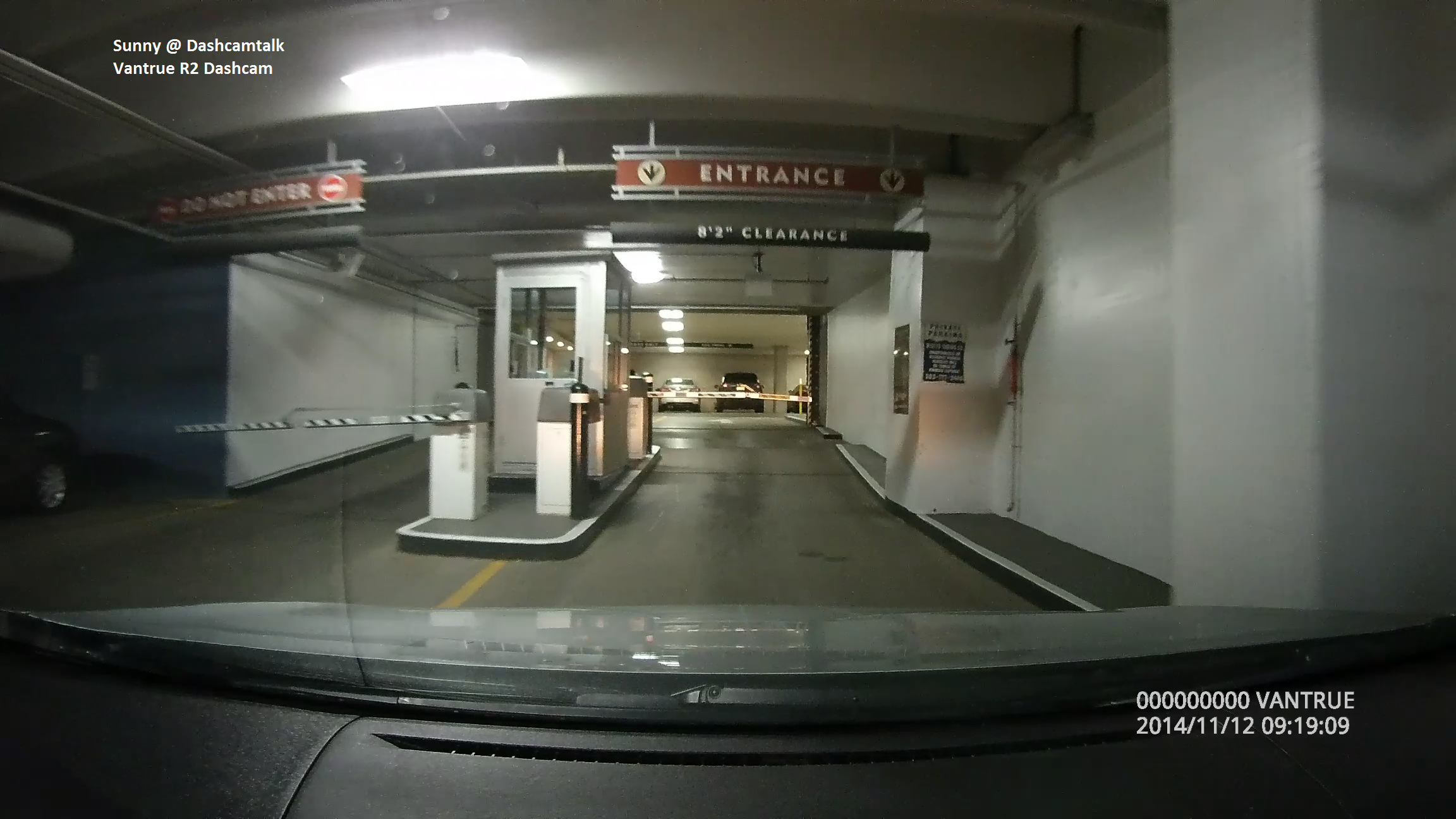

8. Against the Sun.

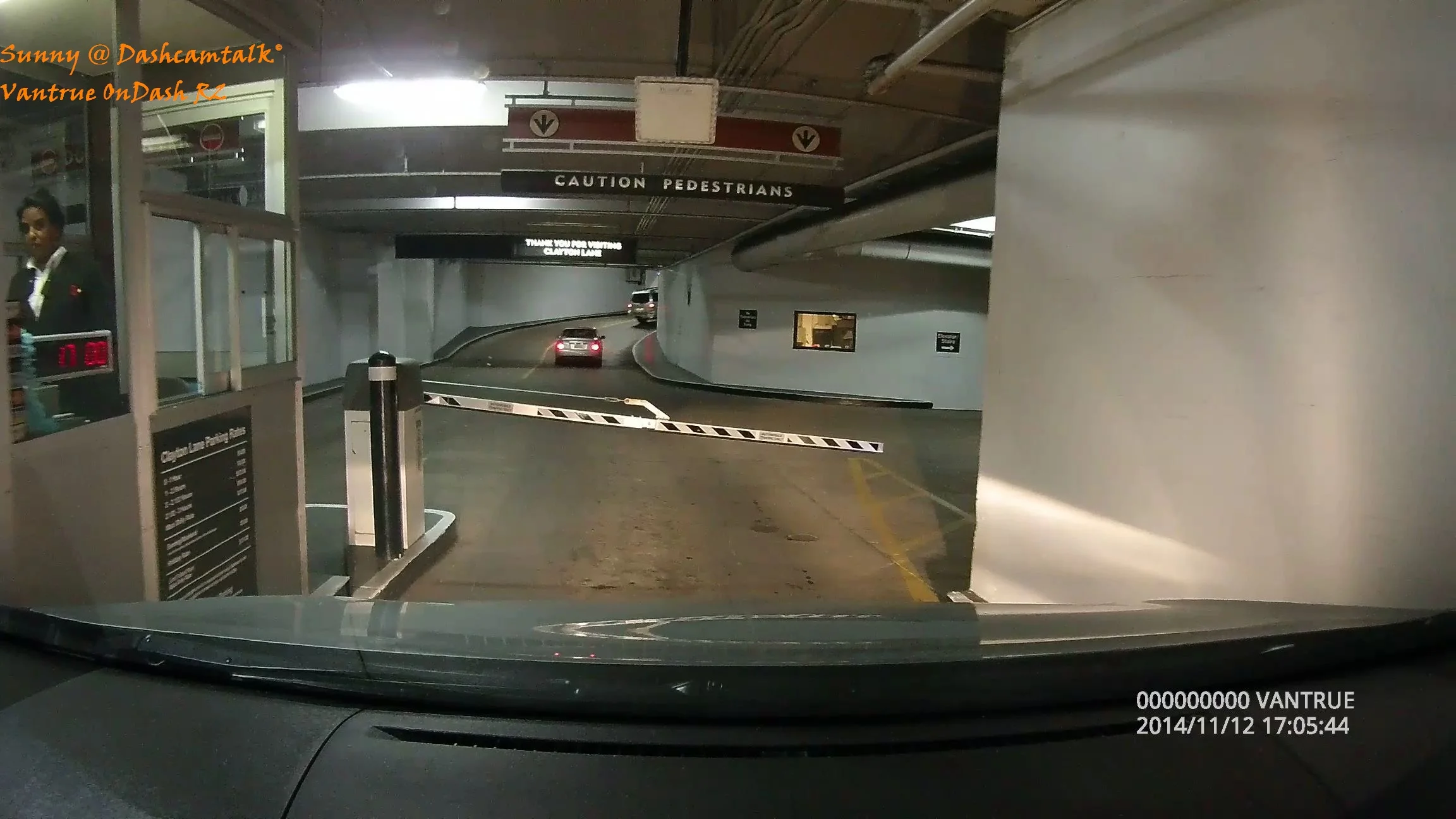

9. Underground parking garage.
10. Underground parking garage.

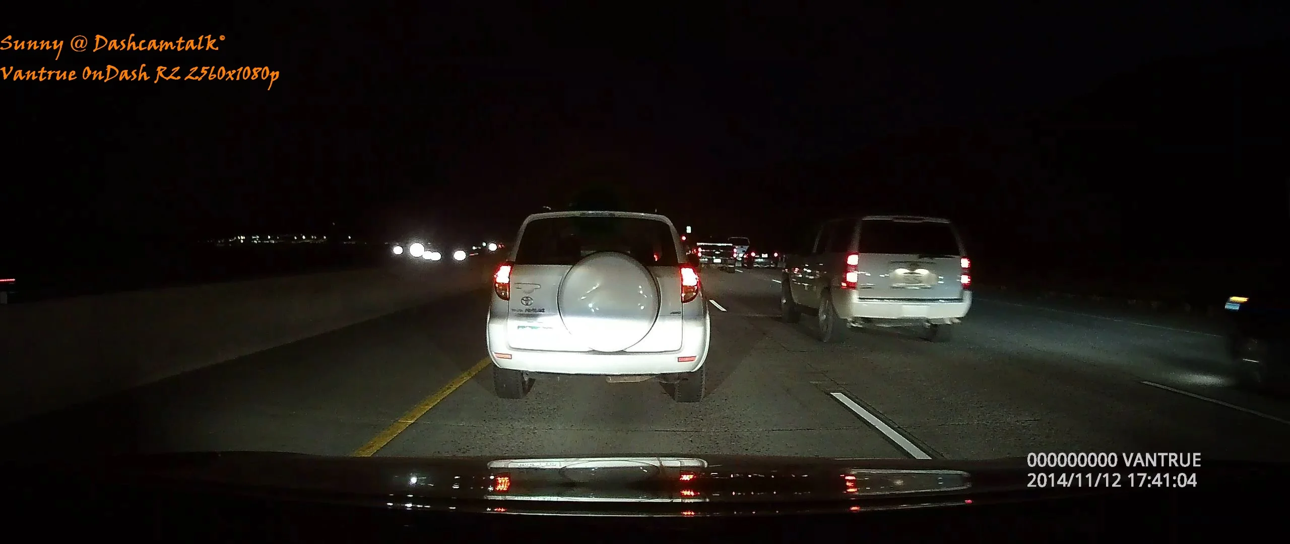

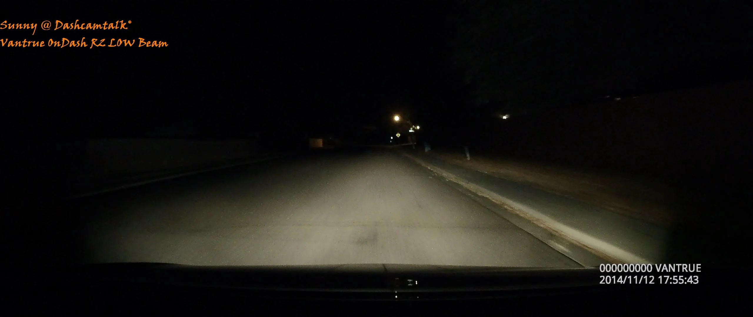

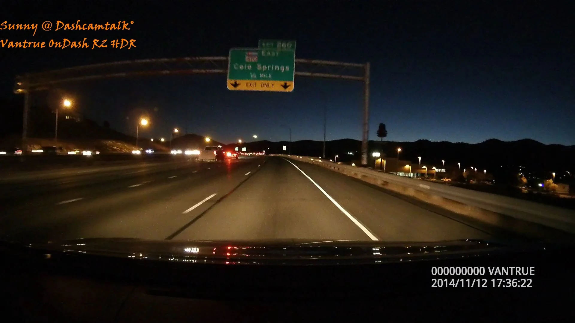

Evening and Night Video Screenshots:
HDR:
Low beam:
High beam:

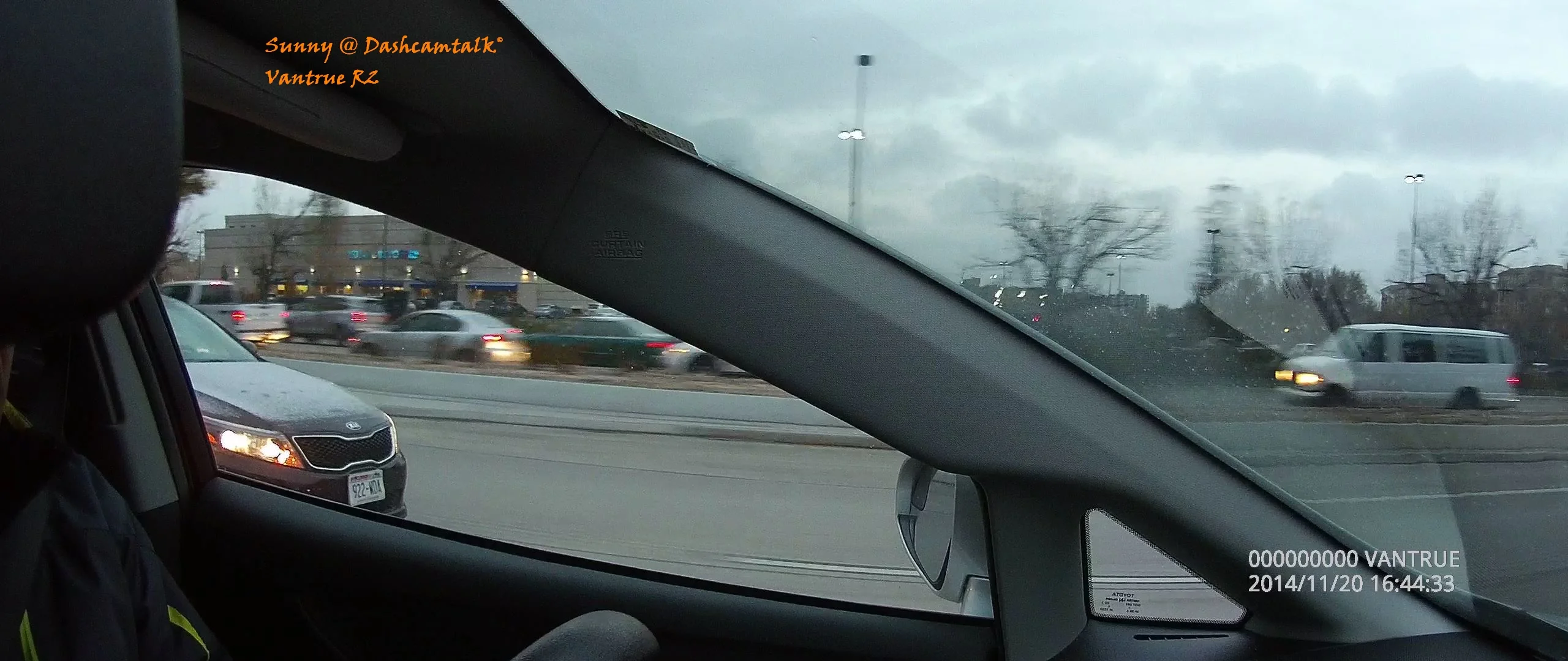

Vantrue R2 can be rotated pretty much from the center of windshield to driver or passenger side window.
I tried this today and worked pretty good.
Can read license plate through driver window.
