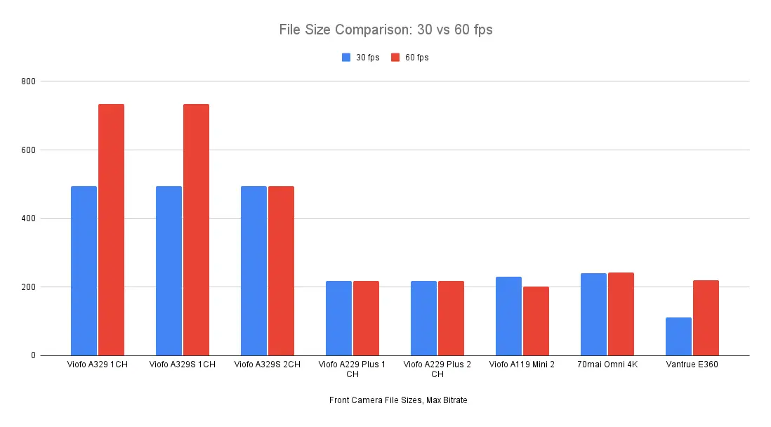

I also did a comparison of file sizes with different dashcams. Interestingly some show larger file sizes when you double up the frame rate which is what I'd normally expect, some keep the file sizes constant, and one, the A119 Mini 2, actually lowers (!) the file size when you jump to 60 fps.

What are the bit rates between 30fps and 60fps? Ideally doubled?
If they are similar wouldn't that also affect detail?

In the graph it shows the Viofo A329S 2Ch having exactly the same values but with 1 Ch it is different. Is it possible that 60fps is not working with 2x cameras?

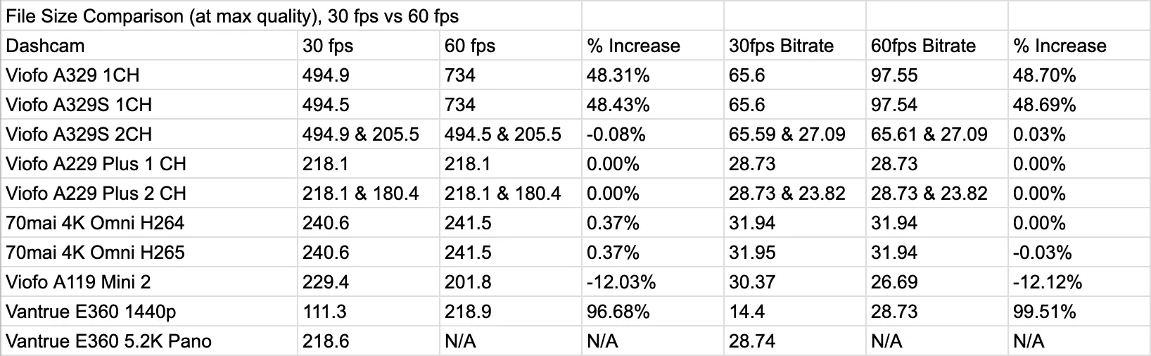

Here's the raw data, including the percentage increase of the front cam:
I'd reported to Viofo earlier that 60 fps videos on the A329S are only capturing at 30 fps even though the files are saved as 60 fps, and they're doubling up every frame. I haven't doublechecked with the latest firmware to see if this is fixed. With the original A329, it's actually capturing at 60 fps, so perhaps that's part of the difference?

Thanks for sharing your raw data.
I'm assuming the video length is the same for all examples, perhaps 1 Min?
It is interesting that the only dashcams that appears to work as expected is the Vantrue E360 and the single channel A329n
I wonder if there is some sort of interpolated or stronger compression being used on some of the units?
The doubling up on every frame could that be interpolated? I'm guessing but I would think it would allow the file spec to show 60fps ?

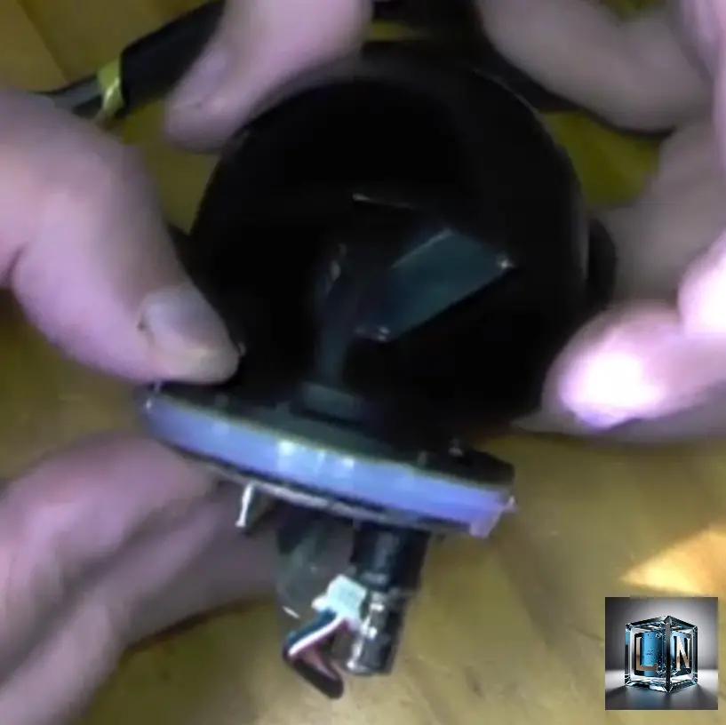

It's fun nerding out over this stuff!
I agree. Unfortunately in my early days of dashcam testing, Dashcam manufactures didn't like their underbelly being exposed. I enjoy pulling them apart! Things seem to have changed recently.
Yep, lol. I didn't wanna just look at the bitrates and extrapolate or anything, so I figured I'd just let each dashcam run for at least a minute and then just pull the numbers that way.
So if you go frame by frame in the "60" fps A329S/T clips, there's no interpolation in between. Just 2 identical frames in a row and then 2 more identical frames in a row.
lol.. I used to do radar detector teardowns back in the day, but I stopped because I ultimately didn't understand enough to make it be sufficiently meaningful. There was some cool stuff I could glean about the layout and design, but I didn't know how to follow the path of the signal going from the antenna, through the various amplifiers and processors, and ultimately out to the speaker and display. Radar detector companies also used to complain that I could put things back together in a way that could compromise performance or some of the stealth characteristics (allowing signal leakage back out) and so just to be safe, I've opted to keep things factory and not have anyone wondering if I'm unintentionally and unfairly making something perform worse than it should.
