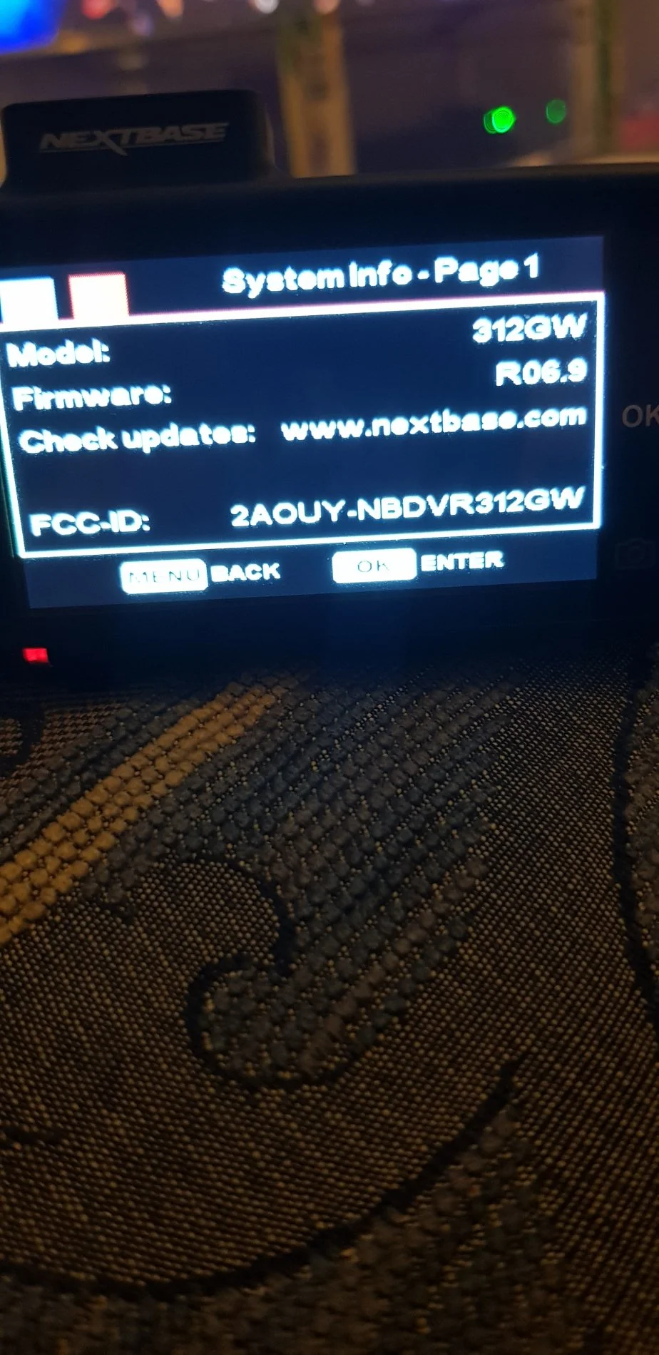

So I have got the 312GW and it to keeps freezing.
I've checked the firmware and it is all up to date. R06.9
When I go into Wifi and try to view stored images it searches then loses connection. When I switch wifi off it has a frozen image of the video.
I'm using a 32Gb Class 10 SD Card

Just a suggestion but have you tried re setting the dashcam via settings within the dashcam? Or not if then downgrade back to the previous firmware
mrmagicpants
Dec 27, 2018
2
It's the same firmware that was installed. Nothings changed.
I'll try the reset thanks
