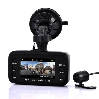

Claims to have 3 cameras - two forward stitched together for very wide angle, and one backwards. "Sounds" fabulous....
http://www.amazon.com/O-SKY-Panorama-Ca ... dual+lense
also available here...
http://www.chinavasion.com/china/wholes ... ing_Angle/
As is usual for dash cams, theres no clear manufacturer and no confirmable way to get future firmware updates or even an online user manual. The specs say 260º for the front camera, but the sample video doesn't look that wide. 260º should show the driver and passenger seat while viewing the road ahead, no?
This cam looks great - i love the idea of recording everything that's going on around the car, but i'm concerned about the typical - crappy video and buggy firmware.
Any info would be most appreciated.

I'm calling BS. I'm guessing bad quality and firmware.

I think someone in the marketing department failed Geometry.
Maybe 160 degree front and 90 degree rear, if that. Never mind if it's actually HD or not (It isn't)
Re: 360º, triple camera dash cam - cool or too good to be tr
No doubt the 260 degree claim stems from having a 130 degree lens in each side
Two front cameras have each 130degree diagonal or about 90 degree true horizontal, combined they give about 180-190 degree true horizontal. Each front cam records at 720p but later via software interpolation combines two images in to one 1920 x 500 something, so end video quality result is very poor.
Amazon ad says 1/2" cmos which is BS.
Rear camera is VGA which is also no good.
But taking into consideration price what else do you want to expect?
Similar solution true FullHD video quality Korean dash cam system with good night vision, high bitrate, high FPS would cost 5-10 times more.
Dont forget the rule: you will get what you pay.

Actually, its not. Both front camera each with 130deg angle will be stitch together to form a 260 deg panoramic view. The back camera which is also a 130 deg cam will cover the rest. Its not a FULL 360 deg but it does cover the entire front of your car all the way to your side mirror.
See attached for a video demo contributed by a truck driver in Singapore. Note that the video is bobbling up and down is due to the vibration of the truck.

However I think front camera 130 + 130 is diagonal, not horizontal, but this is only my assumption, because I did not held this product in my hands, so hope "dalenorman2005 " can give us some of review after receiving and testing it.

I'm sure it's the diagonal measurement, the lenses are offset at 90 degrees to their center point so would never make a 260 degree image as there's the necessary overlap, it does however create a very wide field of view which going by the image is clearly less than 180 degrees but not by a great deal, 165 to 170 maybe, very wide in anyone's book, rear image is either cropped or about 85 to 90 degrees going by the results
