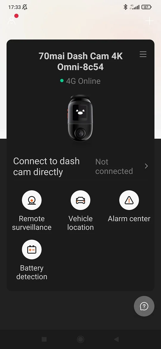

O also after binding the 4G modem, i was not able to use remote surveillance, but i could preview events as i got them in fast and furious using motion detect on high setting.
Fixed that by rebooting the 4G modem on its button.
