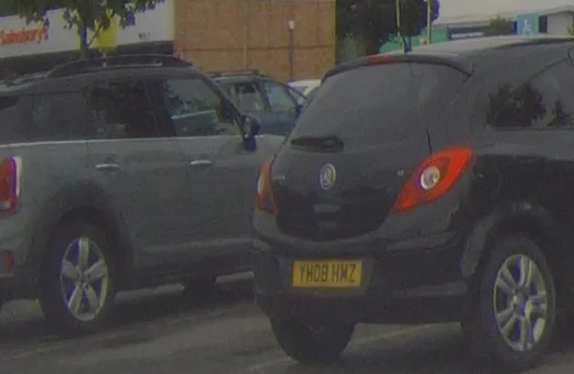

As expected, the 4K image offers more detail across the whole frame than the 1080p wide angle image. The telephoto resolves more detail in the centre of the view than either wide angle camera. We can even read the number plate YC11 JKV on a car approx 25-30m away.
To get an idea of how much detail the 4K image contains, let's look at a direct 1920x1080 crop from the middle:
y4muSxPx3G7L4aIsE07CHI9fkwVtKDtMhcZTzrE3viAZ5esa1wpNgK_Gs4hP4Sh6RgEuAJ_uTAVhgt90cgrMCBZfvNWPnd_h1Ph23-qx-L9310rPEzmxIaUiVj8y_-Ba2onolgMS_Ng_Fw7P9nOUfZXhO1nLeaRRfkFHQFCI22-1LQtO82tx49A7ET_1vE2BpY0gSDk3v0tm1DctZrHIw_YOw
There's not as much detail dead-ahead compared to the telephoto camera - we can't make out the same YC11JKV plate - but there is substantially more detail than the standard 1080p wide angle image. Even at the edges of the frame we can read number plates that are completely lost on the 1080p view, and of course outside the FOV of the telephoto lens:

Comparing the 1080p 6mm video directly to the 1080 crop from the 4K camera, the telephoto camera resolves a little bit more detail as expected, at the expense of being limited to a narrower FOV.

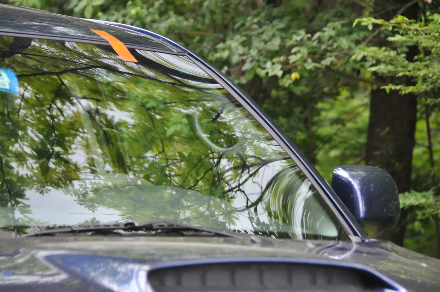

Speaking of which a friend came for lunch today that had just purchased a brand new Honda Odyssey, noticed when they were leaving and looking across the street at an angle through the front windshield that the distortion was clearly visible, very noticeable
There seems to have been a trend for that over the last few years, suspect it is mainly to reduce noise, the glass won't resonate as much if it varies in thickness. Might be to reduce weight by removing glass thickness in the centre where it doesn't need to be as strong.
Not sure it's an optical problem, just provides a distorted view, although it might put the colour balance/exposure out at the edges where light coming in at the edges of the image has had to pass through a lot of glass.
it looked like a cheap aftermarket windscreen even though it was the OEM one, car was only a few days old, smacked of poor quality actually
One big factor that counts against current 4K cameras is that they cannot compete with the likes of a Sony Starvis 2MP sensor for low-light sensitivity. The new A119 V3 with a 5MP IMX335 Starvis sensor is close to bridging the gap, and provides a reasonable balance between resolution and sensitivity.
I have considered using a 4K wide angle camera and a 1080p Starvis camera. Now, do I leave the 1080p Starvis as wide-angle, or put a telephoto lens on it? πŸ€”

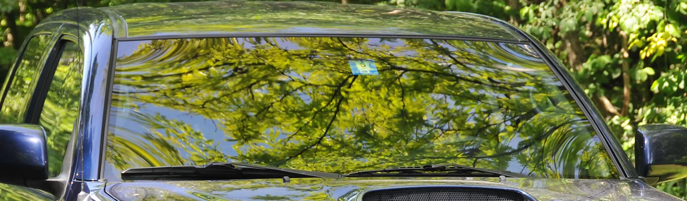

You might recall my saga that began exactly a year ago when I had a replacement windshield installed that was so warped at the corners that the wipers would lose contact with the glass. The manufacturer's distributor claimed at the time that it was "in spec" and refused to do anything about it. The glass shop showed a lot of integrity however and they replaced it three times. Then when the third one exhibited the same problems (slightly better than the previous two but still not good) they replaced it a fourth time at their own expense with a genuine OEM windshield from Toyota that is flawless. The aftermarket for replacement windshields appears to be flooded with inferior quality goods from China these days.
My photographs shot in my driveway clearly showed the warped glass which was difficult to see at the glass shop without the canopy of trees overhead.
These cheap windshields had a second issue that I was unable to document. At night, with car headlights coming through the glass from vehicles in the oncoming lane there would be a subtle but noticeable distortion like a diffused speckle pattern that was rather distracting. On longer night time trips it would cause eye fatigue and was very annoying. At first it was difficult to tell if this was a legitimate problem or not because it was very reminiscent of the badly pockmarked windshield I had just replaced but the OEM Toyota glass I finally ended up with is optically clear.
So, yes the quality of glass in one's windshield does indeed affect the image quality of dash cam videos.
The distortion is really obvious when you see reflections like that! You don't see that on new cars in the showroom.
And you don't see it on any other cars out on the highway either as I intially tried to explain to the glass shop. When this first happened I spent a lot of time checking out other cars to see if I could find another that had a windscreen like mine but never did. Without the photos I would not have been able to get the glass replaced each time. Of course, there was the business of the wiper blades losing contact with the glass at the corners too but I was able to demonstrate that down at the glass shop.
actually it was the first thing that came to mind when I noticed it, I'm used to seeing poor quality aftermarket glass, was surprised to see how bad a brand new OEM one was though
indeed
I don't see how it could not affect it in some cases, some of them are very poor quality
indeed
Several years ago I replaced the sliding glass door that opens onto my deck. The old doors had glass that was perfectly flat and clear, so much so that at night you could see yourself perfectly in it like a black mirror. I recall my ex-wife used to check her outfit in the "black mirror" just before we'd step out for a night on the town. The new door, which was rather expensive and of high quality has glass that is noticeably distorted, so much so that you can't really even see yourself in it. It's just the way things are these days.
