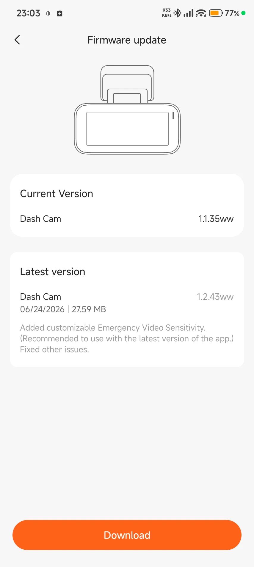

Firmware: v1.1.35ww. The firmware version loaded from the factory onto the device was v1.0.29ww, and during the testing period I received only the one update to take the device to it's current state of v1.1.35ww.
App for testing: Android version v4.0.1, obtained from Google Play Store.
