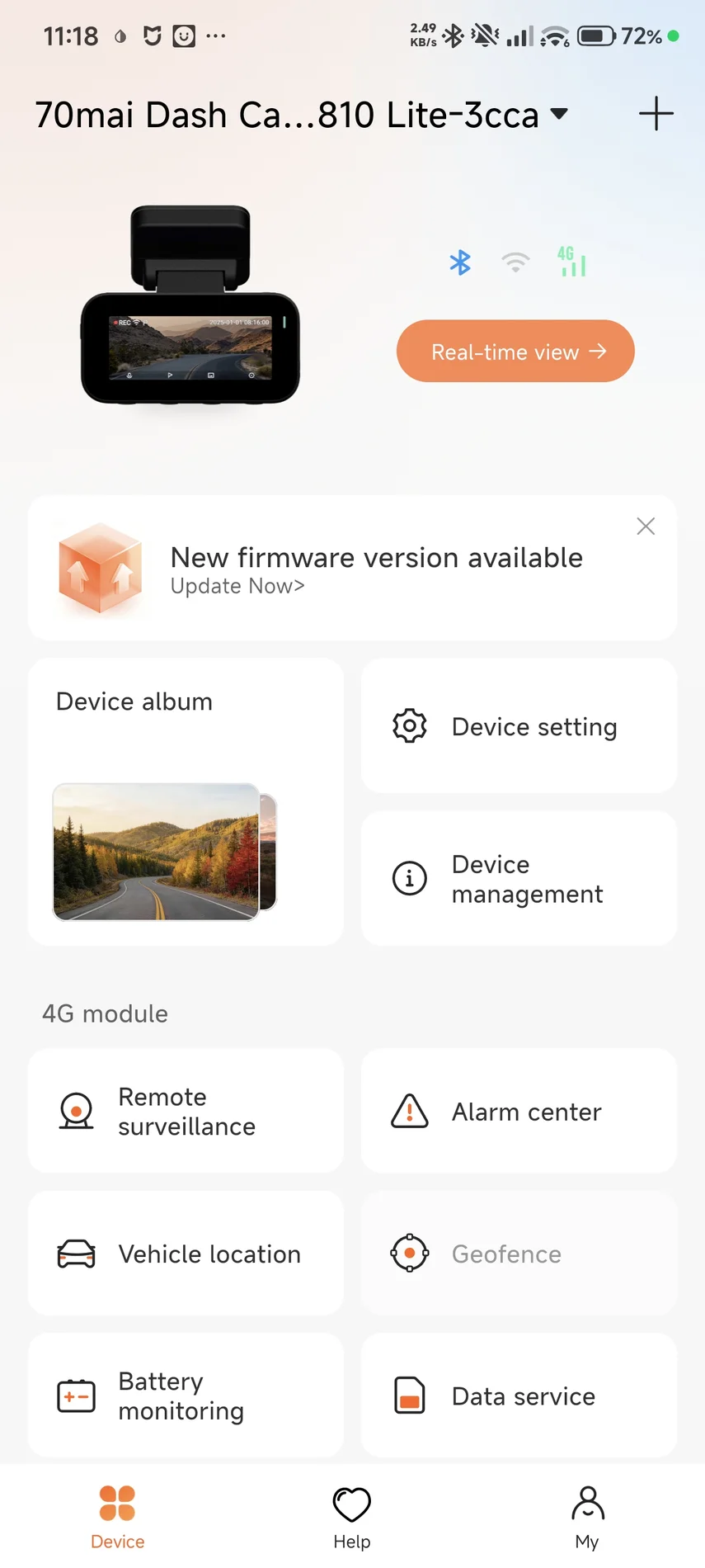

Upon connecting the APP to the 70mai 4K A810 Lite, there was one firmware update prompted to be installed. The prompted version was to firmware version v1.1.35ww and I expect there to once again be a raft of firmware updates to both smooth and improve the 4K A810 Lite.
This initial firmware update included the following improvements:
- optimise image quality in complex scenarios
- optimise the display status of the French section settings
- fixed other known issues

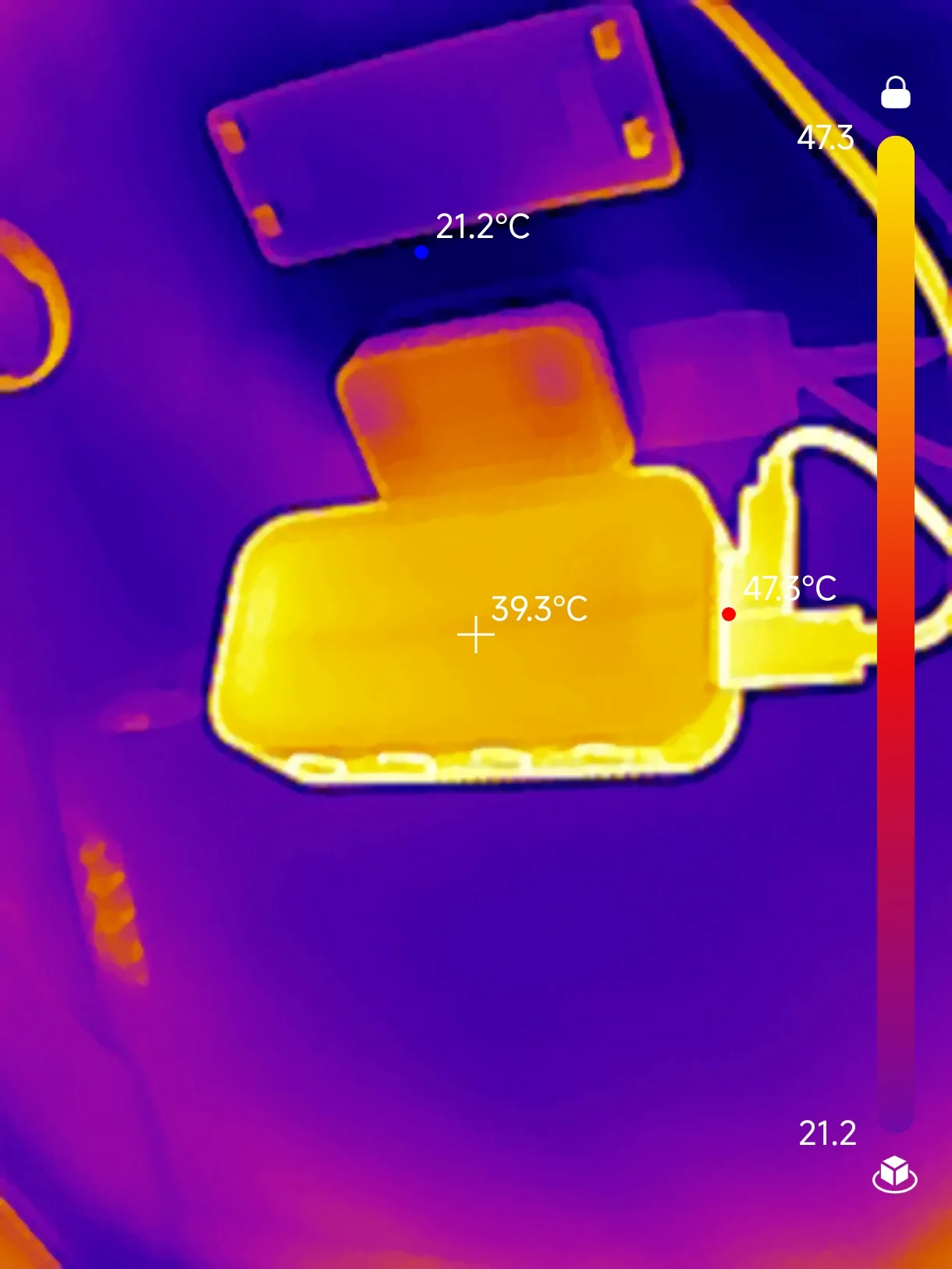

The 70mai 4K A810 Lite on show here is recording at its highest native resolution of 4K, 24 frames per second in two-channel configuration. Unfortunately as it is winter here in Australia, I can only provide operating temperature figures in temperate conditions. Please keep this in mind, as this gives more of a rough idea about temperatures than anything subjected to extremes. Firmware version: 1.1.35ww. Tested with it's respective stock power supply.
In all instances, the ambient car cabin temperatures (with air-conditioning and fans turned off) is 11.5 degrees Celsius. 70mai 4K A810 Lite installed to left of rear-view mirror
28th May 2026:
Scenario: parked in stationary car mid-afternoon for approximately 30 minutes directly facing sun
Exhibited behaviour: 70mai 4K A810 Lite did not shut-down
Outside stated weather bureau temperature: 14.3 degrees Celsius
Dashboard recorded temperature: 24.6 degrees Celsius
70mai 4K A810 Lite (directly at microSD slot location on left side): 53.8 degrees Celsius
70mai 4K A810 Lite (right-hand side at power and rear camera ports): 47.3 degrees Celsius
70mai 4K A810 Lite (LCD screen itself): 39.3 degrees Celsius
70mai 4K A810 Lite (underside of camera on ventilation grilles): 50.2 degrees Celsius
