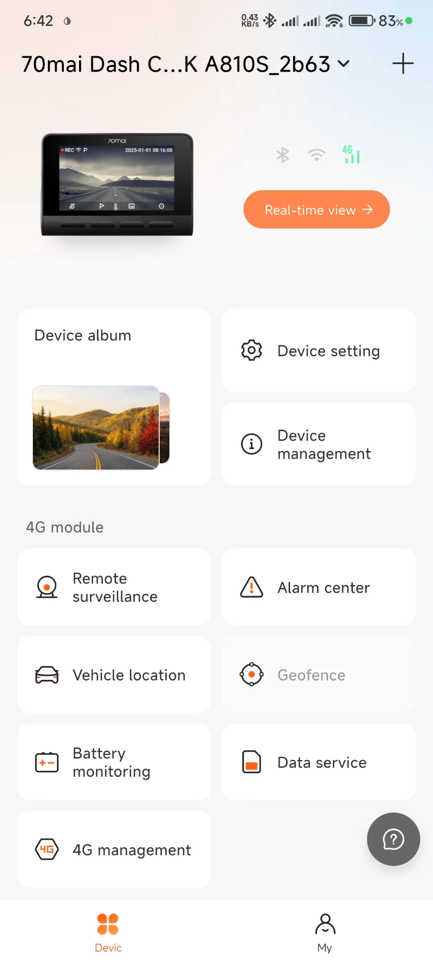

There has been some more updates to the 70mai APP in the Google Play Store:
The latest version is now 3.14.0 and brings the following improvements:
- Support for new device T400
- Support for message filtering and deletion in the Message Centre and Alert Centre
- Support for device model search when adding a device
- The minimum supported version of the app has been adjusted to Android 7.0
- Fixed some translation issues
- Fixed other known issues
The latest version is now 3.15.0 and brings the following improvements:
- Support for new device M310 Plus 4K and N500
- Redesign and optimisation of the device pages for some models
Pretty cool to see the redesign come too, functionally it's the same but a much cleaner layout.

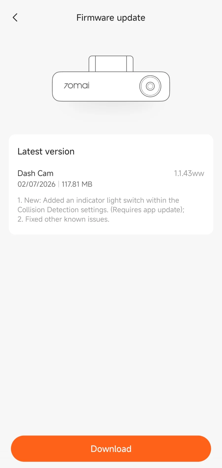

There has been a firmware update for the 70mai 4K M800, taking it from version 1.0.37.ww to 1.1.43.ww
Changelog:
- added an indicator light switch within the collision detection settings
- fixed other known issues
The latest version is now 4.00.0 and brings the following improvements:
- added Help Center feature
- support for new devices A800SE SpeedEye and A810 Lite
- continued redesign and optimisation of device pages
- relocated the entry for the "Me" section
- added guidance prompts when adding multiple dashcams (when the number of devices increases from one to two)
- fixed an issue where added devices did not display on the page for some phone models
- fixed some translation issues
The latest version is now 4.0.1 and brings the following improvements:
- redesigned and optimised device pages for some models
- added display of the server the user is located on
- added entry for customer service contact information
