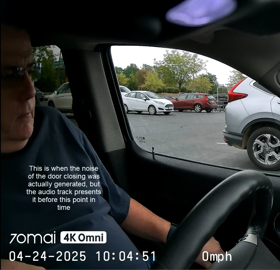

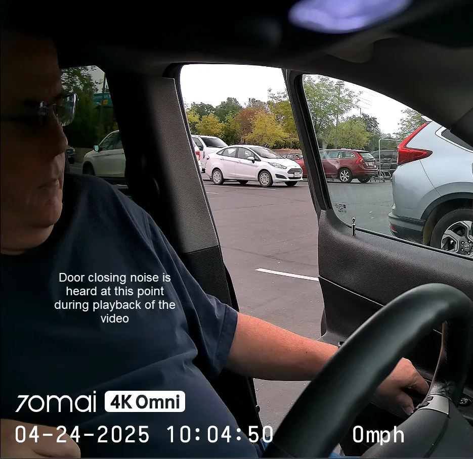

View attachment 79721 View attachment 79722
I found it also is out of sync in normal driving.
Do capture inside and once it is pointing in your direction
talk and you will see the video is out of sync.
