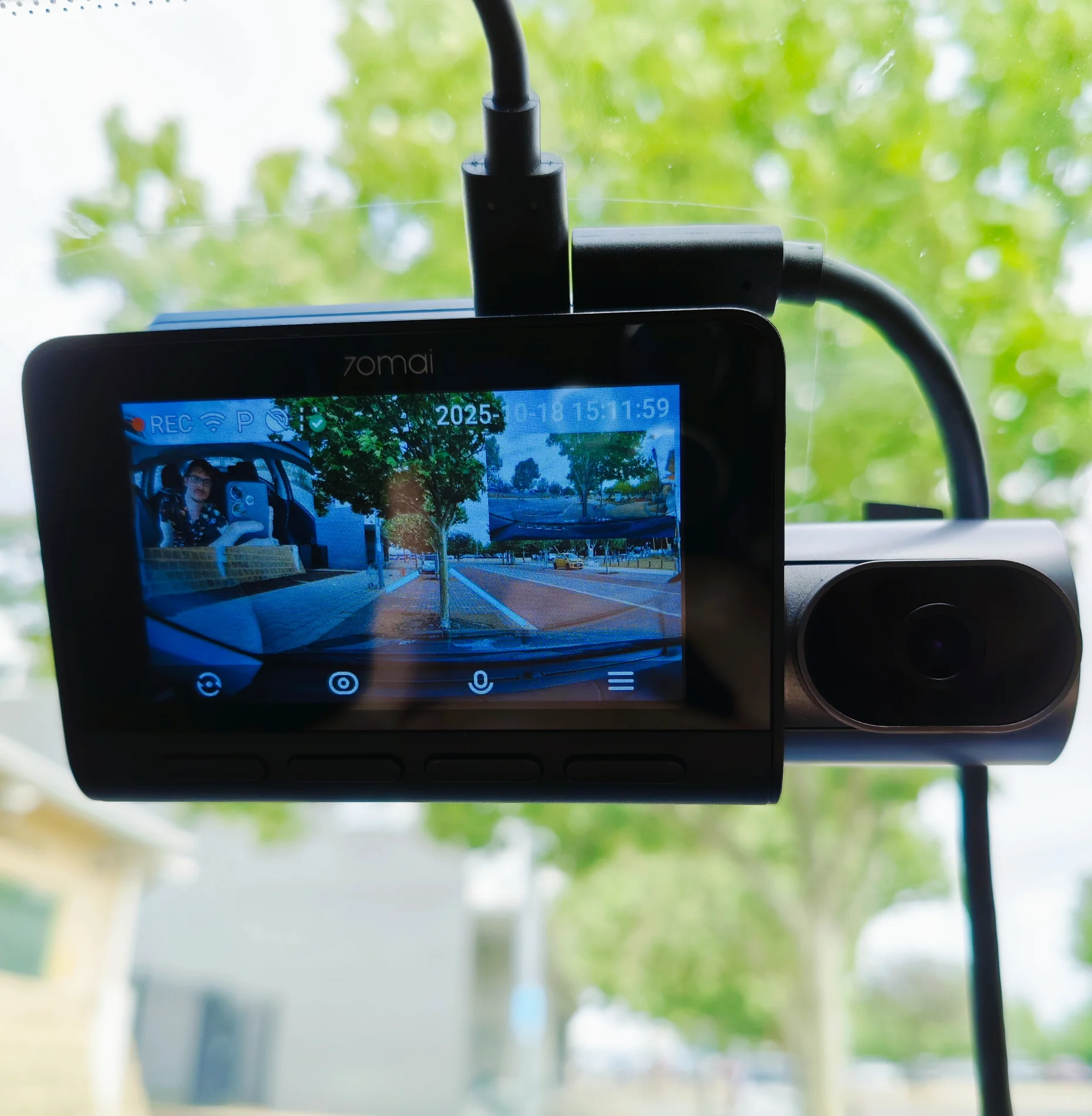

I have spent a number of months with 70mai's latest release, the 4K T800, to see what it is all about. Does 70mai have a hit on their hands with this, their first three-channel dashcam release? Read on to find out.
70mai 4K T800 (Sony Starvis 2 IMX678/IMX678/GC2093, Wi-Fi 6, 4K30 + HDR two channels/1080p HDR remaining channel)
Firmware: v1.2.136ww. The firmware version loaded from the factory onto the device was v1.0.115ww, and during the testing period I received several improvement, stability and bug-fix firmware updates of which I updated to in the latter part of testing.
App for testing: Android version v3.12.1, obtained from Google Play Store.
The verdict:
Having previously reviewed the 4K Omni from 70mai, I was somewhat hesitant going into reviewing this new dash camera. This was due to the motion tracking functions of said dash camera, which enabled it to remain my daily driver in my vehicle for the last six months. 70mai has managed to surpass all expectations with their 4K T800 release though, due to the addition of 4K video to the rear sensor (addressing one of my quibbles with the 4K Omni).
What has resulted is an overwhelmingly solid product in the T800. There is nothing quite liking being able to remote into your vehicle over 4G, and switch between three video feeds, two of which are in crisp 4K. If you value the best image quality for your vehicle's safety and surveillance, in a stealthy package, then look no further than the 70mai 4K T800. Pick one up now.

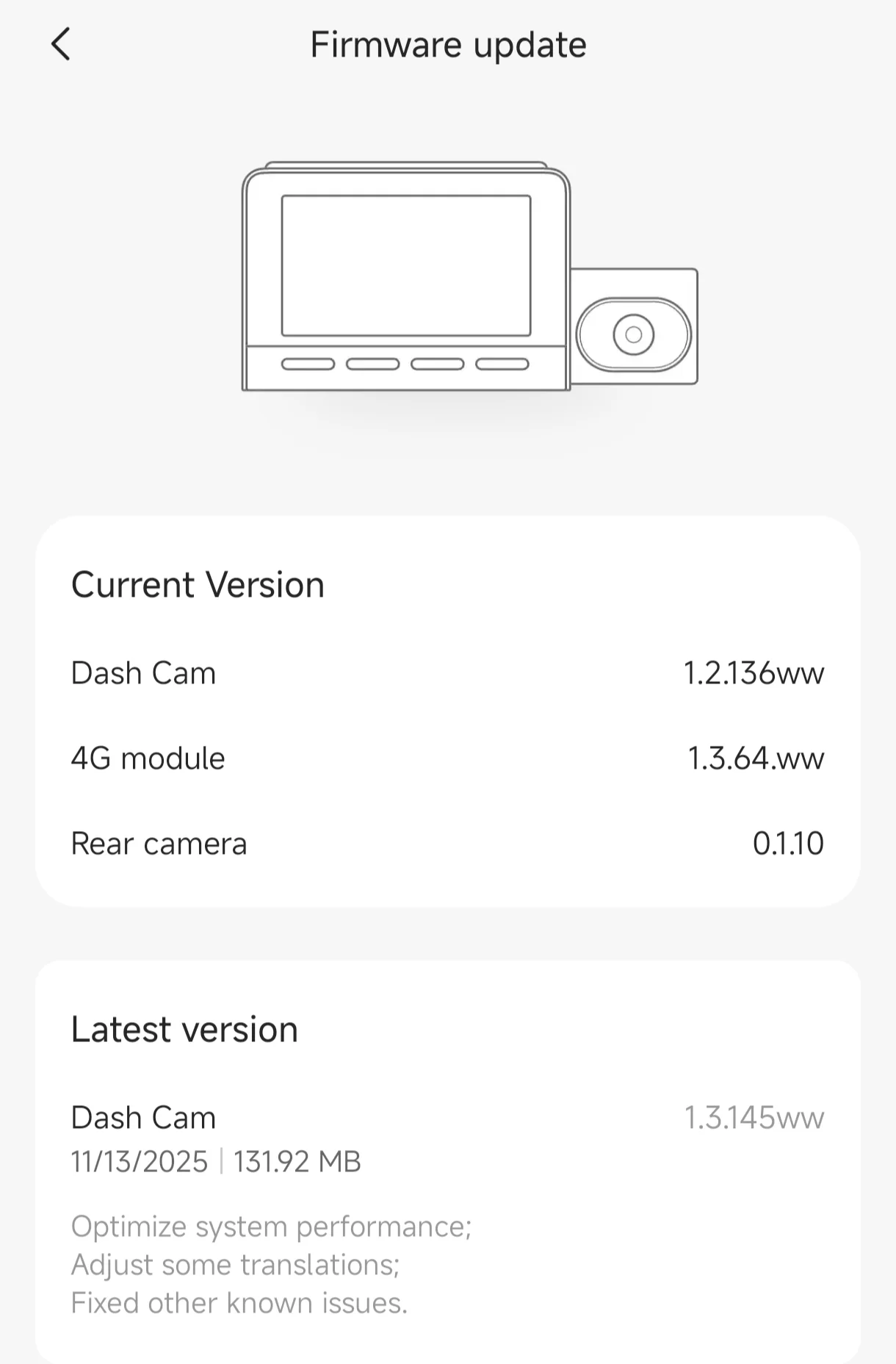

There has been a firmware update for the 70mai 4K T800, taking it from version 1.2.136ww to 1.3.145ww.
Changelog as follows:
- optimise system performance
- adjust some translations
- fixed other known issues

Detailed changelog has now been published for the latest 1.3.145ww firmware update for the 70mai 4K T800:
- fixed the issue of frequent SD card formatting prompts
- changed the Arabic device name in the overseas version to 70mai Dash Cam 4K T800
- changed the Italian and Filipino device names
- added logic for deleting small streams upon power-on scanning. Fixed the issue of small streams not being deleted in a loop
- fixed the issue of the first frame of time-lapse and parking monitoring appearing bluish or yellowish
- fixed other issues that could be reproduced during testing
just did the update.
There was also a bug where when using Remote Surveillance and viewing the rear camera, it would show as Loading (unless you went into a settings menu and then went back, and then it would show the live feed).
This update fixes that bug too.

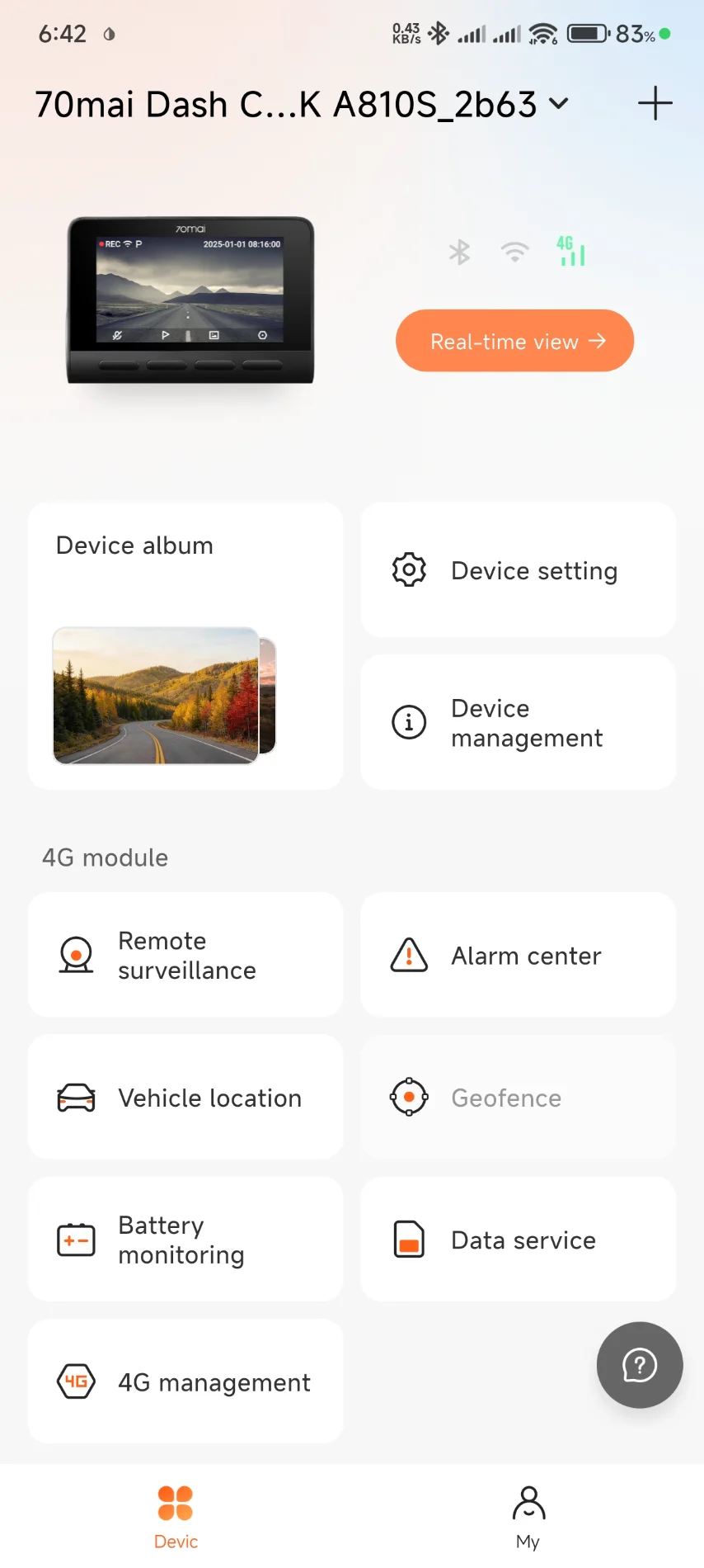

There has been some more updates to the 70mai APP in the Google Play Store:
The latest version is now 3.14.0 and brings the following improvements:
- Support for new device T400
- Support for message filtering and deletion in the Message Centre and Alert Centre
- Support for device model search when adding a device
- The minimum supported version of the app has been adjusted to Android 7.0
- Fixed some translation issues
- Fixed other known issues

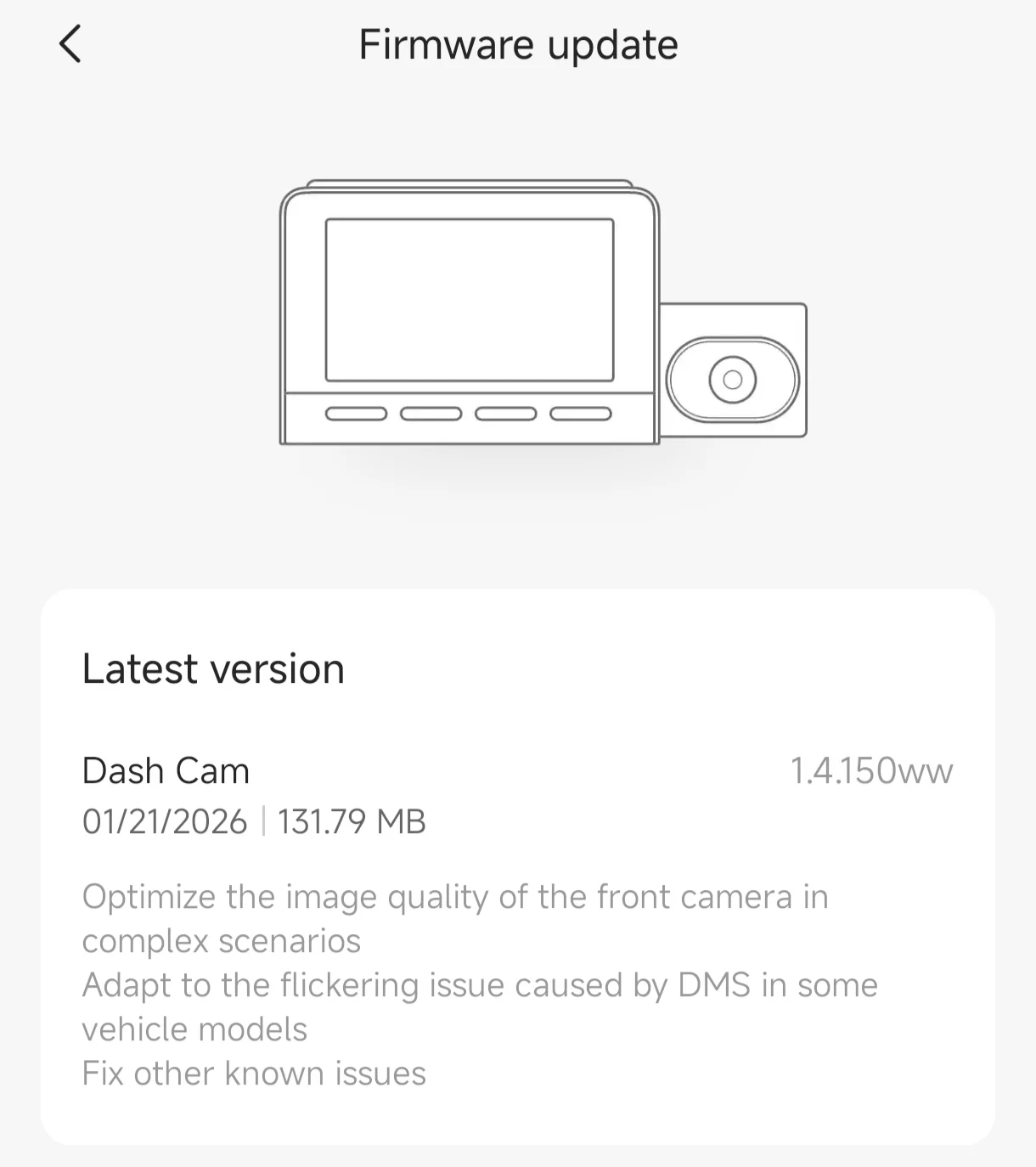

There has been a firmware update for the 70mai 4K T800, taking it from version 1.3.145ww to 1.4.150ww.
- optimise the image quality of the front camera in complex scenarios
- optimised SD card compatibility and implemented a new SD card logic
- adapt to the flickering issue caused by DMS in some vehicle models
- fixed the issue where ACC jitter would trigger parking mode while driving
- fixed the missing indicator light issue when setting collision detection and motion detection directly via APP Bluetooth
