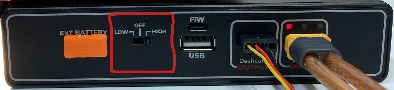

Before we get started I would like to discuss how the BBMC PowerCell 8, and BlackVue B-130X are user configured for Low & High Amperage charging.
Low Amperage: CLA
High Amperage: Hardwire
The BBMC PowerCell 8 uses a three position switch to configure the BMS (battery management system) LOW - OFF - HIGH

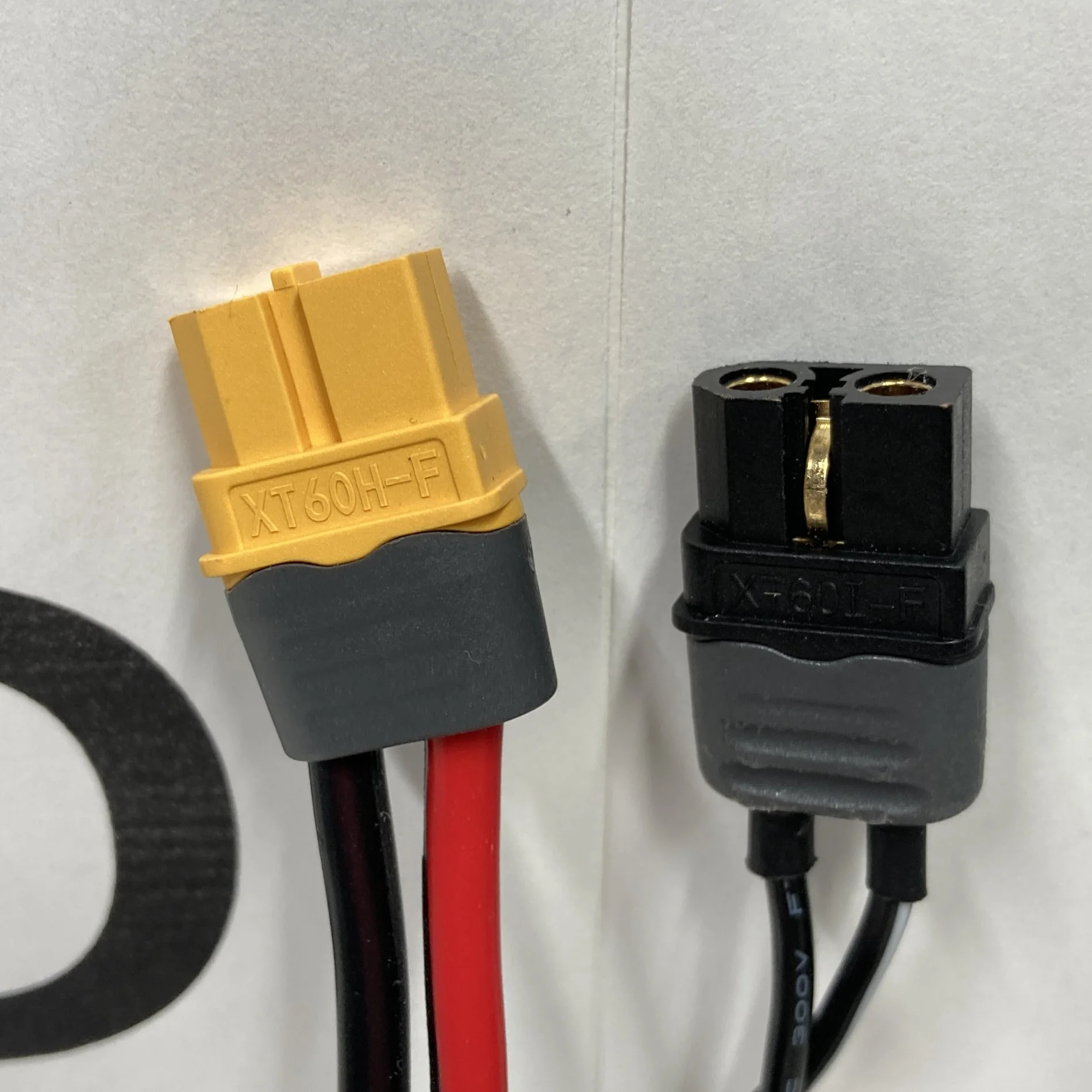

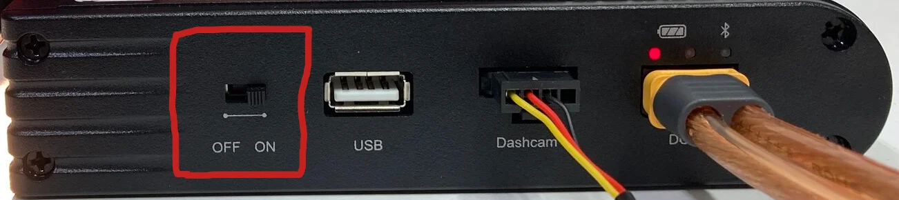

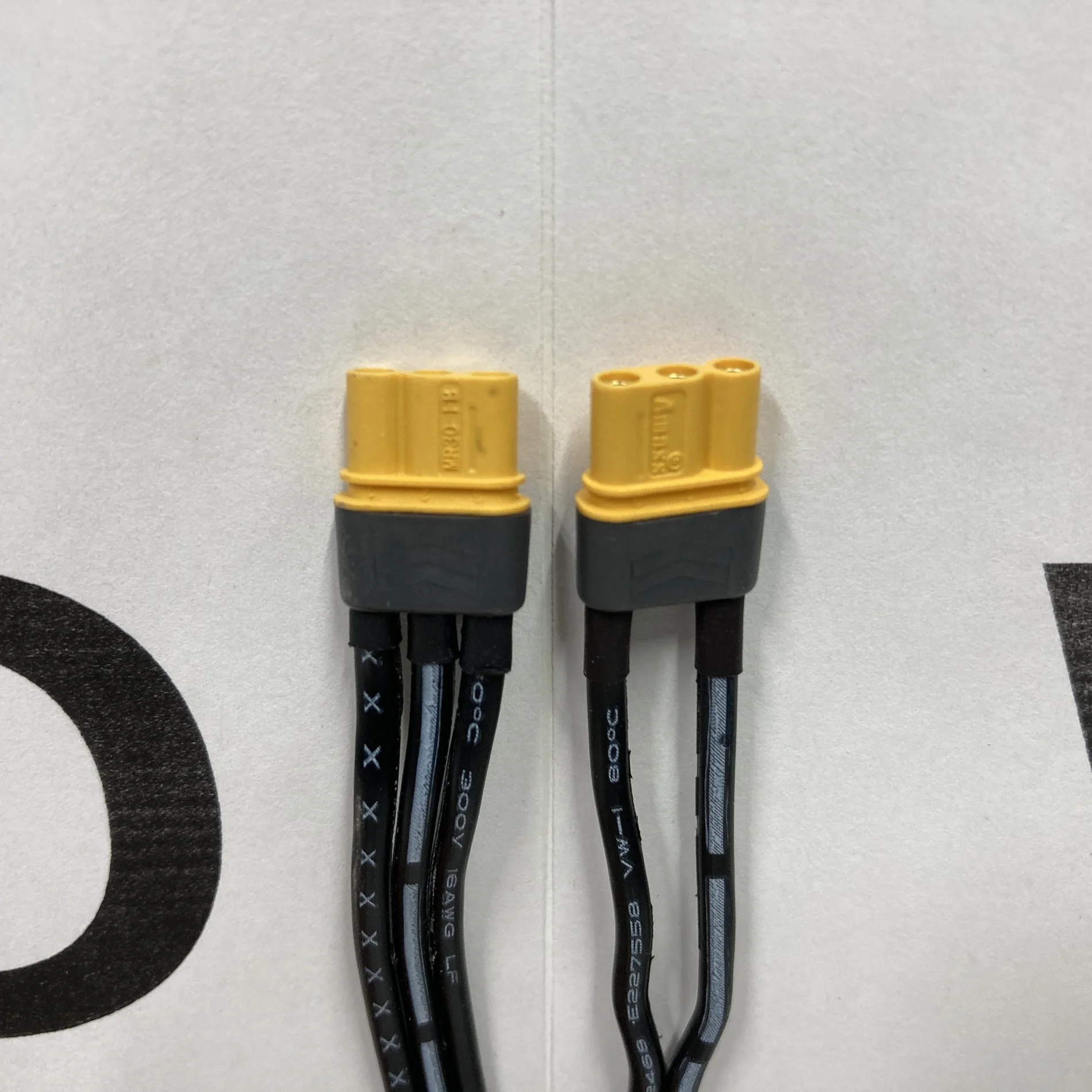

The BlackVue B-130X does not use a switch to configure Low & High Amperage charging.
It uses a 3-Pin XT60 connector.
The 3rd pin provides an additional ground.
When the B-130X receives ground on the 3rd pin it tells the BMS the CLA is in operation, and to lower charging amperage.

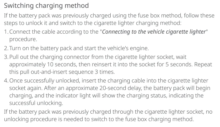

Here’s where things get a little ****amaimie.
The 70mai battery pack does not use a switch, or a 3-Pin connector on the CLA to configure the BMS for Low Amperage charging.
Page 5 of the user manual describes an “unlocking” procedure to configure the pack for Low Amperage charging that is a combination of the Hokey Pokey, and the Konami Code, (up up down down left right left right B A select start).
Performing this procedure is doable for folks like us that actually read user manuals.
For the average consumer performing this procedure is going to be problematic to say the least.
I can already see the tech support inquiries now.

So with a brand new battery pack purchased with the cla, that hokey pokey shouldnt be needed, correct? My fuse box is next to the battery and not inside the vehicle so its a bit easier for me to us the CLA plus I drive alot daily. Did you notice if the CLA connection has the delayed charging when you first apply power to it? I have a blackvue Im thinking of connecting to it once I receive the battery pack.
If the pack is in fuse box mode (high amperage), and the CLA is connected the pack will not charge, because there is to ACC trigger to begin the charge cycle.
Yes, I saw that,
Nevertheless, I don't understand why they choose such an inconvenient process?
Especially when they had 2 different and both better options implemented in competing batteries.
