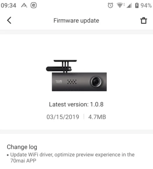

Just cut first 32 bytes from factory sdcardv.bin file with a hex editor (eg. HxD). It should start with MCR2 instead of AITS. Flash that to eeprom.
Hello everyone. I find myself the same problem, you could indicate the chip to be reprogrammed.
