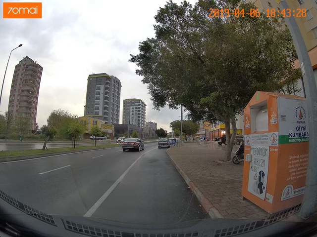

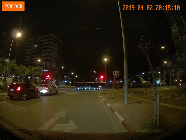

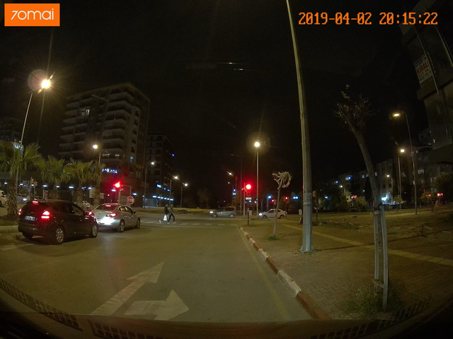

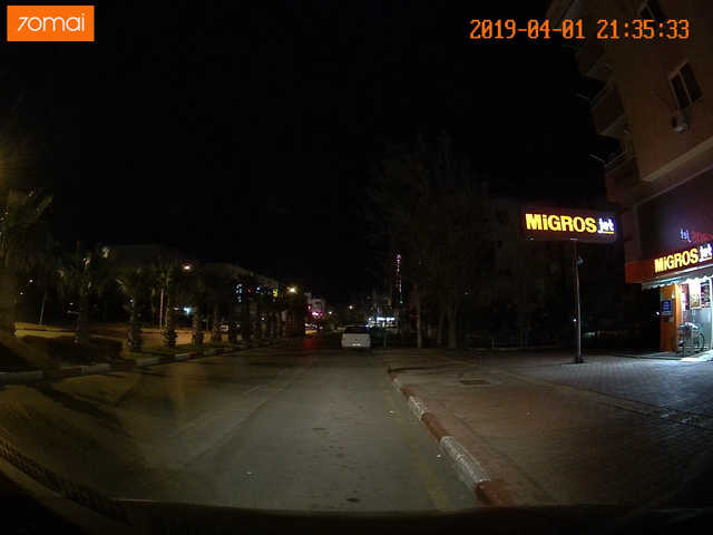

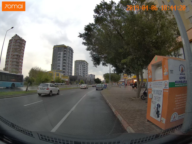

it looks better and more detailed with the custom firmware
nice job mate...
will you release that custom firmware?

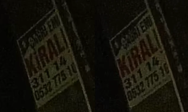

Seems a bit brighter and less sharpened. Is number plate capture improved?
