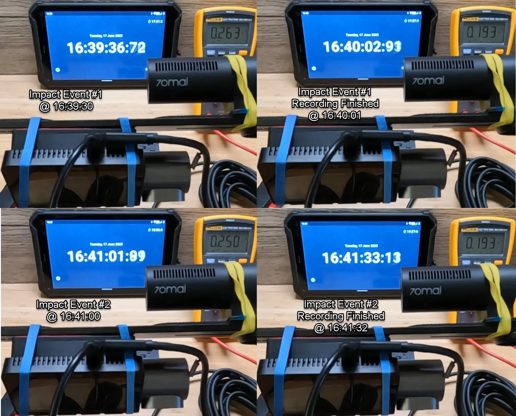

I ran a collision detection sentinel mode test after defaulting the T800 settings and formatting the microSD card. The only sentinel mode enabled was collision detection and the only camera recording during sentinel mode was the front camera. The rear camera was connected to the front camera. A UP03 is providing power to this T800.
Screenshots of the various configuration steps:
The power consumption, after turning off the "ACC" power at 16:29:00, did not change for a 10-minute period. The amp draw ranged from 343 mA to 355 mA @ 12.6V. This elevated power draw only occurs while the T800 is waiting for the first impact event after entering collision detection sentinel mode.
The first impact event occurred at 16:39:30 and within a few seconds the power draw dropped to the 260 mA range. When the first impact event recording finished at 16:40:02 the power draw dropped to 193 mA.
A second impact event occurred at 16:41:00. The power draw increased for 30 seconds while it was recording. The power draw dropped to 193 mA again after the recording was finished.

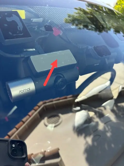

I received confirmation that 70mai is changing the double-sided adhesive pad color from the light grey to black.
The T800 dash cameras sent to reviewers still had the grey adhesive pads, but the production units will have the black adhesive pads. The black adhesive pads will start showing up in future batches of the X800/M800.

Yes gradual transition they said. Should already been in production batches, as they confirmed this a couple of months ago
Yeah...that grey is quite visible, sort of an eyesore to be honest. But, the end of the camera unit itself has that silver coloured plastic. Though that does look better than the grey adhesive pad.

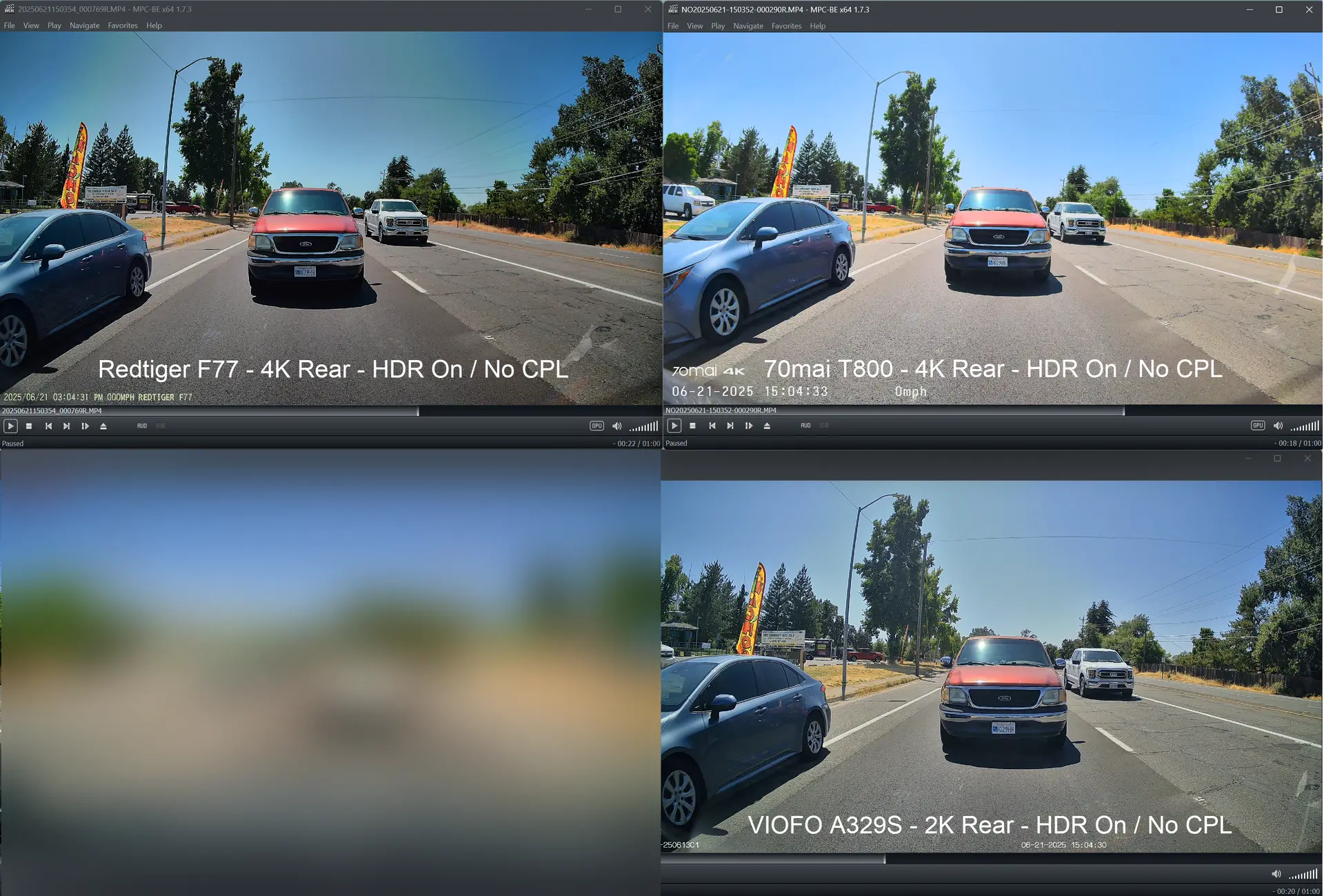

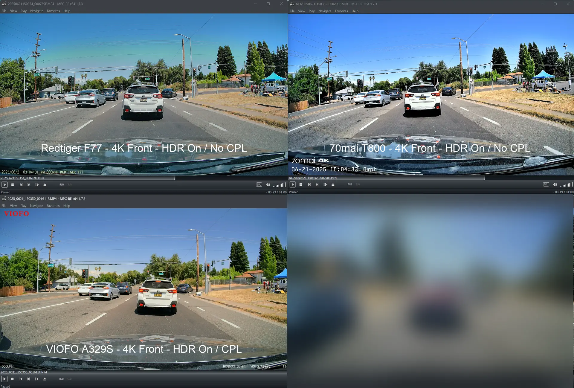

Today, I was driving to/from a lunch meeting with the 70mai T800, VIOFO A329S and Redtiger F77 dash cameras in my car. This was a shakedown run for this set of cameras installed in their current positions in this car. This car's windshield has a noticeable curve within a small distance offset from the center of the windshield. I adjusted the 70mai T800 front camera placement on the windshield after I arrived home. I lifted the right side of the T800 front camera a bit. Since the T800's interior camera is part of the front camera, that limits where I can place the camera without blocking the interior camera's view of the passenger compartment and so it does not block my line of sight while driving.
The A329S was writing the front/rear video into a multiplexed video file. That is why I blurred out the side of the screenshot that did not apply to that front/rear example. The 70mai T800 and Redtiger F77 do not have an OEM CPL filter available for the front camera.
Because the T800 3CH video resolution options all have HDR enabled, I made sure to enable HDR for all dash cameras in the car. More day and night driving will be done over the next couple of weeks.
Looking forward to your review, but T800 is difficult to compare with 329, it is even inferior to 329's younger brother 229
Interesting. I was looking at both the 329o decide which to purchase. Being they both have the same sensor, I was leaning towards the cheaper T800. Thoughts?
