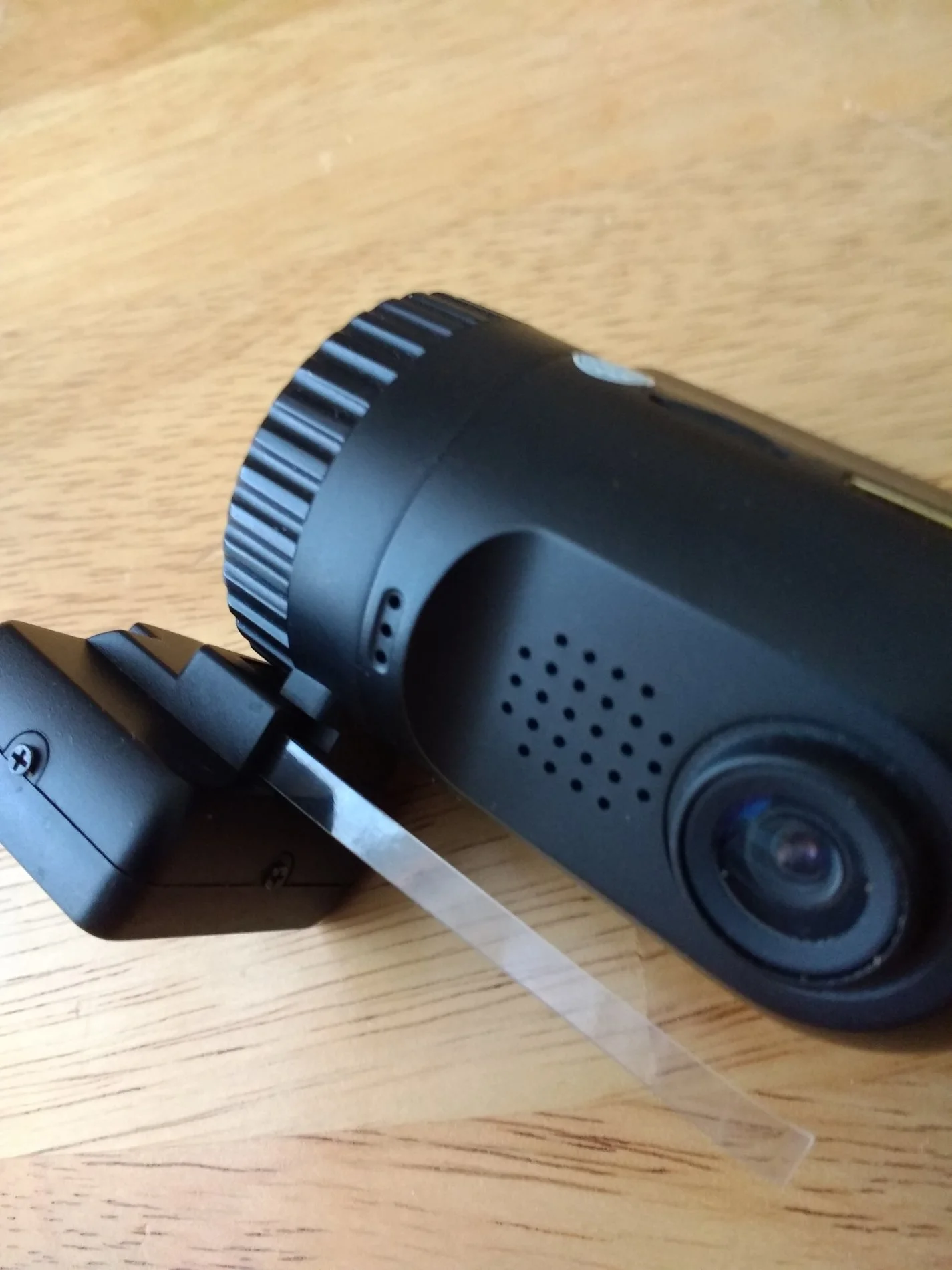

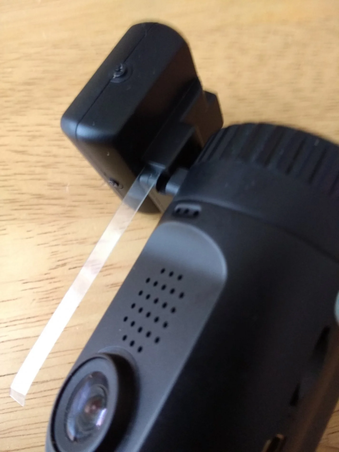

My 5 year old e-prance 803 dashcam was becoming a bit loose in the mount. I overcame this with a quick fix by using a strip of thin plastic cut from a food container. By placing the strip of plastic against one side of the inside the mount and then pushing in the dashcam I solved the problem, the dashcam is now held firmly in position. I no longer remove the dashcam from the mount if I want to review the video footage on my laptop I just remove the micro sd card from its slot.
