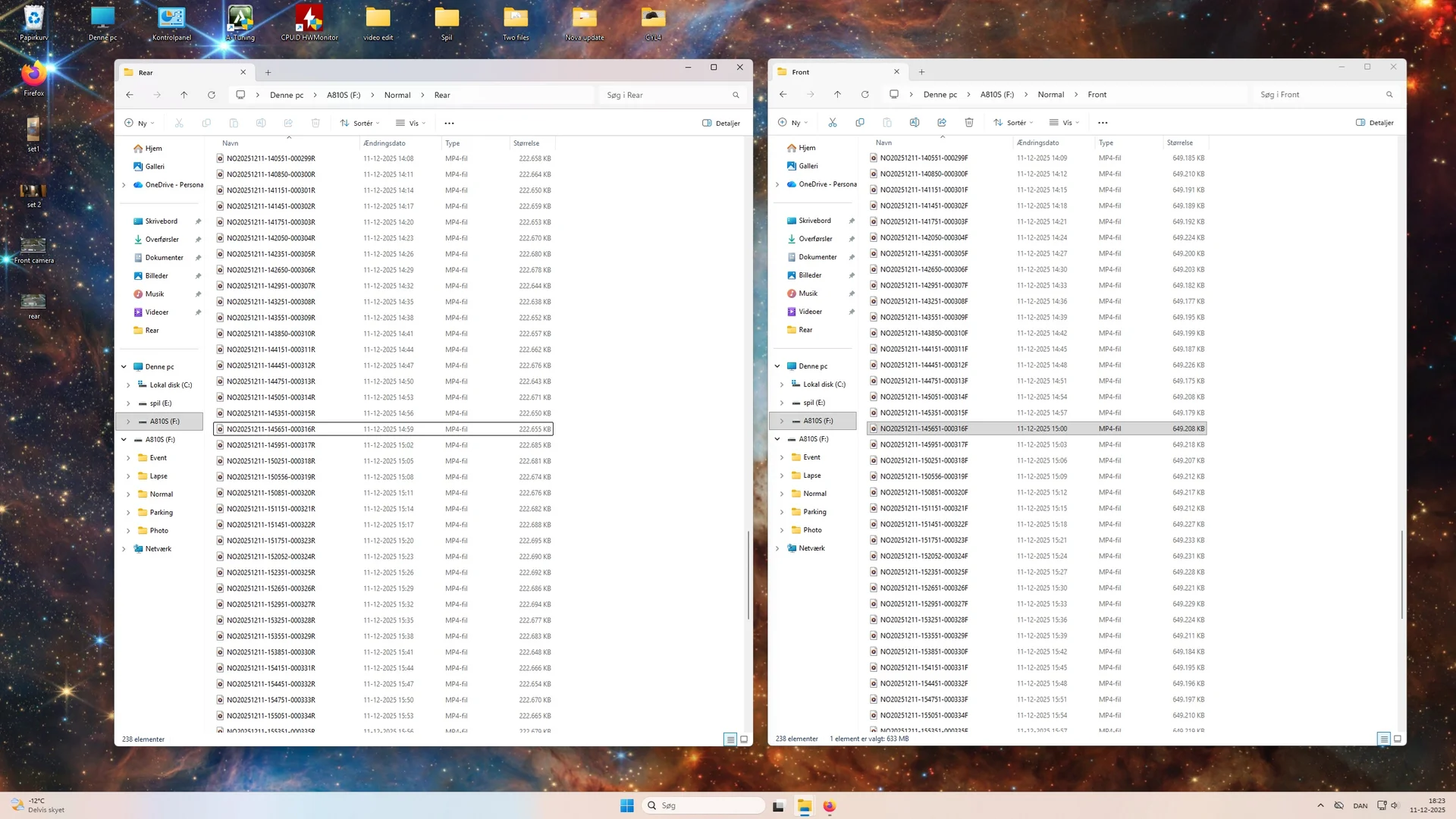

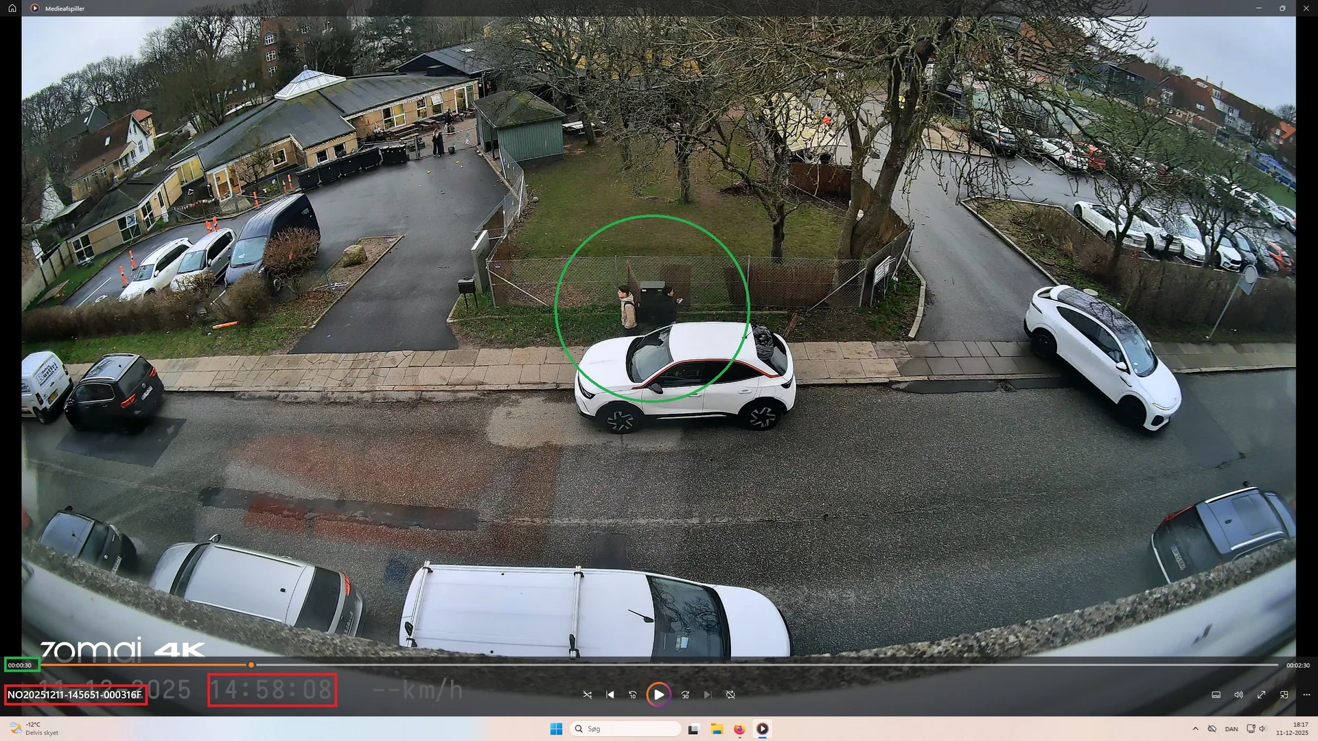

Okay i have found something fishy.
I wanted to grab 2 files ( F/R pair ) to make a daytime video of the night time above.
So i scrolled down thru front camera footage and grabbed one created 11-12-2025 15:00, but the problem is there is no corresponding rear file created 11-12-15:00 there seen to be a time skew.
Looking at footage from the front footage the 2 pedestrians meet at the time 14:58:08 and this is 30 seconds into the front camera file.
But the same for the rear camera footage is 1 minute 17 seconds into the rear file.
File structure with the 2 used files highlighted.
Screen shot from the 1 videos, framed time stamp - file name and playtime in the file + the meeting of 2 persons for reference.
The file names do seem to be same F/R but there is the skew in the time and so the creation names are different, i have always gone by creation time when i look at footage
