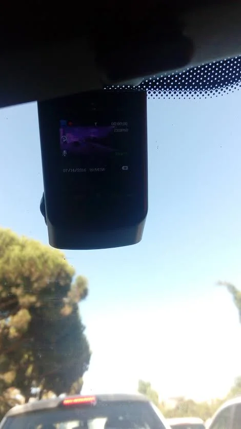

I had same problem, my cam only works well the first 3 days, it had the last firmware version, and I had it hardwired with this: http://cgi.ebay.es/ws/eBayISAPI.dll?ViewItemVersion&item=141776229747&view=all&tid=1265078022004
After 3 days at 35C of exterior temperature (inside 43C) the cam stuck in logo viofo, if I reset sometines seems to work fine, but at 10-15 minutes stops suddenly and corrupt the file or the display is in purple colour and no rec.
If I test the cam at house, the problem seems the same.
I buy it at gearbest, I had a bad unit???? I was very happy when I see the first 1080p video.... but 3 days and is dead, any idea of what can I do with gearbest ? I dont want to resend to China...
can't see what hardwire kit you are using, (link doesn't work) but from your photo it looks like you have motion detect turned on, if you've had it running on 35°c days your inside temperatures would be closer to 70°c in a car parked in the sun, that would kill the camera very quickly if you have had it running in those sorts of conditions
the cam is inside the car at high temperatures, but powered off !!! I only use the cam when the car is with airconditionated on.
