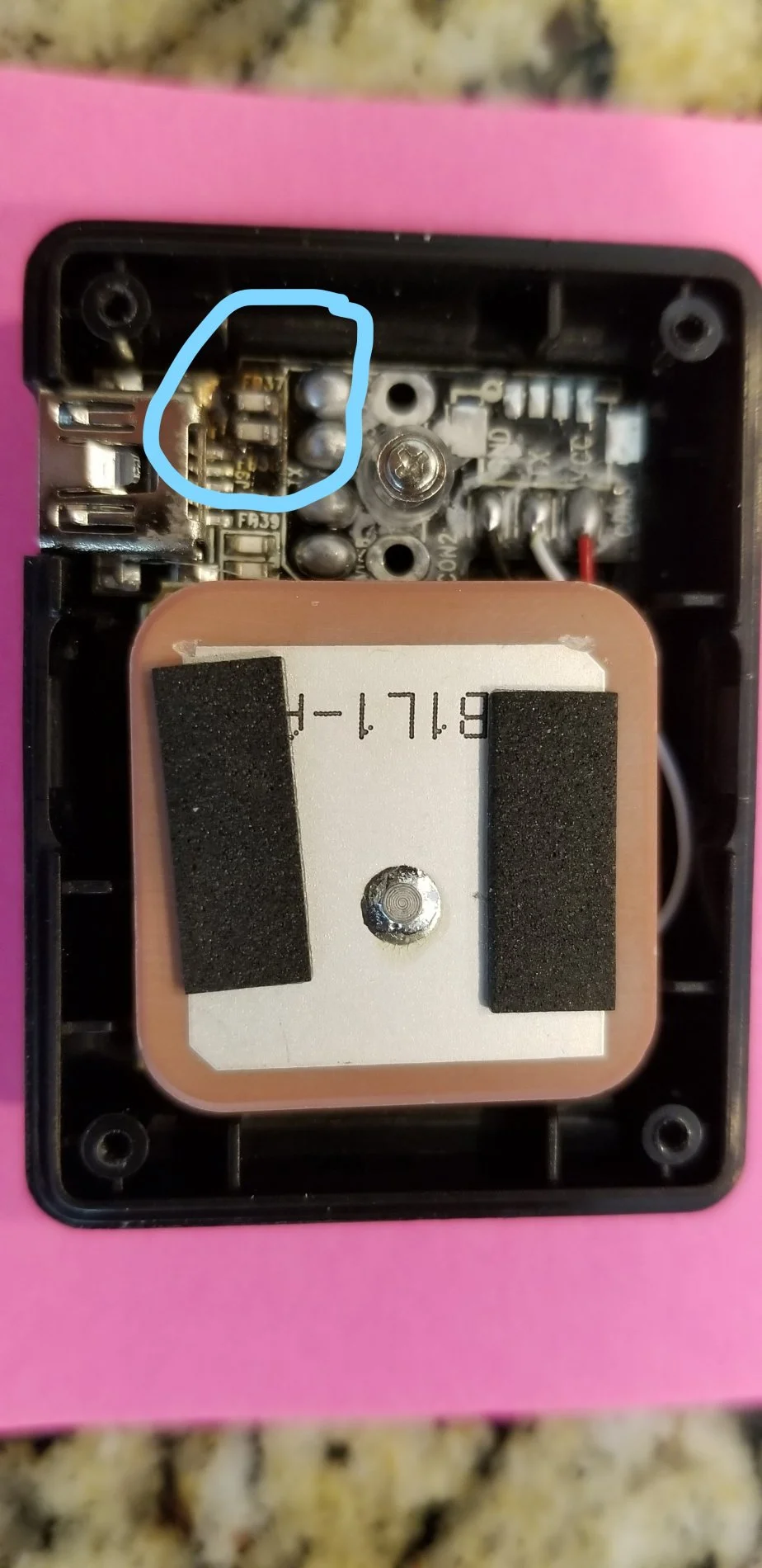

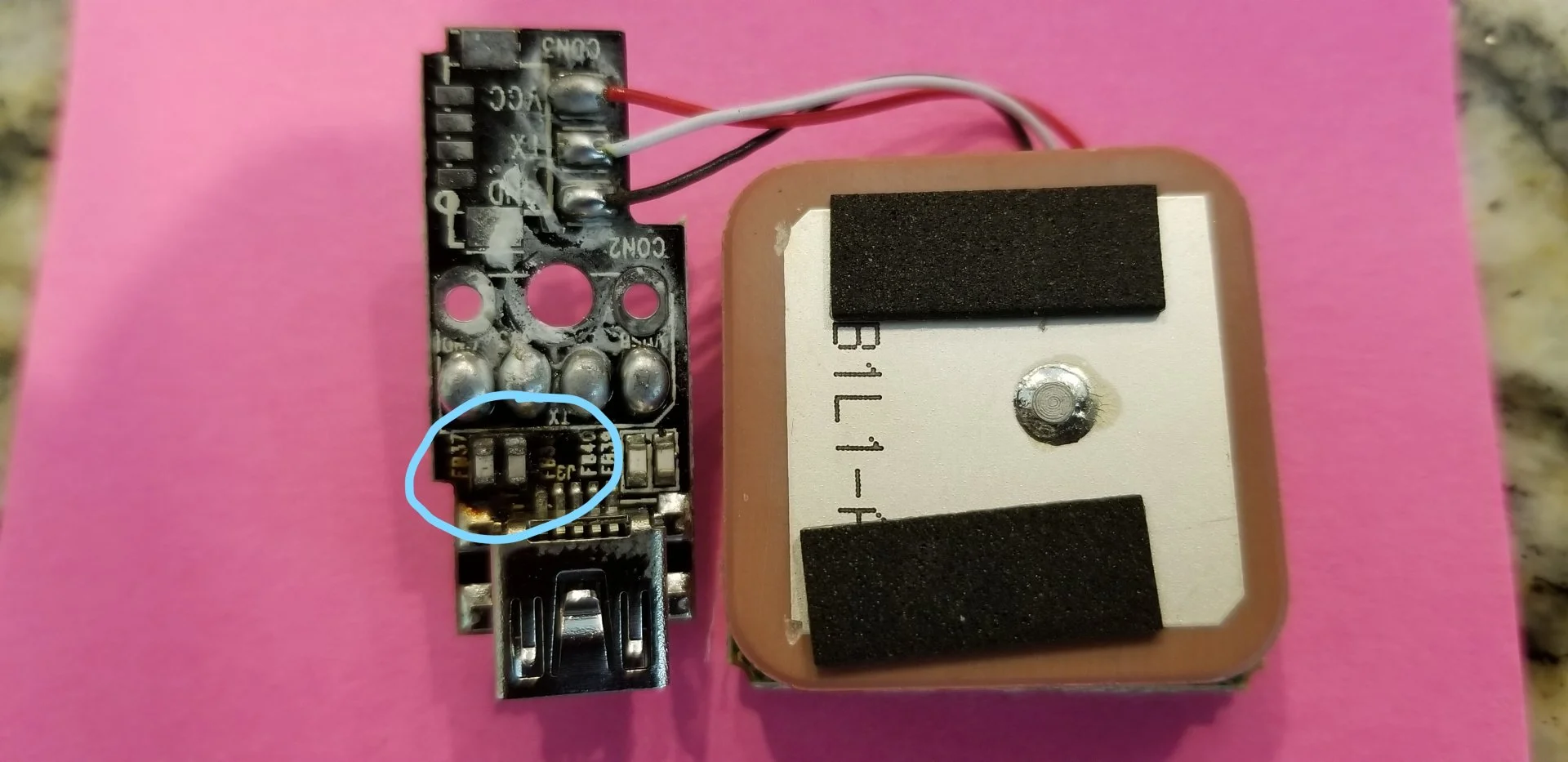

when I had power problems and constant restarts I opened the GPS module and I found the problem. There was a trace and a couple resistor bridges overheating and already charred part of the board where they are mounted.
