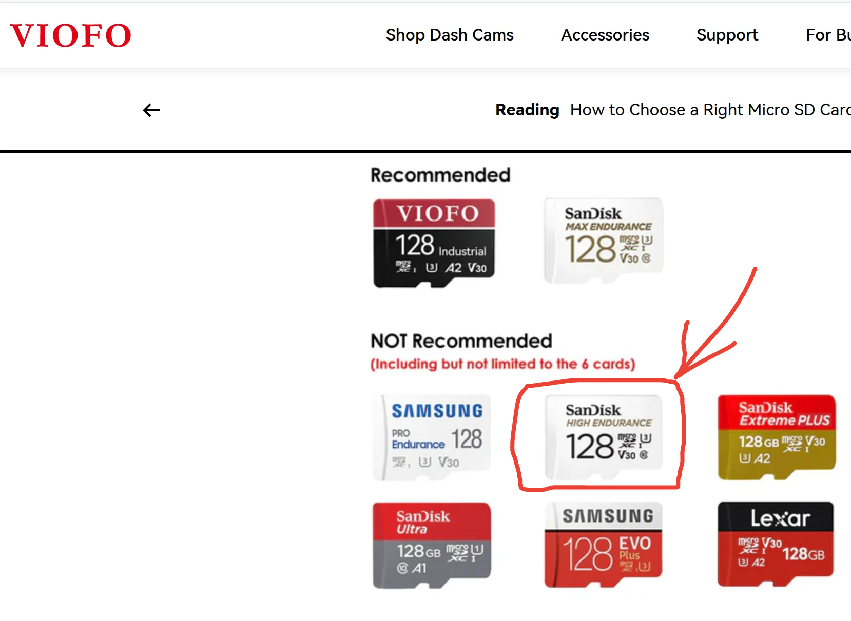

Welcome to the club @Sam_G
Sorry you’re having trouble.
Sandisk High Endurance is not recommended by VIOFO.
VIOFO RECOMMENDED SD CARD
VIOFO “always” recommends powering camera from GPS mount while installed, (see attached screenshot).
The good news is your A119 Mini 2 has a Two Year Warranty, (6 month extension with registration).
You may want to SUBMIT A TICKET to start a warranty claim.

Before I spend another ~$100 on a new SD card I'd like to be more confident it is going to solve the issue.
Amazon Prime Day, Amazon Black Friday, and Offical VIOFO website have sales on VIOFO Brand SD Cards.
The best deal I've ever seen was 50% when you buy 2.
These days you'll be making money with that discount 🤣
