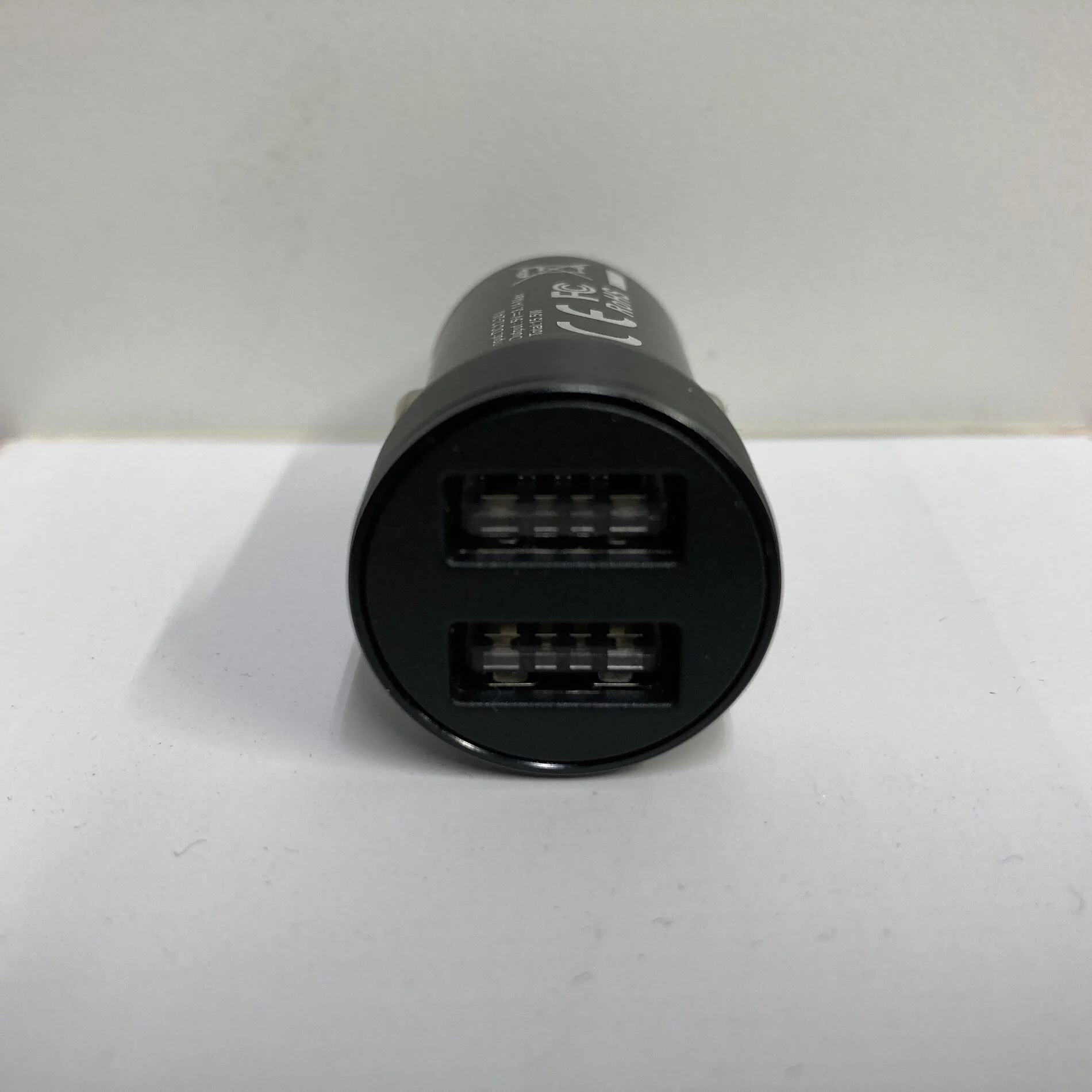

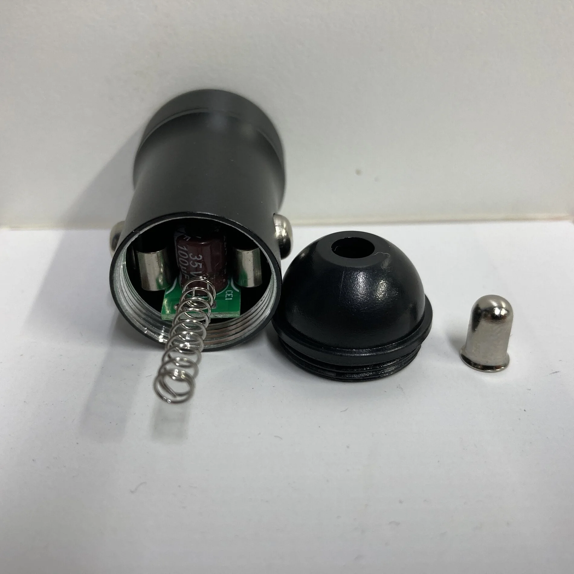

Panzer Platform, can you tell me if the cigarette lighter charger that comes with the mini 2 is fused or not? I assume it is, but didn’t see anything that confirmed this on Viofo’s website.
Here's some photos of it.
It doesn't look like there is a fuse in it.

... if the cigarette lighter charger that comes with the mini 2 is fused or not? I assume it is, but didn’t see anything that confirmed this on Viofo’s website.
For such adapters, a fuse is not needed and it is never installed, because there is current protection in the converter module from 12V to 5V and if the load is exceeded above the permissible value, the module simply goes into protection and turns off the output voltage.
PS: fuses are placed in the cigarette lighter splitters, because there are just wires and contacts and there are no electronic elements,
and you can connect a compressor, a vacuum cleaner, etc. there. and if the device consumes more than 10A (or another value set by the manufacturer), the fuse blows.
