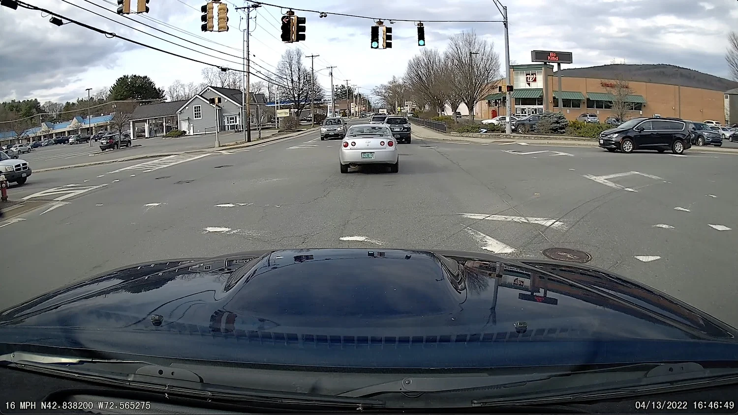

If you do not need the sky, because you are not recording meteors, and do not need the front of your car and part of your dash in the image, because they never change and there is nothing interesting there anyway,
You often make this comment, Nigel but I have to disagree with you.
For many dash cam users the "sky" can often include many important mundane details other than "meteors" and so it can be worthwhile to include the "sky" in your video. It depends entirely what happens to be within your field of view at any given moment. Objects that appears in the "sky" may actually be much closer. For example, you may need to document that an overhead traffic light was green as you enter an intersection, or perhaps capture a bridge or overpass you are traveling towards or under. One time, I captured a bunch of kids who were throwing rocks off of an overpass onto the interstate highway below and damaging car windshields. My dash cam video helped the police identify the culprits.
I know from your older posts that you disdain including the hood or front of your car in your dash cam videos. Here I disagree as well. If I were in an accident I would want to capture the point of impact even if another car hit my fender from the side. This is also especially useful when parked as it provides better coverage of my vehicle and indeed is integral to the 360º coverage my four cameras provide all around my vehicle went parked.
When I got my new car I tried the 1080 option and for some reason it affected the EV sensor. The video was very dark. Opened it back out to 1440 and it brightened up again.
Don't know why, sounds illogical, but that's what happened.
My bottom line though is the same as DM, I find the extra detail useful, especially high mounted traffic lights.
2560x1080 resolution, without losing any traffic light detail from the image above:
...and that is with the horizon higher than recommended and more than enough car front to judge distances from. The lens could be pointed up a quite a lot, which would also remove some of the fisheye from the side roads and buildings caused by the camera looking downwards.

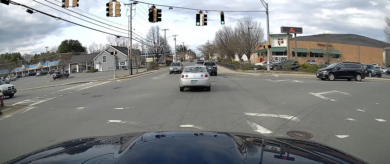

So, all you've done here Nigel, is crop off the bottom of my image leaving the sky in place while ignoring what I actually said. Obviously, a different resolution setting would not work like that even if I were to adjust the angle of the lens. And moving the goalposts and changing the subject always seems to be your standard style of argument.
I made it absolutely clear that my preference is to include the hood and front fenders of my vehicle in the image so that I have adequate coverage from the sides during an impact and that this approach is important to me because it works in concert with all four of my cameras to provide full 360º video coverage all around my vehicle with overlapping views from each lens. I also find it valuable to capture the "sky". The A119 V3 has a narrower angle of view than most other dash cams and this is yet another reason for my choice of resolution setting. Barrel distortion is minimal on this camera.
I never said my purpose for including the front of my vehicle was merely to "judge distances from" as you put it. (although including the front of your vehicle in the image does indeed do that). I do recall that we've previously had this same discussion and your preference as demonstrated in your screen shots at the time was to exclude all but the tiniest, barely visible portion of the front of your "bonnet" which to my mind is wholly inadequate. Most people would likely not take such an approach even if you happen to champion it.
Obviously, you are still clinging to your own overweening notions of trying to dictate what settings preferences others should chose for their cameras while at the same time side stepping your original supercilious remarks about "not recording meteors", etc.
Despite the fact that you find anything outside your personal frame of reference to be anathema to the point where you tell others what to do or not do Nigel, people should experiment with their camera settings, observe the results and then do what they find works best for their needs and preferences.

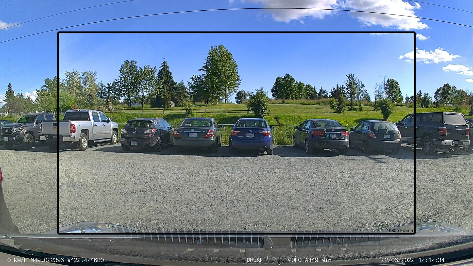

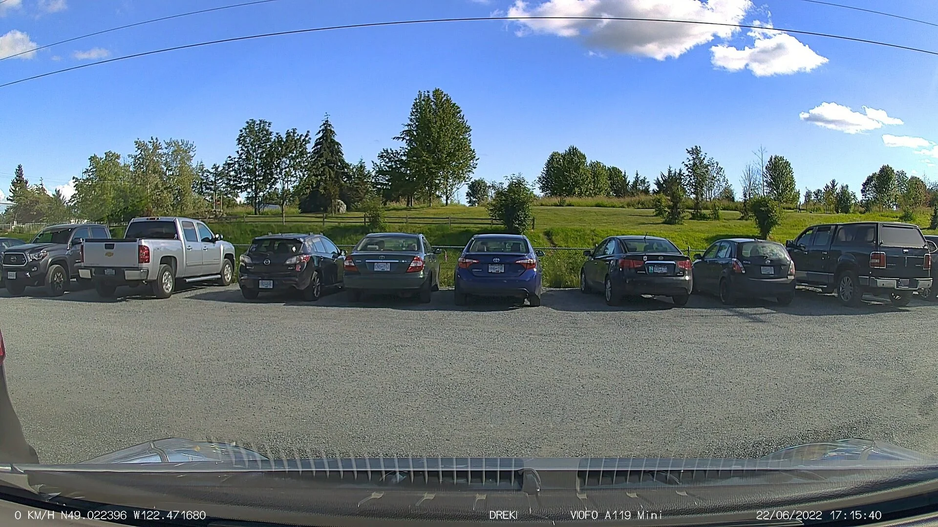

The 1080p is also a mid-frame crop at 1:1 pixel with no binning on my FW. This is a bit awkward I am not sure a dashcam user would want to zoom in this much. Even more awkwardly, it crops off the info text.
Edit: Side tangent, if you have an old version of the Viofo app installed, be sure to update it before connecting to the camera, otherwise it could be very very broken lol
I would have scaled down the 2K image to FHD for the FHD mode, but that is not necessarily what people want either.
Why would people select the FHD modes?
If it is to save memory and extend recording length, it would be better as far as evidence gathering is concerned, to reduce the bitrate setting, not the resolution setting.
If it is because their computers can't manage 2K, well they shouldn't have bought a 2K dashcam!
The only advantage I see for a full sensor, scaled FHD recording is to obtain a higher frame rate, but the current Viofo A119 Mini firmware provides 60fps at both 2K 16:9 and 2K 21:9 resolutions, and it doesn't provide more fps in any resolution, certainly isn't a reason to provide the FHD 30fps mode.
One reason for selecting FHD is to chop the edges off, because that is where you get most reflections, bits of unwanted car trim, and other unwanted image artifacts, so if you want to record a movie, the mid-frame FHD crop is ideal, and it concentrates all the bitrate on the important part of the image. Recording your movies at 2K doesn't give you a better outcome if you were going to chop the edges off anyway, it just wastes bitrate on unwanted image, the current FHD modes do give the best possible quality for movie making.
Maybe people want to crop off the info text when movie making, it is really annoying if you switch to movie mode and forget to disable all the overlay settings! Or if you forget to turn one back on again afterwards.
