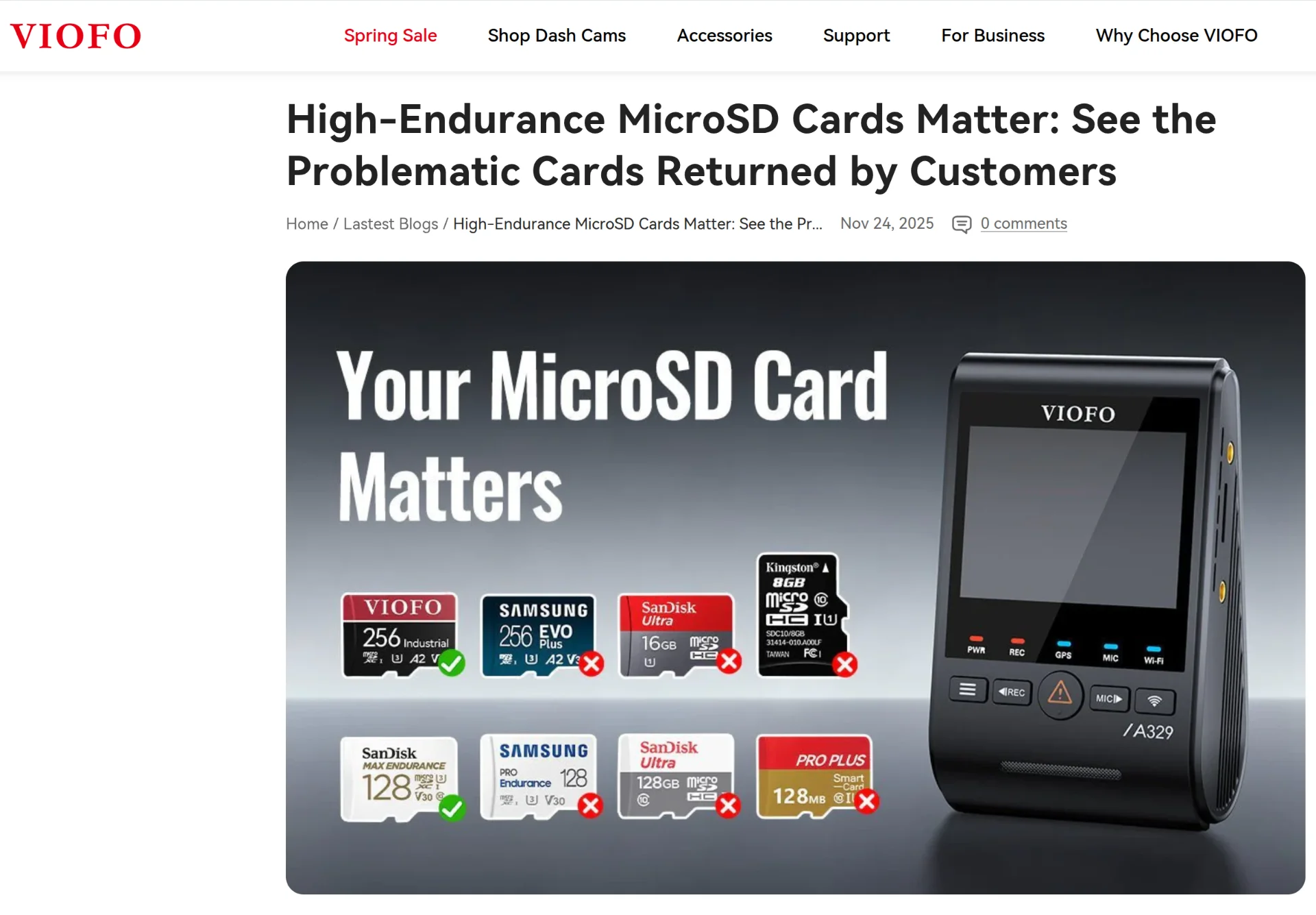

What SD Card are you using?
Anything other than VIOFO Brand, and the approved SanDisc MAX Endurance, (not to be confused with SanDisk HIGH Endurance) will be suspect.
https://www.viofo.com/blogs/viofo-c...e-the-problematic-cards-returned-by-customers

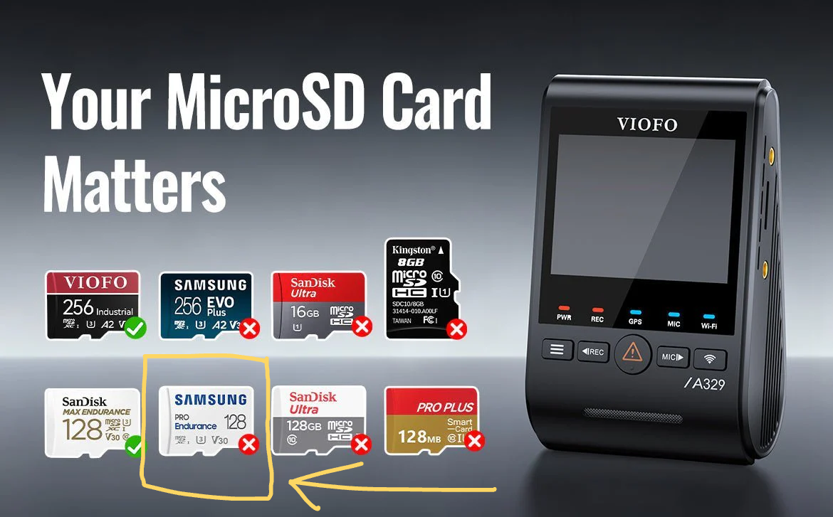

1) I use the VIOFO USB cable-cigarette lighter that originally came with my A119 v3 (died) with a mini-USB to USB-C adapter - basically just tagged on the USB-C adapter.
2) I'll check the Boot Delay setting. It seem that the cam always boots up couple seconds after the car is started, at least it seems that the A119M Pro starts a bit slower comparing to my old v3.
3) I have the Samsung Pro Endurance - I don't remember if I changed the bitrate setting from medium to high after watching new firmware bitrate test above. I'll check to be sure.

The #1 & #2 cause of all dash cam malfunctions is;
1.) “Incompatable” SD Card
2.) “Incompatable” Power Supply
The malfunction you report is most likely a combination of;
1.) A119V3 CLA Charger (A119M Pro uses 5V/3.1A) maybe your A119V3 is 5V2.4A
2.) A119V3 Power Cable (A119M Pro uses 20AWG) maybe your A119V3 is 22AWG, or smaller, (it’s written on the cable).
3.) Mini-USB to Type-C Adapter
4.) “Unapproved” Samsung Pro Endurance SD Card.
Just out of curiosity, did you re-use the A119V3 CLA Charger & Power Cable because it was already installed in you car, (power cable tucked behind headliner, A-Pillar trim, under carpet, etc.)?

I also suggested including a “small” 64GB VIOFO Brand SD card inside the box of every Viofo Dash Cam, just like BlackVue & Thinkware.
So the customer has a “known good card” to aid troubleshooting when they report a recording malfunction using an unapproved SD Card.

4.) Using “unapproved” Samsung Pro Endurance SD Card.
Trying to work around an unsuitable foundation is like “fruit of the poisonous tree”;

On the SD card, all the reviews out there are indicating that the Samsung Pro Endurance SD is better than the Sandisk Max Endurance, so if Sandisk Max Endurance is on the approved list, why isn't Samsung Pro Endurance?
