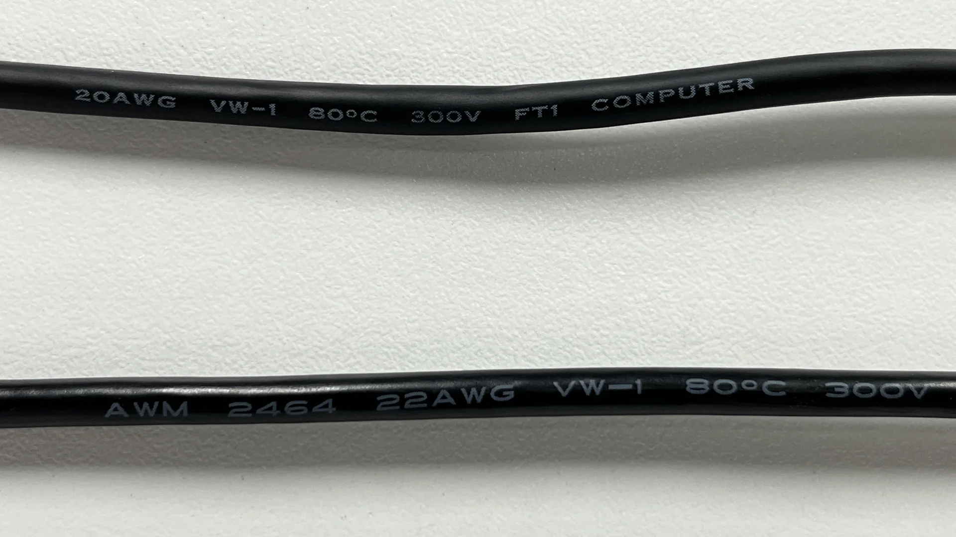

Q: When upgrading from A119 Mini 2 (2023) to A119M Pro (2025) can I use the Viofo Brand USB Type-C Power Cable that was included with A119 Mini 2?
A: Yes, they are both 20AWG.
Q: When upgrading from the original A119 Mini (2022) to A119M Pro (2025) can I use the Viofo Brand USB Type-C Power Cable that was included with A119 Mini?
A:
22AWG: A119 Mini (2022)
20AWG: A119M Pro (2025)
If you experience power starvation malfunctions, you may need to use the 20AWG USB Type-C Power Cable included with A119M Pro.
Thicker wires allow more current / amperage / power.

Can I reuse the existing wiring from the Mini 2 for the 119 Pro?
The included 3.5 Meter Viofo Brand USB Type-C power cable that comes in the box with A119 Mini2 (2023), and A119M Pro (2025) are both 20AWG.
However, the included 3.5 Meter Viofo Brand USB Type-C power cable that came in the box with the original A119 Mini (2022) is only 22AWG.
The smaller 22AWG power cable may experience power starvation malfunctions.
Is this verified information or just a guess?
After finishing the test & review of the original A119 Mini (IMX335) in 2022 it became my rear camera mounted on the rear window using the included USB Type-C Power Cable (22AWG).
After finishing the test & review of the original A229 Duo (IMX335) in 2022 I replaced the A119 Mini with the A229 Duo on the rear window.
I swapped the GPS Mounts, but kept the old power cable, (22AWG).
It worked for a couple days, but then I started having power starvation malfunctions when I would turn on the LCD Screen, and Wi-Fi.
I replaced the 22AWG power cable with the 20AWG power cable from the A229 Duo, and no more power starvation malfunctions.
