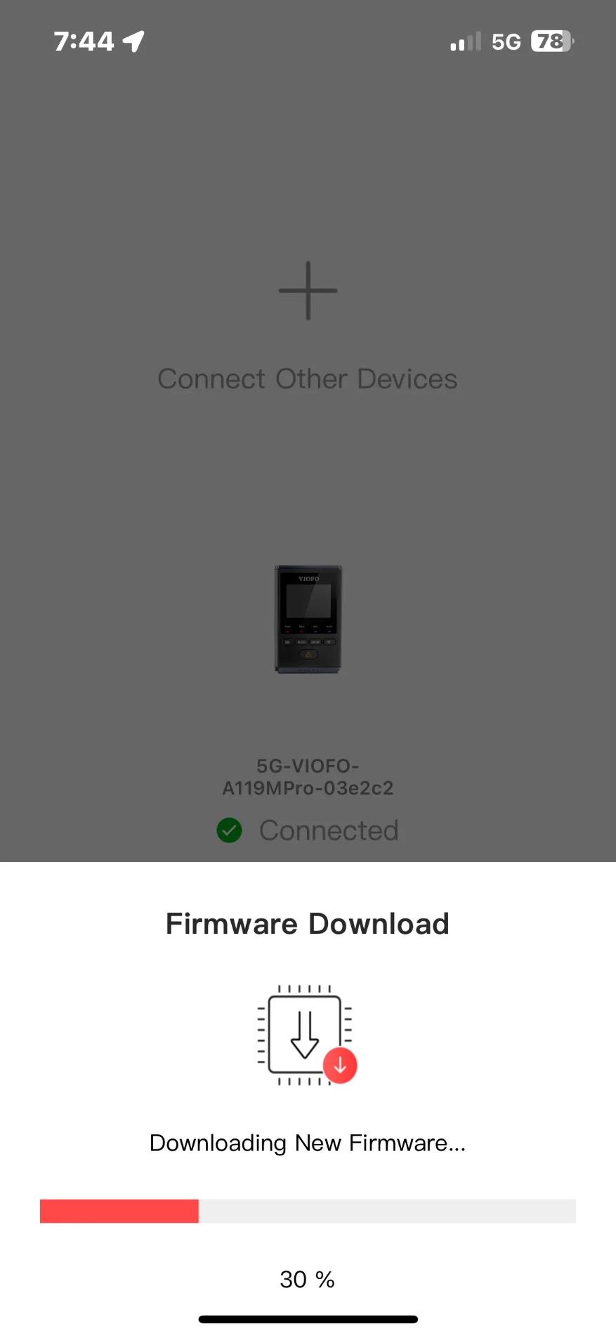

The Android version of the newer VIOFO Dashcam app detected that a firmware update was available for the A119M Pro. Unfortunately, it didn't appear to transfer it successfully to the A119M Pro. I ended up having to use the memory card method of installing the newer firmware.

I have another A119M Pro that I used for this test using the new iOS VIOFO Dashcam app on my iPhone 15 Plus.
The iOS app [version 1.0.5.10] did detect the newer firmware was available for the A119M Pro, but I ran into what looks like two separate problems on the A119M Pro end of the upgrade.

  • Issue 2 - After VIOFO Dashcam app transfers firmware file to the dash camera, it sometimes reboots and sometimes does not
    • With the FAT32 file system memory card in place, I used the VIOFO Dashcam app to upload the FWA119MP.bin v1.2_20260409 firmware to the dash camera.
    • When the app stated the upload was done, the A119M Pro simply continued recording without rebooting to install the firmware file.
    • I disconnected my phone from the A119M Pro Wi-Fi connection and I had the app connect again.
    • The app stated again that firmware version 1.2_20260409 was available.
    • I had the app get the 1.2_20260409 firmware and then the app uploaded it to the A119M Pro.
    • This second attempt resulted in the A119M Pro rebooting after the upload finished and the 1.2_20260409 firmware was installed after the dash camera rebooted

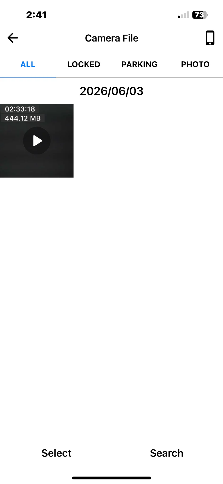

Clip quality definitely looks better now. A 3 minute file on highest settings now occupies 1327mb of space.

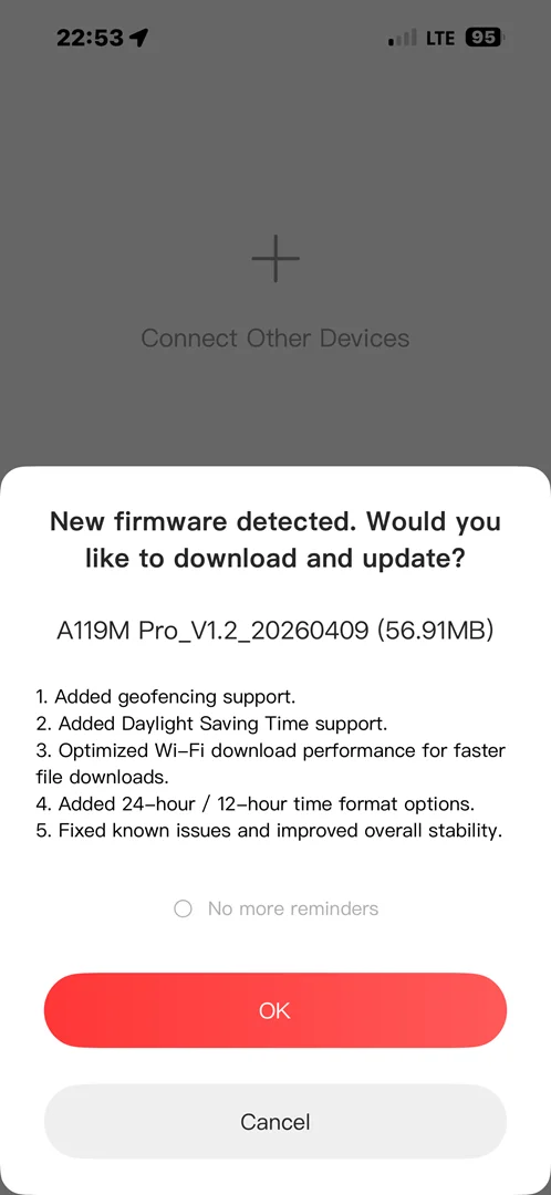

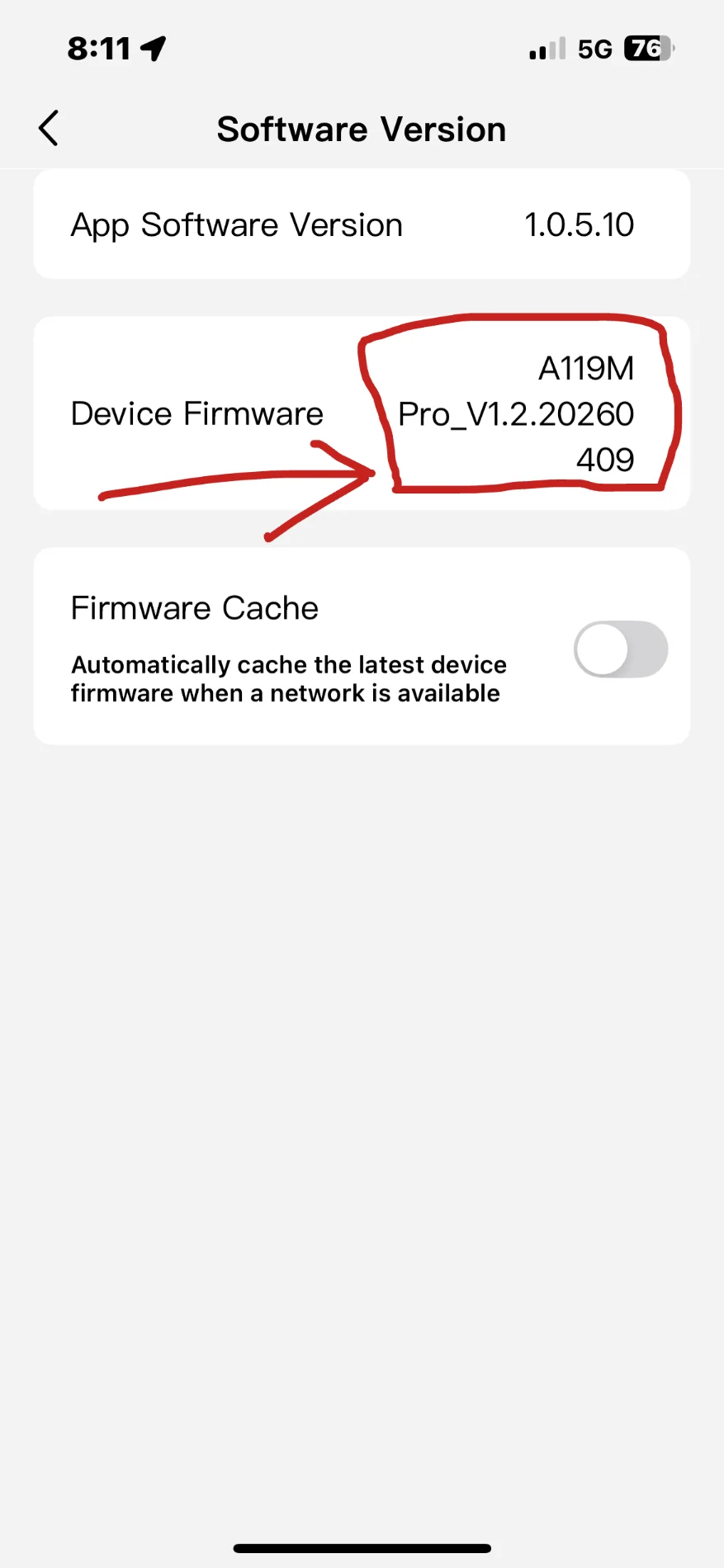

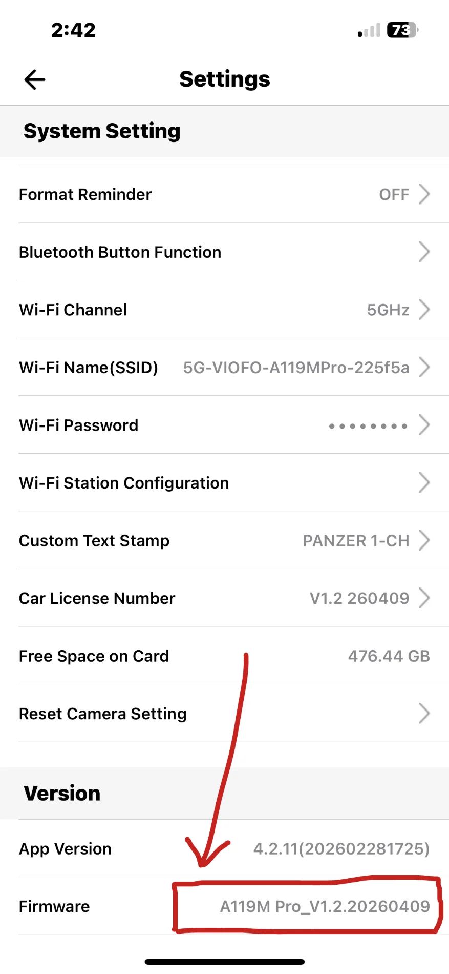

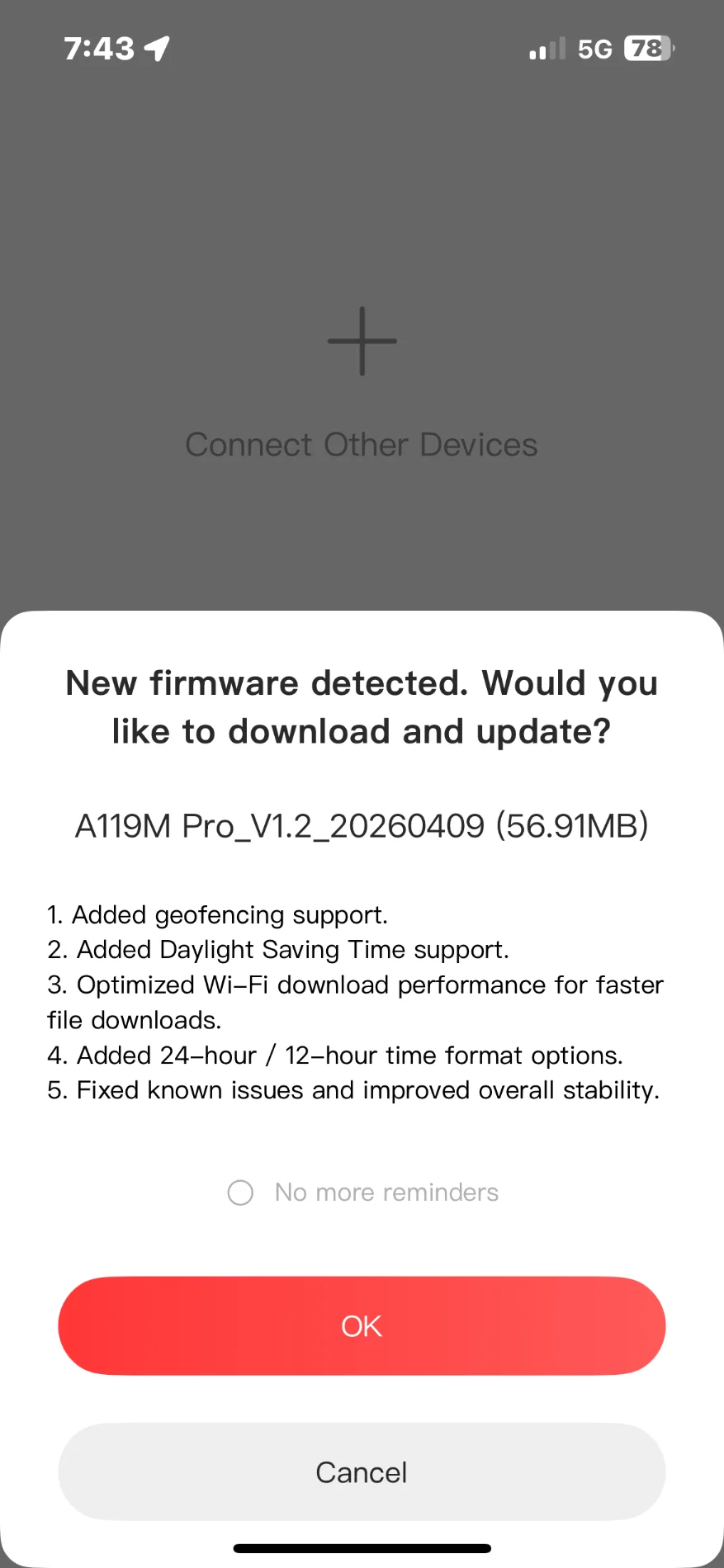

I have (2) A119M Pro units.
First unit I updated firmware with SD Card V1.2_20260409
I tried to update firmware second unit OTA with new APP.
OTA Firmware update does not work.
When I connect to camera, no firmware pop-up message.
Am I doing something wrong?
Is my iPhone too old?
Is my iOS version too old?
See attached screenshots.
-Chuck
Does the cellular network on your phone work properly when you using the app? If yes, would you mind providing a complete log to analyze?
Good news.
I deleted the APP from my iPhone, and re-installed it.
OTA firmware updates now work OK.
I don't know how to do this.
Can you explain so I know for future use?
