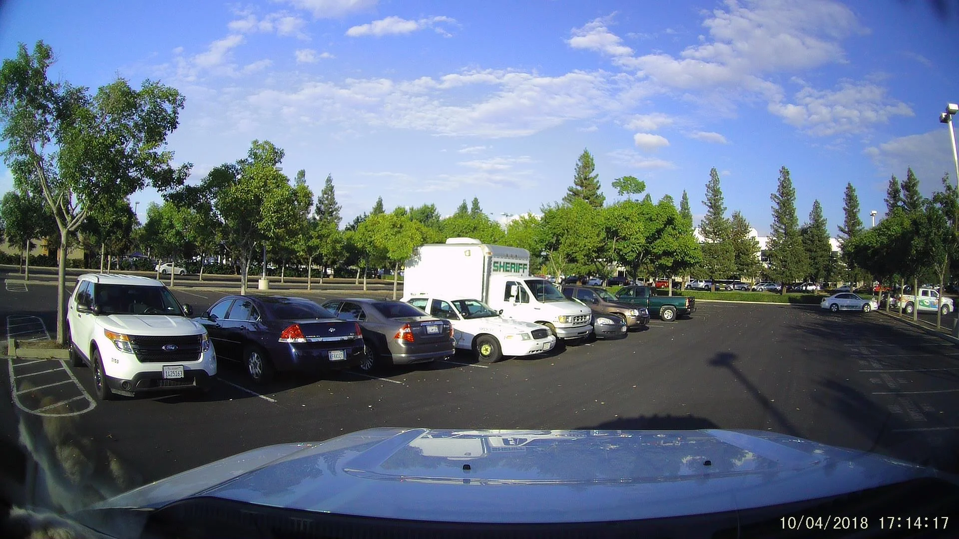

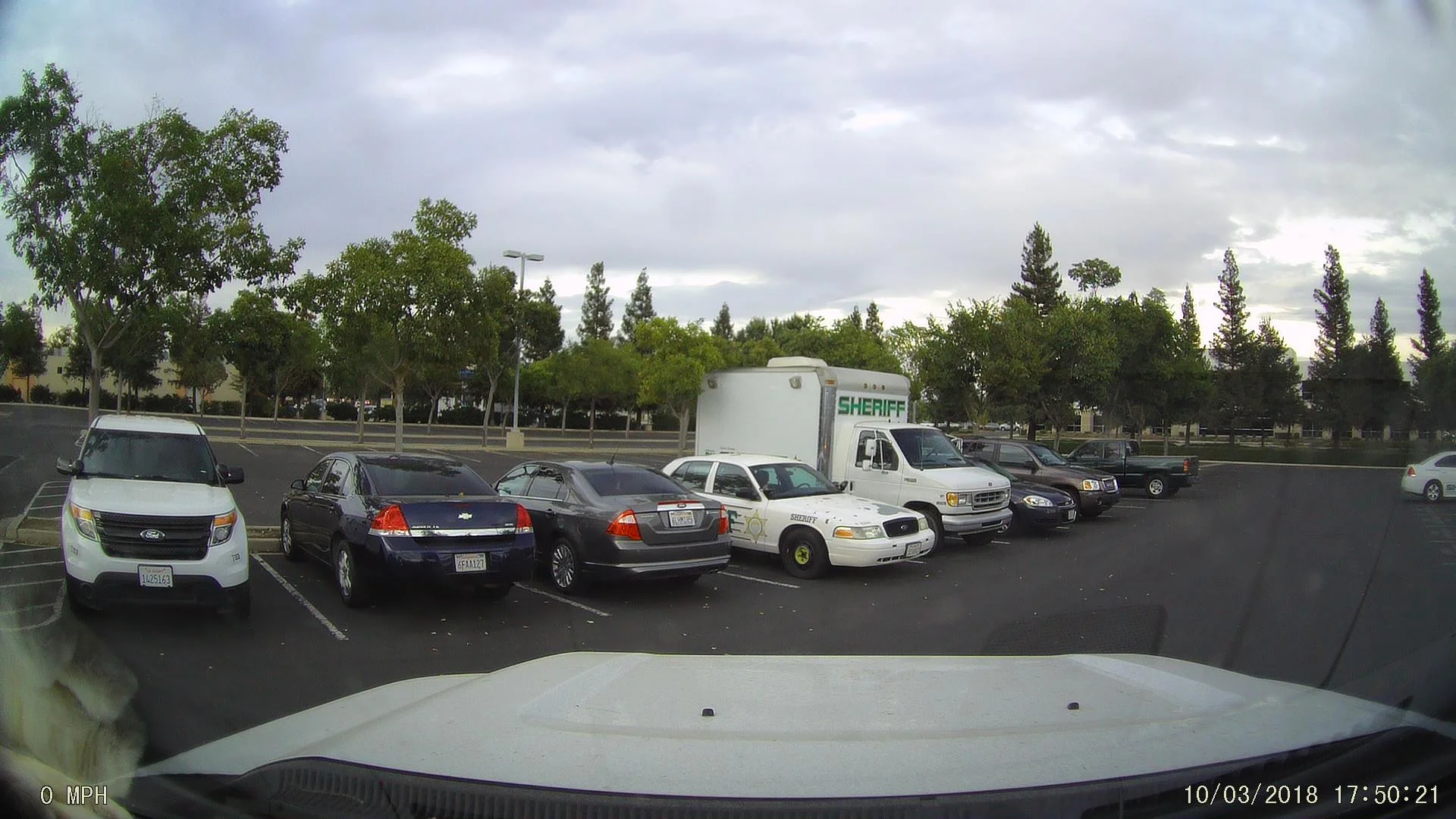

Some requested still shots over two days, one slightly overcast and one sunny afternoon.
I am working on fixing my center focus, (hopefully this weekend)
FWA119S_MOD-6Nm_v4.02+26Mbps+Sharp435363+Edge138+Hue118+Sat26+Audio22+DCTEAM
Sharp 43 (Low) Overcast
Sharp 53 (Med) Overcast
Sharp 63 (High) Overcast
Sharp 63 (High) Sunny
Sharp 43 (Low) Sunny
FWA119S_MOD-6NL_v4.02+26Mbps+Sharp435363+Edge138+Hue118+Sat26+Audio22+DCTEAM

Great 6NL Comparison, either my eyes need cleaning or your labeling of the sunny photos low/med/high is reversed (low-high) or all my sharpness MODs are backwards.
either way, these photos confirm the Sharp 43-53-63 is acceptable for your specific A119S focused Lens. Predictable owners with poorly focused center image will prefer extreme sharpness MODs to compensate.
You are absolutely correct. I have corrected the labels.
I am hoping to get the lens focused this weekend and retest same place.
Also I realized I copy/pasted the wrong file name.
This test set is with 6NM, not 6NL. Sorry about that.
The 6NM only difference was Hue red to blue and Saturation from 26 to 36. Looks slightly too saturated, need more feedback.

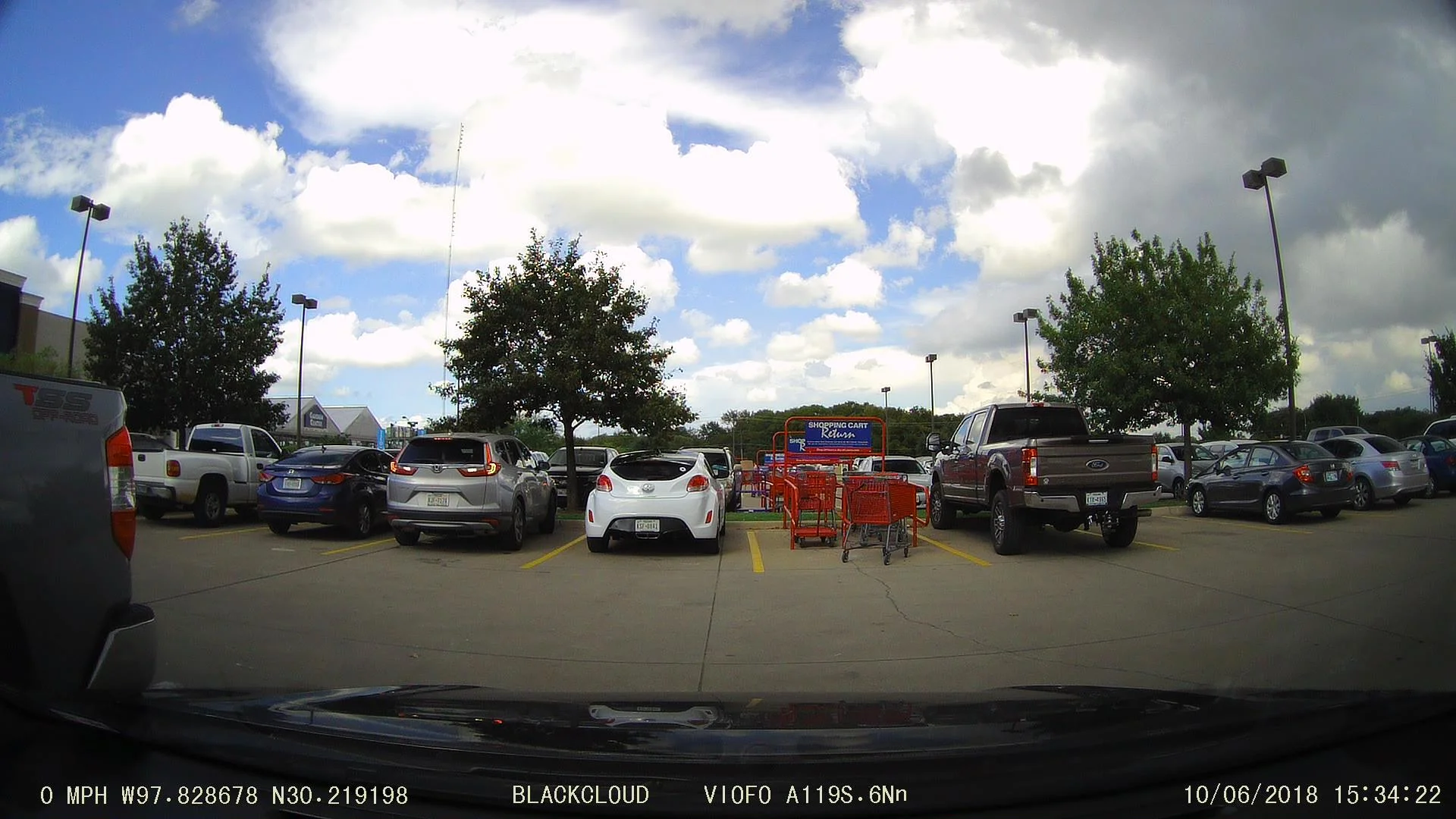

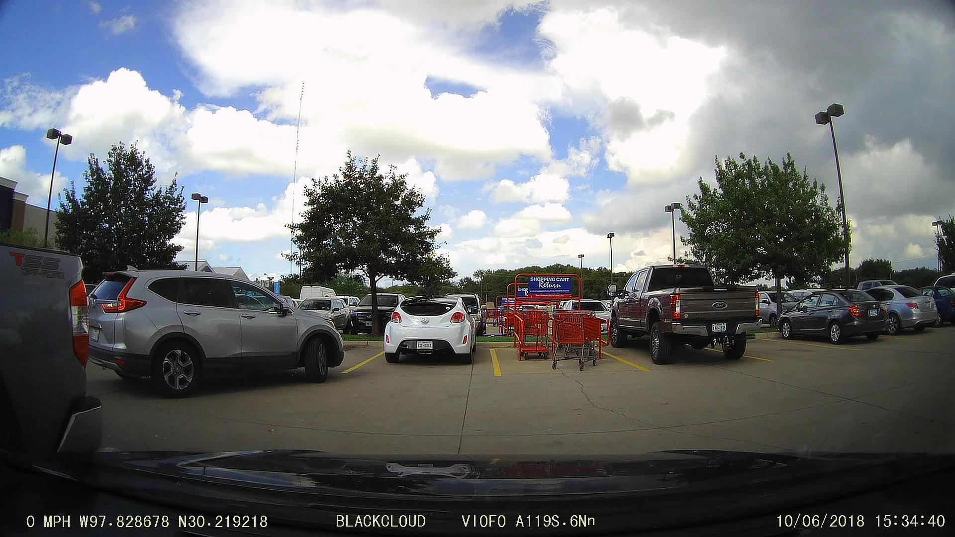

Requested Test All from Good Lens Camera:
Firmware: FWA119S_MOD-6Nn_v4.02+26Mbps+Sharp435363+Edge158+Hue148+Sat36+Audio22+DCTEAM
Res: 1080P 60fps
Ev = 0
WDR = Off
CPL = On
60Hz
Still Photo with Sharp at 53
Still Photo with Sharp at 63
Clip at Sharp 53
Clip at Sharp 63

Thanks for Alpha testing 6Nn with extreme Sharp435363+Edge158+Hue148+Sat36, your footage identified IQ value halo limits for A119S.
Edge Detection 138 produces acceptable image quality over all sharpness levels.
Your Lens has perfect focus, well done.
