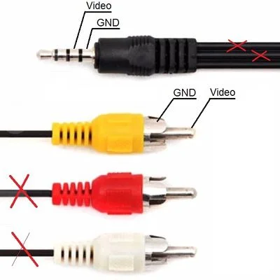

PS: Features of connecting an external monitor to A129 Pro (this applies to all Viofo models that have an AV output connector):
a cable with a 3.5 mm 4-pin mini Jack connector (TRRS) to the RCA is used for connection.
When the mini-jack connector is connected, the display on the dashcam turns off.
Before connecting, check the pinout of the cable.

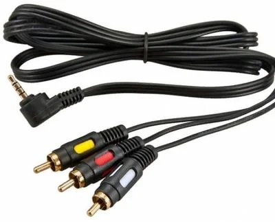

It may be more convenient to use a mini-jack with an angled connector.
And since the cable from the mini-jack 3,5 мм to the RCA with one tulip (only for video) is very rarely used, it's easier to take the cable in the "noodle" version with three tulips, and then just separate the two extra wires and cut in the right place. ;)
PS: and in order to connect the cable on your head unit there must be a connector for the AV-in
