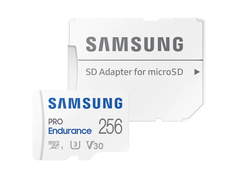

I'll confirm that the new Samsung Pro Endurance 256gb is working fine with the Viofo A229. Been using it for about two weeks and haven't had any issues. The other card I didn't have any issues with was the Sandisk 200gb Ultra A1.
Cards that I've tested and does not work well are listed below:
  • Samsung Evo Select (green/white; used 256gb version)
  • Samsung Evo Select (2021-blue; used 512gb version)
  • Sandisk High Endurance (used 128gb version)
Right on,
I was wondering about the "NEW" Samsung Pro Endurance because it looks like the old version is being sold out / phased out on Amazon.

Hopefully this is just a firmware/SDK issue that can get corrected at some point, because the SanDisk High Endurance cards have been solid with the older models and can be purchased for a decent price.
The Sandisk High Endurance is rated as V30, so it really should be adequate, if not then these rating systems are useless! Maybe it has a different memory layout to the others, which is what makes it high endurance, in which case the dashcam firmware can be adjusted to work.

Correct. As far as I'm aware, those are the only two that do not like the SanDisk High Endurance cards. Those are the 2 newest models. I don't think they are an issue with the A139, not sure on the T130 yet. Hopefully this is just a firmware/SDK issue that can get corrected at some point, because the SanDisk High Endurance cards have been solid with the older models and can be purchased for a decent price.
Not working with my T130. It's working with A119S though.
There is only 1 bad report I know of concerning the A139 and that card, but it is from a very experienced user and an official Viofo tester here so I also cannot discount his problem or attribute it to "user" error given how experienced he is.
It seemed to work fine for some other people here though in the A139...
I can also vouch that it works fine in my Street Guardian SG9667DC2K without any issues, and I'm sure that they have tested it with all their products since that is the specific card that they bundle with all their products.
Lothar's musings:
For the longest time, Samsung never had a 256GB PRO Endurance card..only 128GB maximum, so SanDisk was the only option for many of us that had a 2K 2Ch dashcam and record at the maximum bit-rate setting possible.
Samsung finally now has a 256GB Pro endurance card which they released in April earlier this year, and it is also selling at a decent price from Amazon. This changes the dynamics (in the US at least, can't speak about other parts of the world as price/availability issues may persist).
256GB SanDisk High Endurance256GB Samsung PRO Endurance256GB SanDisk MAX Endurance
Read speed100MB/s100MB/s100MB/s
Write speed40MB/s40MB/s40MB/s
Rated hours of videoUp to 20,000 hoursUp to 140,150 hoursUp to 120,000 hours
Warranty2 years5 years15 years
"True" Warranty20,000 hours or 2 years...Whichever happens 1st.140,150 hours or 5 years...Whichever happens 1st. 120,000 hours or 15 years..Whichever happens 1st.
Price on Amazon (shipped & sold by Amazon.com)$34.99$37.99$56.49
Based on this table, I would not even consider the SanDisk "High" Endurance model today as long as the Samsung PRO Endurance is readily within the same price range since that is clearly a better rated card for only $3 more which is nothing.
Looking at the specs alone, I would put the Samsung PRO Endurance either equal to the SanDisk MAX Endurance, or maybe just slightly below in quality. It seems better than the SanDisk High Endurance model for sure.
Given how little the difference is between the Samsung PRO Endurance and SanDisk MAX Endurance, I question the utility of paying an extra $20 (which is almost a 50% price increase) for the latter given the diminishing returns...
When it was just SanDisk High Endurance vs MAX Endurance at the 256GB level, paying $20 for a much better card was easy to justify as you are getting at least 6x the performance (whether you decide to use the "rated hours of video recording" metric or "years of warranty" actuary tables as calculated by their engineers/financial/insurance analysts). Now the difference between the Samsung PRO Endurance and SanDisk MAX Endurance is not as clear...
