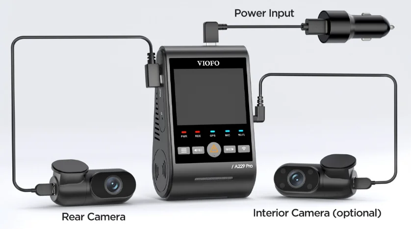

Could be so bold as to ask you if you could take a picture of the main unit with the only the power cable and rear camera cable fitted and post it on here for me to see, am begining to lean towards the a229pro 🙂
worst thing i done was join this bloody forum lol

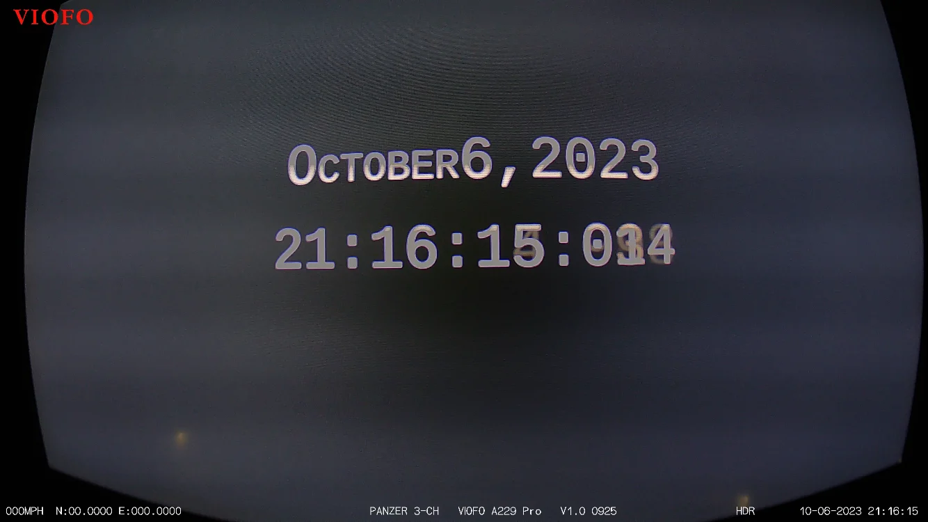

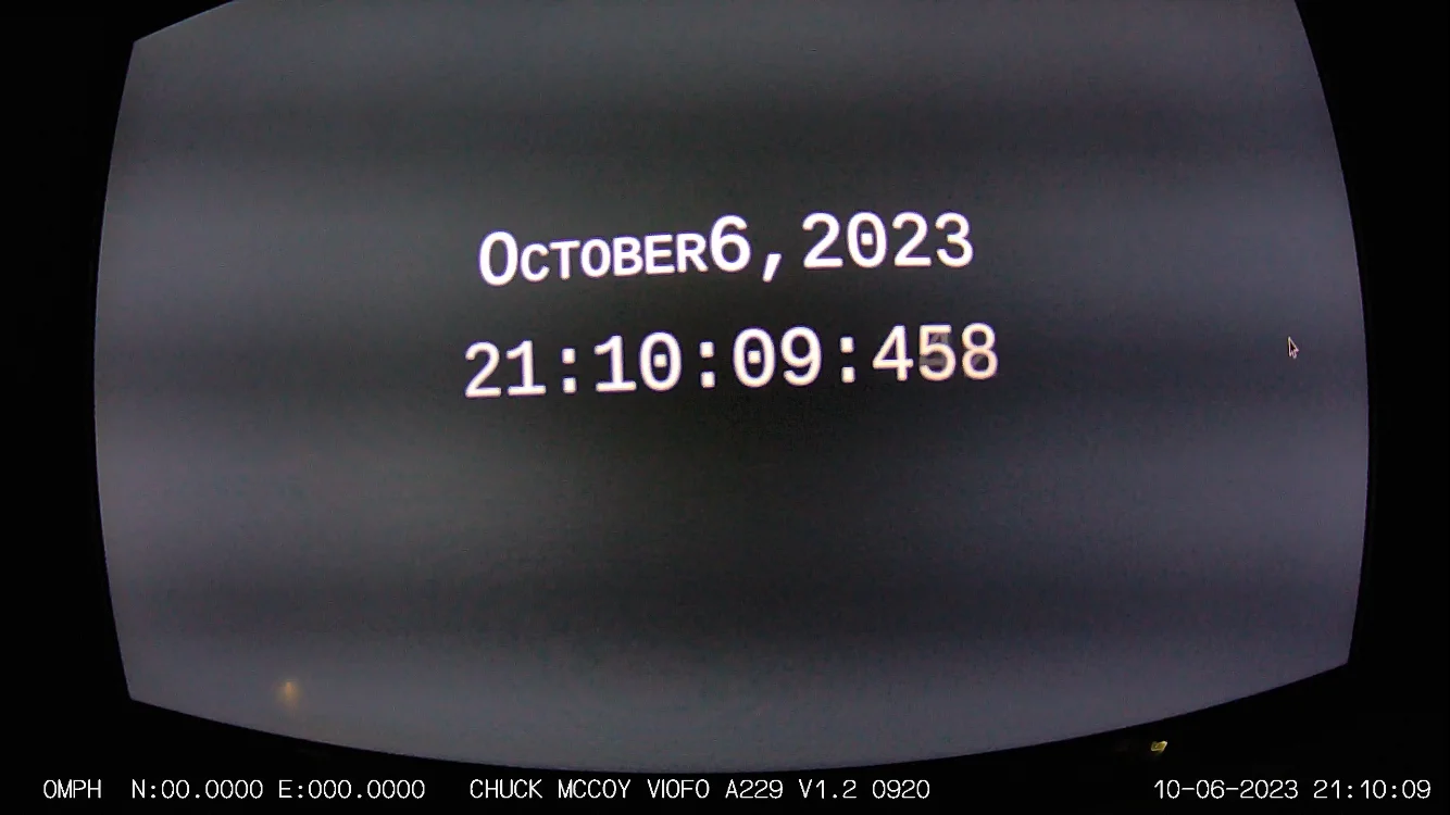

BOOT UP TIME
While gathering test footage with 5 different cameras on my test rig I found it annoying some cameras booted up, and started recording much faster than others.
While taking screenshots I noticed that some cameras started recording around 20 seconds faster than the slowest one.
I remember reading a post about a user thought his camera was defective because it took much longer to start recording than his previous camera.
Since I had the cameras on my desk I figured why not have a race.
I spent over an hour conducting speed tests in different channel configurations, and different capacity SD Cards.
I learned some useless, but interesting things I never thought about.
I won’t bore you with what I did for over an hour, so I will boil it down as much as I can.
I will limit this post to the original A229, A229 Plus, and A229 Pro, (all 1-CH configuration).
I used the same Viofo 64GB SD Card, (formatted in each camera before performing test), and the same power cable & power supply in an effort to reduce inconsistencies.
I performed this test by pointing the camera at a clock, and turning on the power supply at the top of the minute, (see attached screenshots).
Here are the boot up times;
A229 1-CH……………9.4 Seconds
A229 Plus 1-CH……..15.1 Seconds
A229 Pro 1-CH………15.0 Seconds
Interesting note: When I put the A229 Pro & A229 Plus in 3-CH configuration, and used a Viofo 512GB SD Card the boot up time increased to approximately 33 seconds.

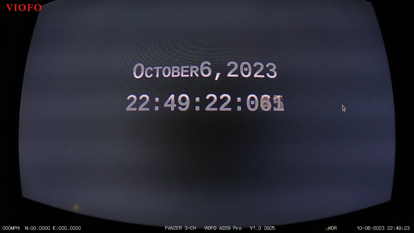

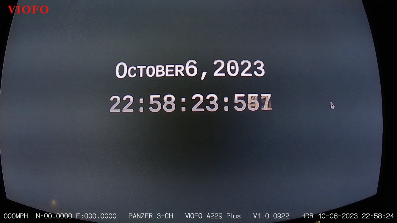

BOOT UP TIME - PART 2
I figured I better confirm & verify in 3-CH configuration with Viofo 512GB SD Card.
I used the same Viofo 512GB SD Card, (formatted in each camera before performing test), and the same power cable & power supply in an effort to reduce inconsistencies.
A229 Plus 3-CH……..23.5 Seconds
A229 Pro 3-CH………22.0 Seconds

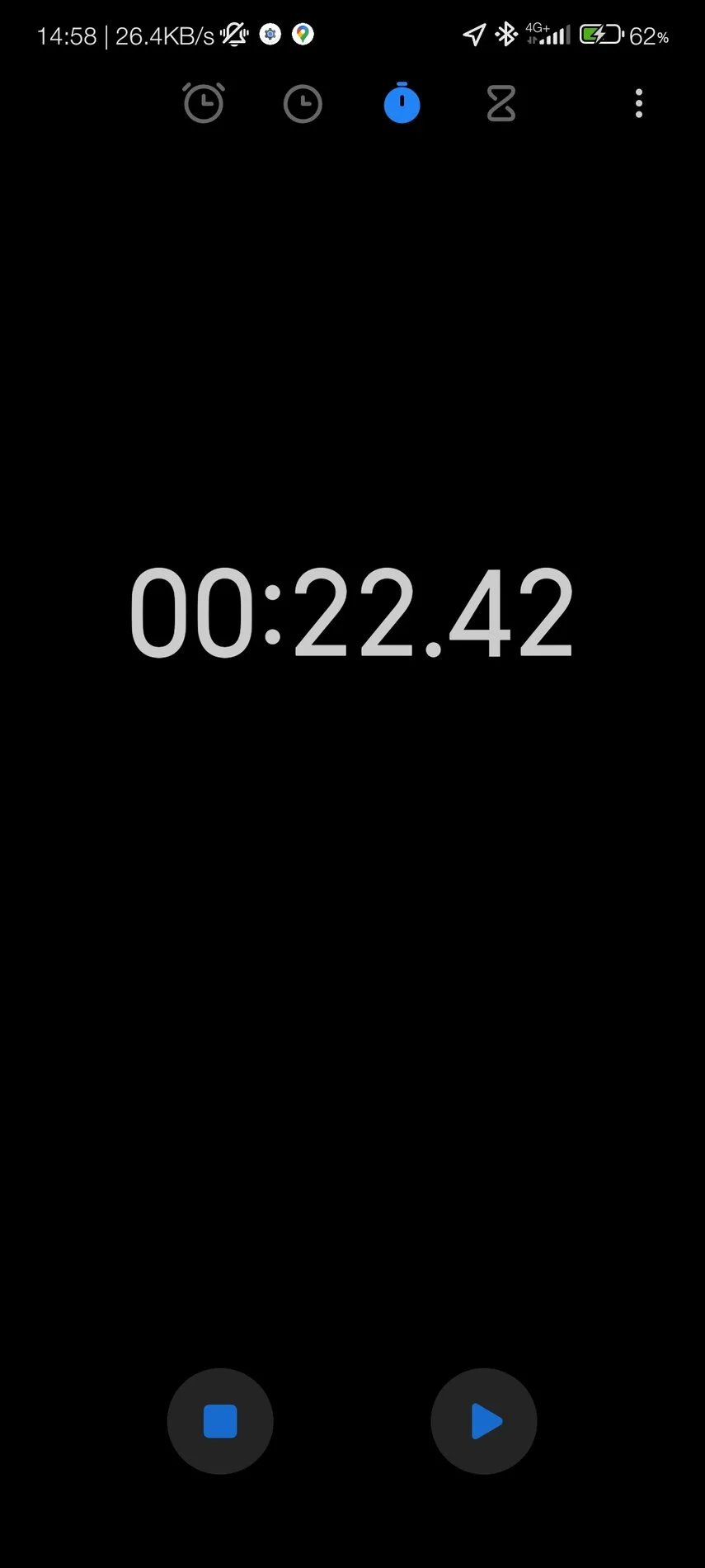

Ok so my guesstimate previously wasn't correct, but can independently validate your claims. 22.4 seconds for moi on A229 Pro from turning the key to it showing that it's started recording.
Also got similar time with the Vantrue Nexus 4 Pro 😱
It's not a deal breaker by any stretch, but any reduction in start up time is welcomed and appreciated
