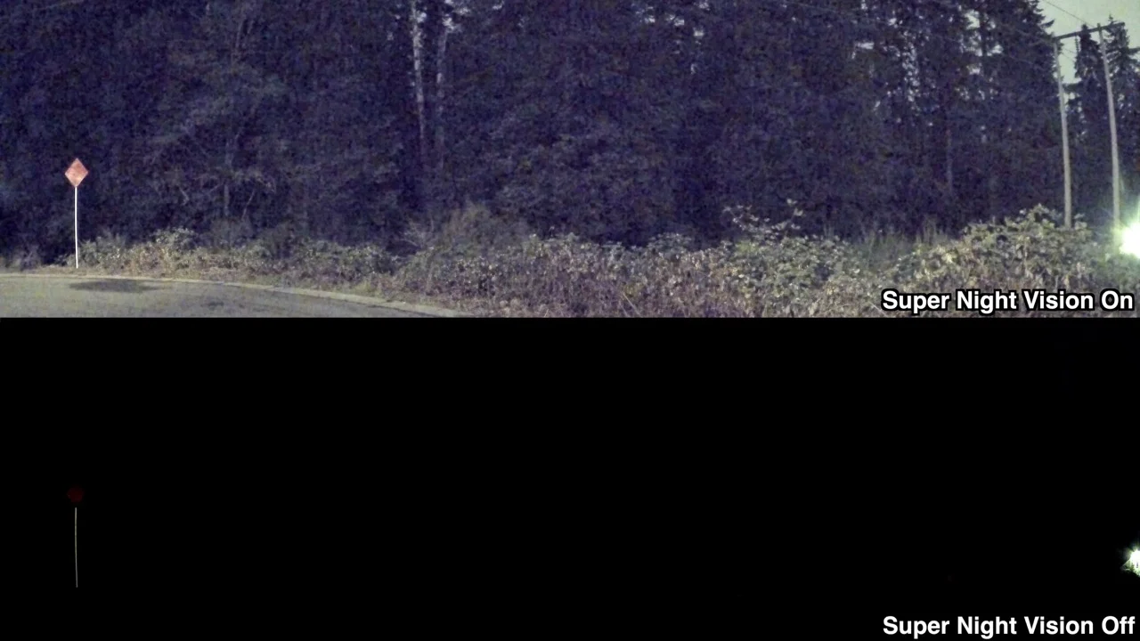

The super night vision for the 1fps timelapse parking recording definitely makes a big difference. Check this out parked in a dark culdesac...

Very nice, reminds me of night mode on phone cameras but that's a big jump in visibility

Why are they bothering with an additional “night vision” for parking mode?
Is it because when the car is off, and the camera is in parking mode you don’t have the benefit of headlights?
Are they just cranking up the exposure / brightness?

Looks similar to the results I was getting with my beta low-light camera in 1fps mode.
I assume there's a fair amount of motion blur in this mode? If so, it's useful to see what's going on around the car and you can tell the difference between a black car and a blue one, but finer details like faces or moving number plates are harder to see.
Yeah, I asked about it and they said they're achieving this by reducing the fps in this mode which I presume to mean longer exposures per frame which would lead to more motion blur. I'm very limited in my ability to do night time testing at the moment, but this would definitely be something to check out.
is the super night vision time lapse better current draw?
Yep! Looks like SNV draws nearly 30% less power than regular TL 1fps. Check out @rcg530's testing:
