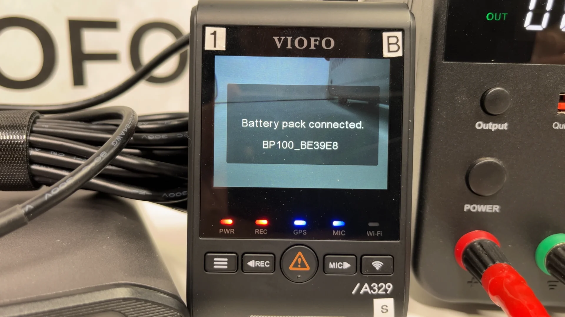

BP100 paired with A329S.
Firmware: V2.1 260702
See attached screenshots.

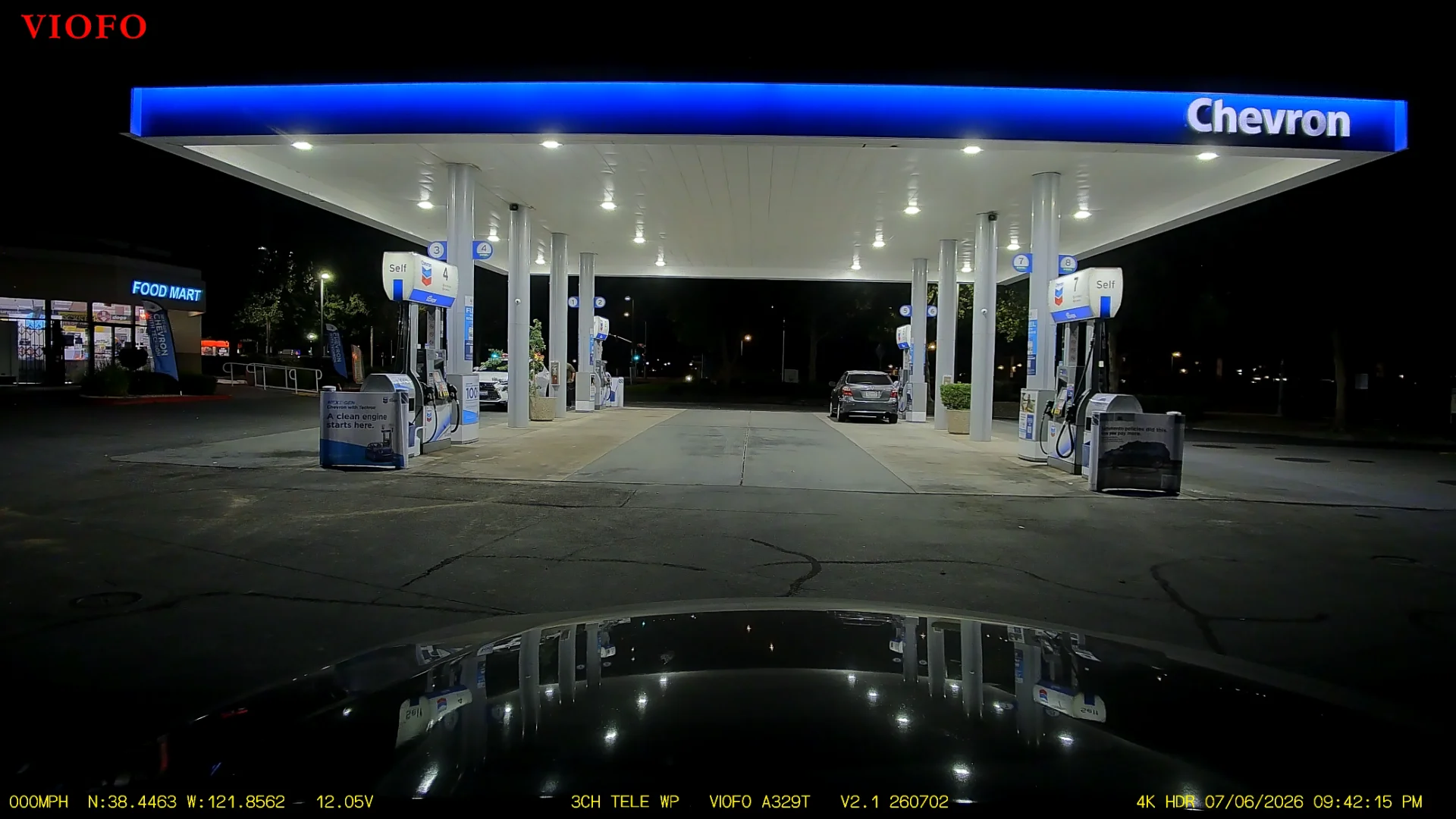

I’m officially starting to fall in love with the new Dewarp Setting.
I’ve only tested one other dash cam that had Dewarp.
I can’t remember if it was GNET, or Thinkware.
Of course there’s pros & cons to everything but I don’t see any cons.
I measured the additional power consumption from the small amount of processing power siphoned away, and it’s such a small amount it’s not even worth mentioning.
The tiny bit of “cropping” around the four outside edges of frame are not missed.
Because those parts are bent / distorted anyway.
And anything missed can be captured with left & right side cameras.
I wish this Dewarp effect was available with hardware, and the normal default image but I guess lenses choices are limited for IMX678.

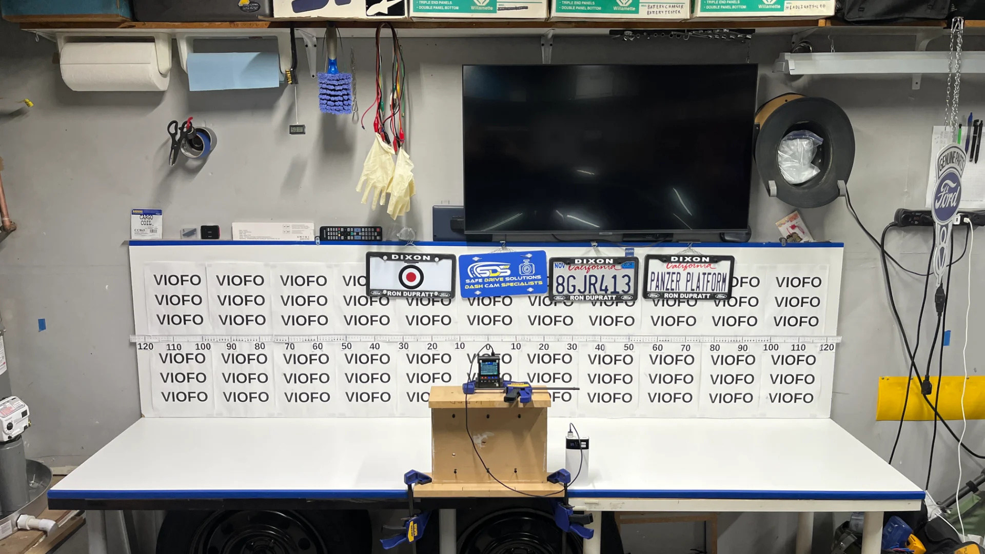

The field of view reduction from 111° to 90° might be significant for some users, and most don't have side cameras. But I admit it's a nice option to have and no-one is forced to use it.
