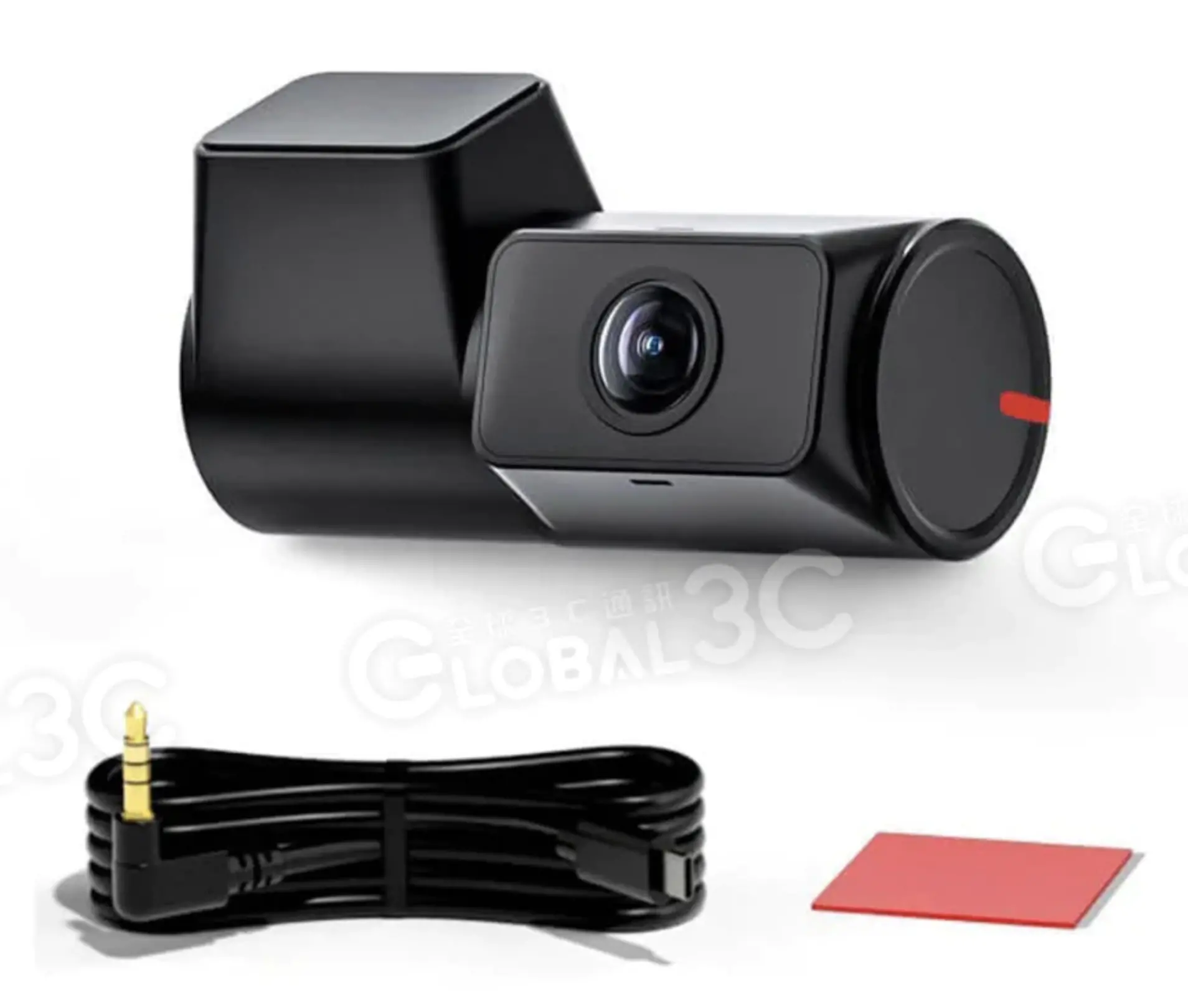

VIOFO A229 PLUS/A229 PRO dedicated RC300 3.5mm rear lens appeared in Taiwan online shopping malls

I see the spec on the box says 1080P Full HD. The normal RTC300 is 2.5K (IMX675). I wonder if that is the non-HDR IMX307 which is used in the A229 interior camera?
Perhaps this is a compromise of connecting a telephoto to the 3.5mm interior camera port?
UPDATE: My mistake not reading the box correctly. This is a rear camera, not a telephoto.
