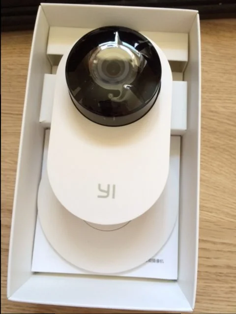

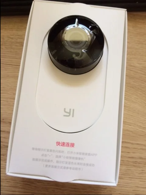

Well the postman has just delivered another few toys today including this one - I bought this one from @GearBest as the price was great at just $33.71.
It's an extremely nice looking unit for the price - a rubberised bottom etc and would fit nicely into any modern looking house.
There are no motors or anything as it's just a camera so I am looking forward to seeing how this one looks.
It's going to be tonight before I get any time to look at this one so I'll let you know how it goes.

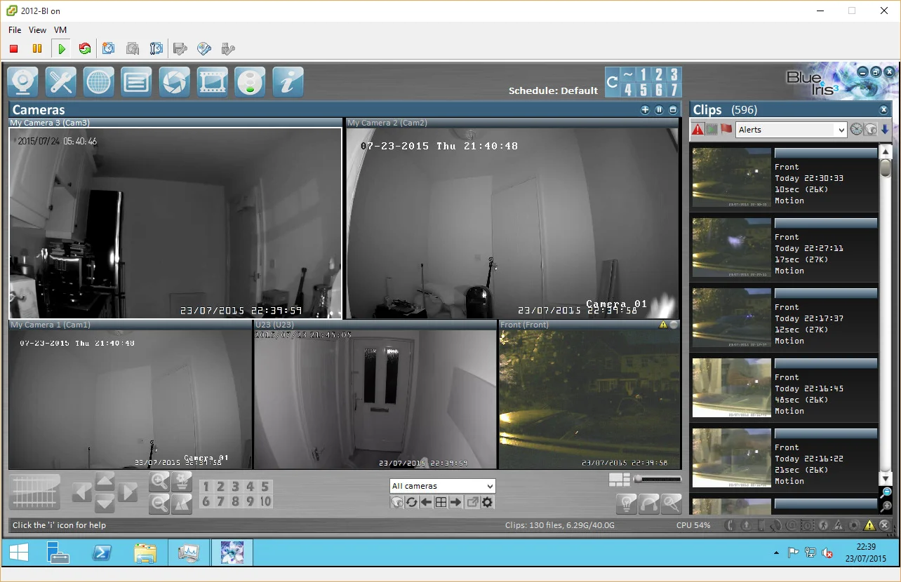

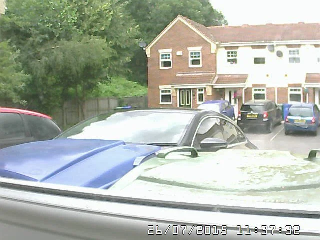

Just need to work out how you can turn off the bloody IR light now - if you're not sticking this out of a window then you'd probably be happy with the quality of this camera - I'm away for a wedding for the next couple of days so will leave it running to see if it's stable for the weekend.
The Wifi doesn't seem the strongest and even with the latest firmware the IR does seem to go up and down a bit as though it's hunting.
On the plus side I cannot see the IR lights at all at night - they're on and working but I can't see them at all.
My poor old Blue Iris is getting hammered at the moment!
The Xiaomi Yi Smart camera is the top left - top right is Hikvision 2.8mm, bottom left is Hikvision 4mm, bottom middle is the Transfluent U23 and the bottom right is an old Tenvis 480P PTZ camera.

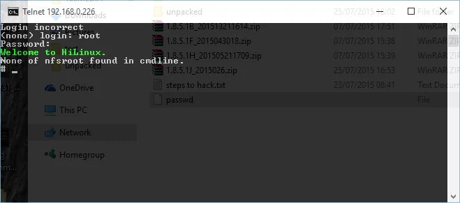

They released firmware J that stops this working now.

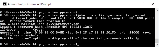

I got telnet access to the device but you need the root password so just trying to crack that.
OP
reverend
reverend
Apr 22, 2014
5,462
3,776
Too many
Looks like the root password is 1234qwer on these.
That would be a yes then :)

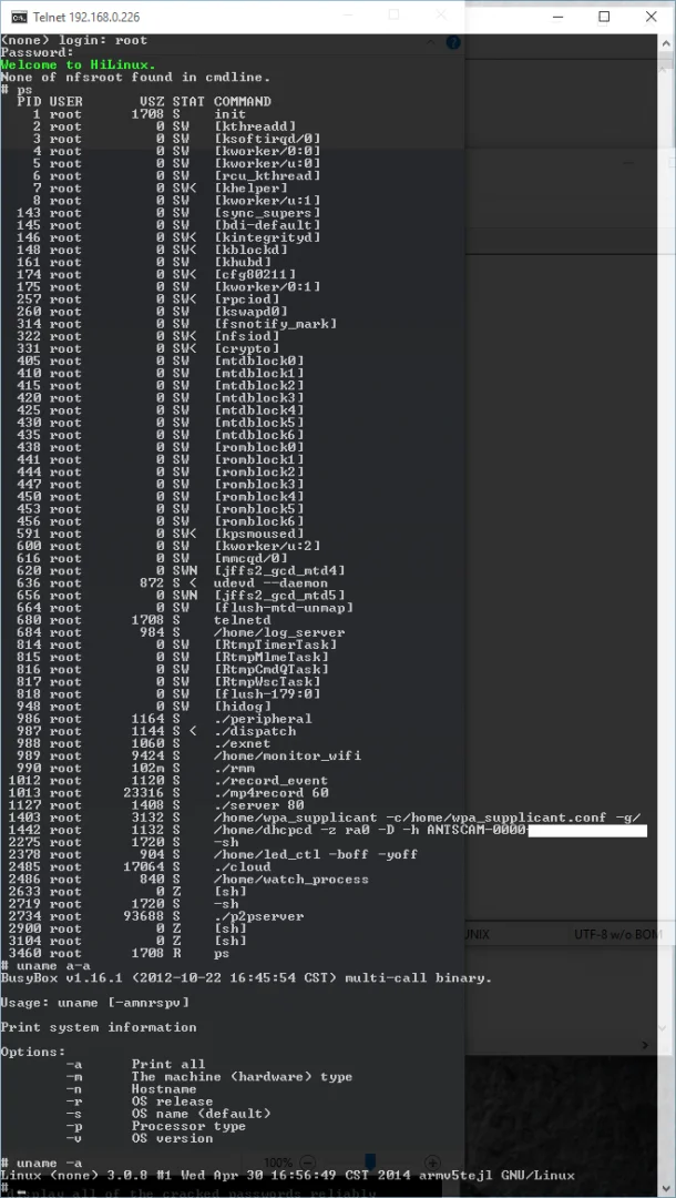

Full process list of 1.8.5.1J here:

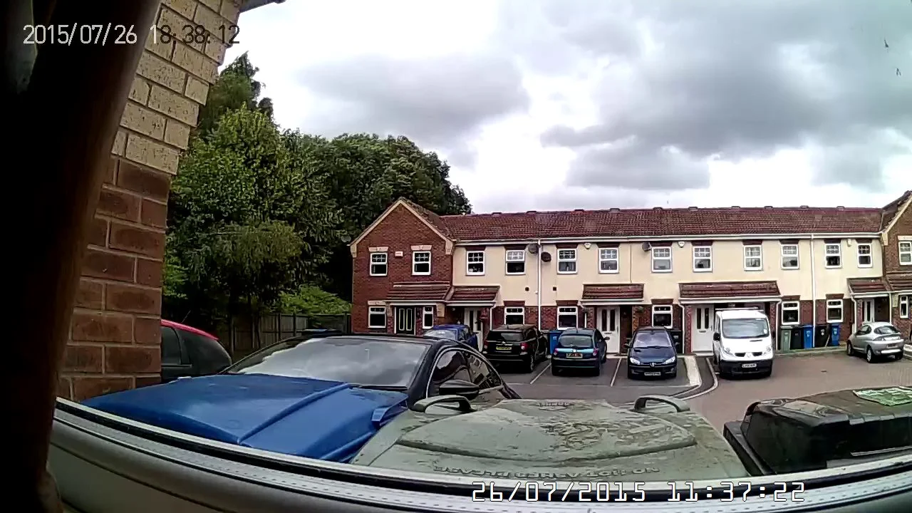

Here's a couple of comparison shots of the Yi against a Tenvis JPT2815W wifi camera - you can see how much larger the FoV is on the Yi - not always what you want for CCTV but good for smaller spaces when they're inside the house. In terms of the actual raw size they are very similar when you take the extra resolution into account - maybe matching the Yi with a different lens is a job for a different day.

The eagle eyed will notice the time difference - the Yi sets UTC to Chinese time - you can add an ntpd command such as this to the end of the script: to bring it inline with UTC.
