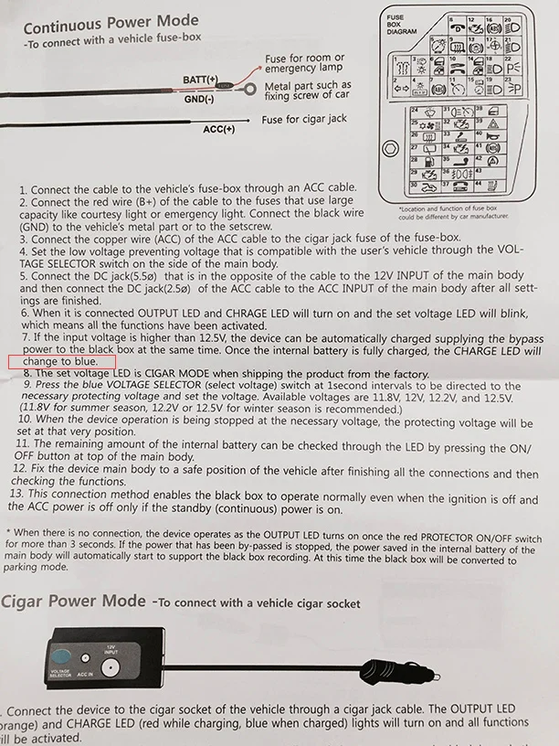

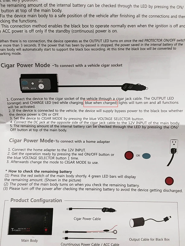

My experience with TPowerplus alfa.
I decided to buy a “TPower plus α” from Anypower. There was a leaflet with two different mounting modes in the box: the “Continuous power mode” and the “Cigar power mode”. I thought this would go straight forward; …not so. The instructions were not very clear to me and above all I couldn’t find information about the properties of the different hardwiring methods. So I went back to internet and this made the confusion even worse. Do you have to follow the “Continuous Power Mode”?, the “Cigar Power Mode”? Why should I use one or the other? What is the ACC input? Do I have to connect it to the 12V or only connect the red cable to the 12V? etc…
I did some experiments with my TPowerplus alfa connected to my DR 650GW-2CH, below you will find my conclusions. For those who want a more detailed description, I refer to the attachment.
Rik
If you use the “Continuous power mode” or the “Cigar mode” following the connection instructions given in the Anypower leaflet, you are safe.
BUT! In the cigar mode, check that the cigar lighter is disconnected from the car battery when the engine is off, or when the car is in sleeping mode. If not your battery may discharge below the safe level.
In parking mode, the autonomy of your cam will be longer in Continuous power mode than in Cigar mode.
  • Don’t! Connect the ACC at a place that stays “hot” when the engine is off or when the car is in sleeping mode. You will discharge your car battery below the safe voltage level.
  • Don’t! Put the Tpp in Cigar mode when the 12Vin (B+) is connected to a place that stays hot when the engine is off.
  • Don’t! Forget to connect ACC to a place that is hot when the engine is on, or to use the Cigar mode; if you do, you will not charge the battery of the Tpp.
