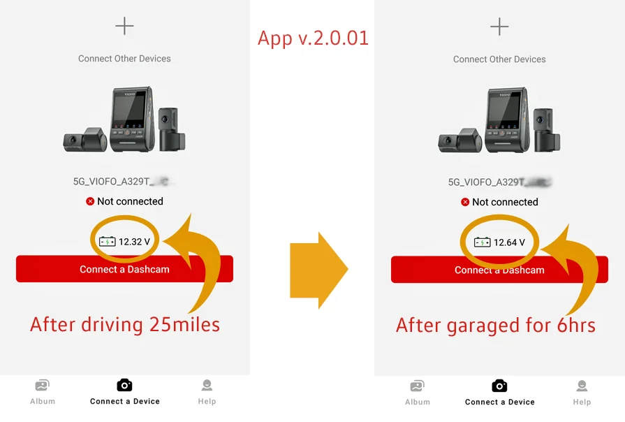

For a while I've had doubts over the accuracy of the battery voltage displayed on the start screen of the app.
A329T. Using HK6 hardwired. Hybrid parking mode.
Even when the car isn't being used & the app not connected to the dashcam, the voltage changes, both up and down.
I set the voltage as 12.2v with no time cut-off, but twice I've noticed that after stopping briefly (car wash queue) the dashcam switched off (low voltage).
After being garaged for hours the voltage was higher than immediately after a 25 ml drive.
The car is only months old with 4k on the clock and there's no reason to think it has any problems.
I've now set the voltage at 12v with 3hrs cut-off, to see if that makes any difference.
Has anyone else noticed this kind of discrepancy?

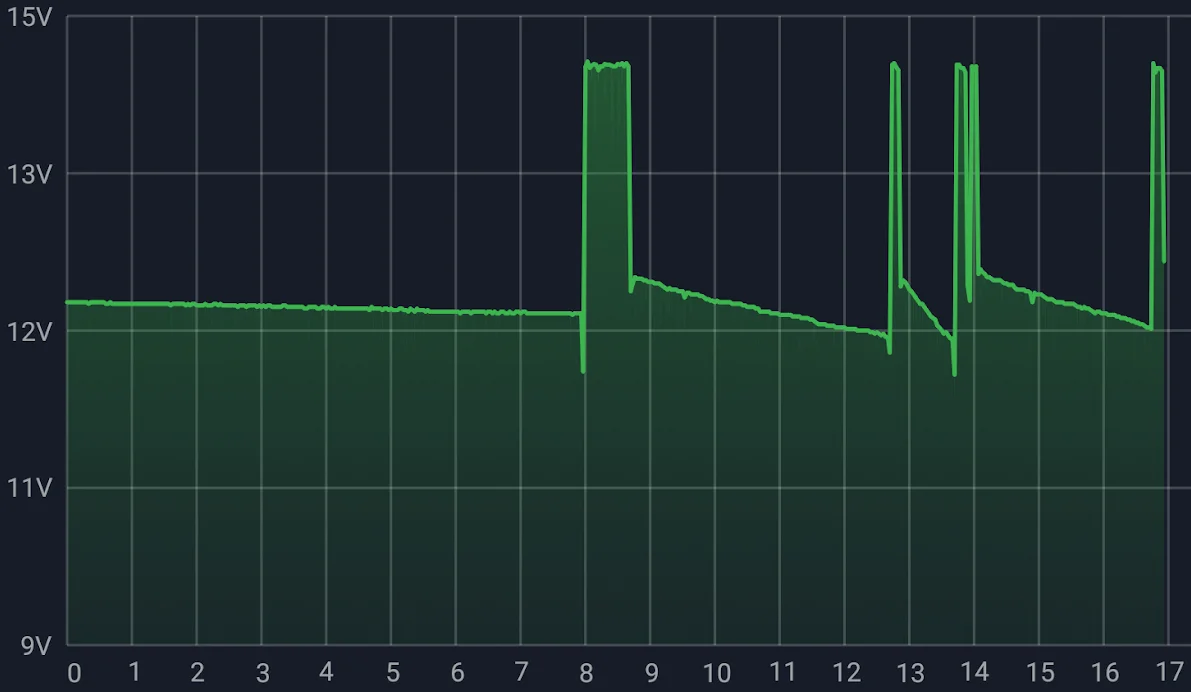

I bought a bluetooth battery monitor similar to the one suggested by @mentadent
Today was the first day of use, and already the results are interesting. Here's a voltage fluctuation caused by opening the doors to exit the car when I arrived at work, then locking the doors. The steady parked voltage was ~12.3V but it dipped to 11.7V just by opening the door for a few seconds.
I returned to the car at lunchtime, 4 hours later. The voltage was steady at 12.0V. Unlocking the car dropped it a bit, then opening the boot/trunk caused a drop to ~11.2V. There's another dip when I open the door to enter the car, and another brief drop as I press the Start button before the engine begins charging the battery at 14.4V .
I think this device will help me to understand my battery charge levels throughout the day, and inform choices regarding the type of parking modes I use and the voltage cutoff values.
Looking at the whole day (up to 5pm when I arrived back home)
- Overnight discharge without parking mode is gradual
- Driving to work via school (45min) charges the battery back up to 12.3V
- 4hrs low bitrate on the A329T discharged to 12.0V
- A short drive to the gym recharged to 12.3V
- Just 45min with both the A329T and S1 4K recording in parking mode dropped the voltage below 12.0V.
