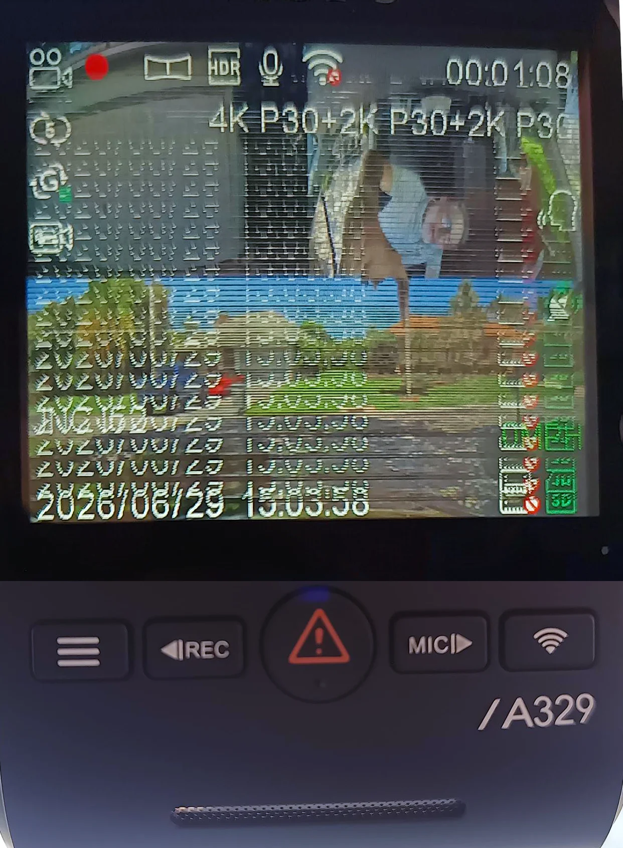

Disappointed to see this on my A329S display, implying hardware failure?
Purchased from Amazon on December 6, just under 7 months old, and in the car for about 6 months. It's Florida, just hot for the past few months, and parked under a shade tree almost all the time. What should I do about this?
Would you mind updating the firmware to test if it helps? If the does not help, I can claim a warranty for you.
