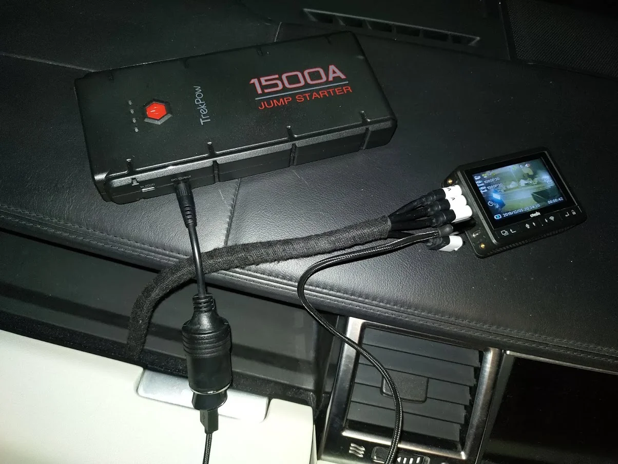

In order to check that it is not my car generating this noise, I have powered the K2S system from a completely separate battery. 12V jump start battery > 5V USB adapter > K2S
The problem is still the same :(
The issue therefore is definately with the K2S.
