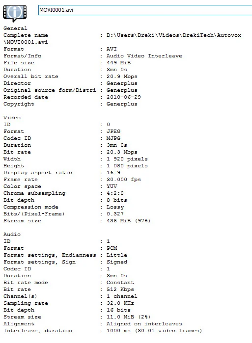

Sensor: Unknown
Processor: GeneralPlus
Video Format: AVI / MJPG
Maximum Resolution: 1080p @ 30 FPS
**NOTE** Only records 24 frames per second. 6 frames are doubled to reach 30 FPS which results in stuttering. More frames are doubled at night and in low light.
**NOTE** 1080p is interpolated / upscaled from 720p.
Bitrate: ~21 Mb/s
File Size (3 min): 400 - 500 MB
Audio Format: Linear PCM
Audio Bitrate: 512 Kb/s (32.0 khz)
