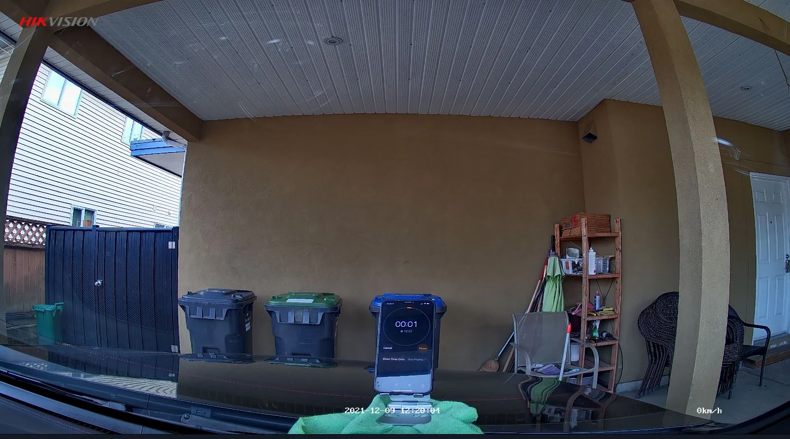

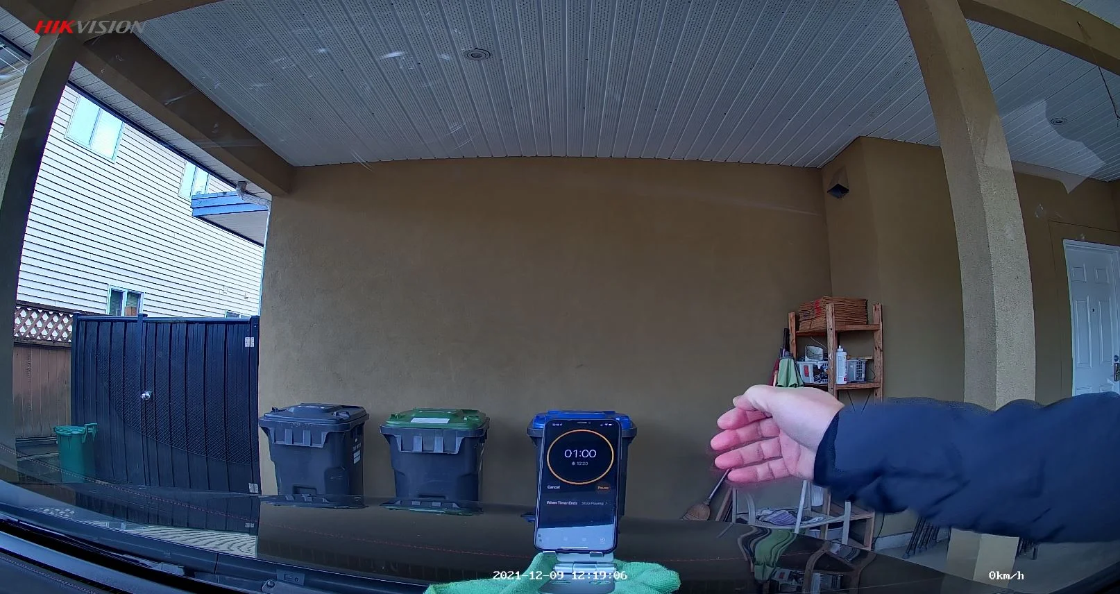

Do you use Battery or Capacitor on Hikvision Dashcams?
The Answer:
F6/F6Pro/F6S have no Battery or Capacitor as the size of dashcam body is too small to contain anything;
C6/C6Pro and C6S use supercapacitors.
Ok, I just did a testing on my F6S to see if this will cause video file loss.
what I did is as followings:
I formatted Micro SD card;
start counting 60 seconds down;
unplugged power at the last second;
took the card out;
export the video from the card;
here is the video
I was also told if you see the last video file loss, you just need to power up the dashcam again to redo indexing of the file.
Hope this helpful.

If you pulled the power, why is the video 3 minutes in length? We can't see the point where you yanked out the power because the video continued recording for another 1.5 minutes sitting on 1 second.
Also, what file format is the video recorded in, presuming there is no battery or supercap? .TS or JDR?
Now the question is what file format do these cameras use? As discussed above .JDR and .TS don't require batteries or supercapacitors. So I presume these cameras save in one of those two formats?
no They are not .JDR or .TS, but our encrypted format
preformatted with hivxxx . each file size 256MB.
so you cannot delete any footage without being noticed before you export those files.

That is an interesting video, well not the content of the video but the technicalities [emoji3]
Am I right in saying that the clip files are written as pre formatted and pre sized containers which would account for all the file sizes being exactly the same?
Video clip data is then written to the pre formatted container, this would explain why the clip carries on but with the last frame that was written by the cam being displayed as a static image.
An interesting method, I’ve seen this method used previously to guard against data loss.
When you say encrypted, does it need a special player in order to playback the clips or do they need to be converted?
I wondered that above. Why the video stopped at 12:20:05 but continued on for the total 3 minutes just displaying the last frame. What you said makes perfect sense.
Seems his company has created their own proprietary file format.
