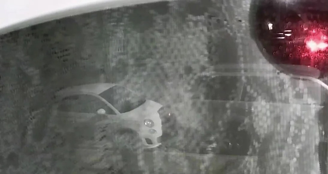

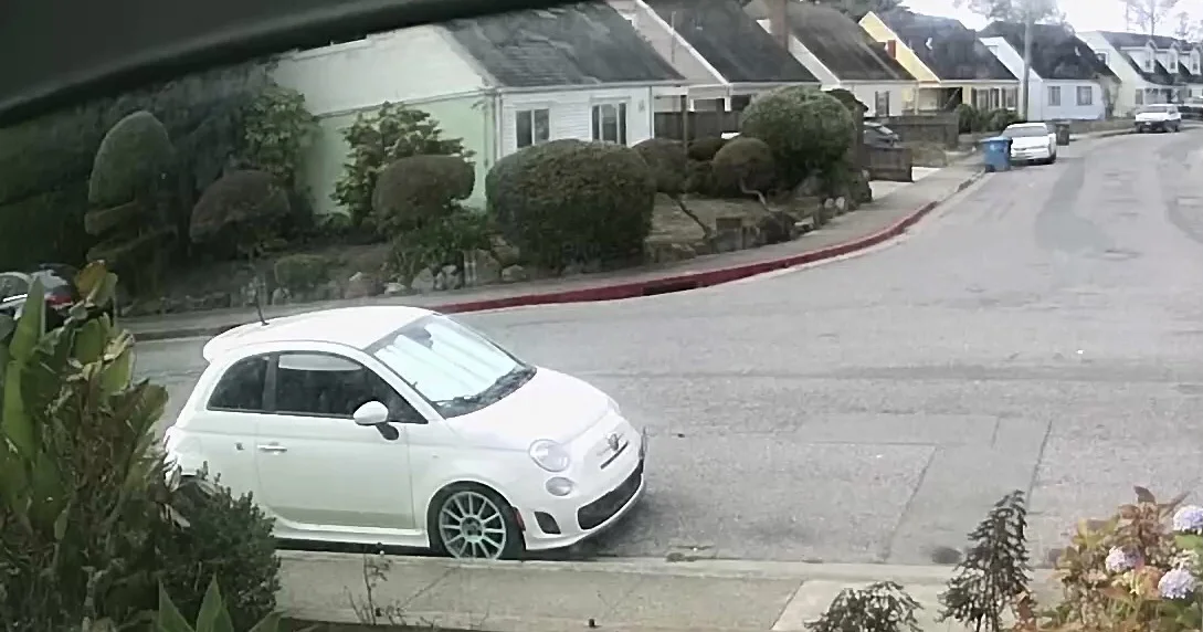

i have a yi home camera pointing outside from my front window. be aware that you will have a ton of glare anytime your interior lights are brighter than outside. your daytime footage should be just fine but your evening footage will have a lot of glare when you have your lights on unless you build some sort of box or shield around the camera.
here are some crops of the same area for example:

On this camera, is there a way to turn off the IR lights at night so that it doesn't reflect off window? Is there an Yi App to watch in real time similar to the Nest? Thanks

yes. I have it turned off because it's facing the window. and yes, there is a pretty decent Yi app where you can remotely monitor it in real time or playback video from the cloud or the SD card.
