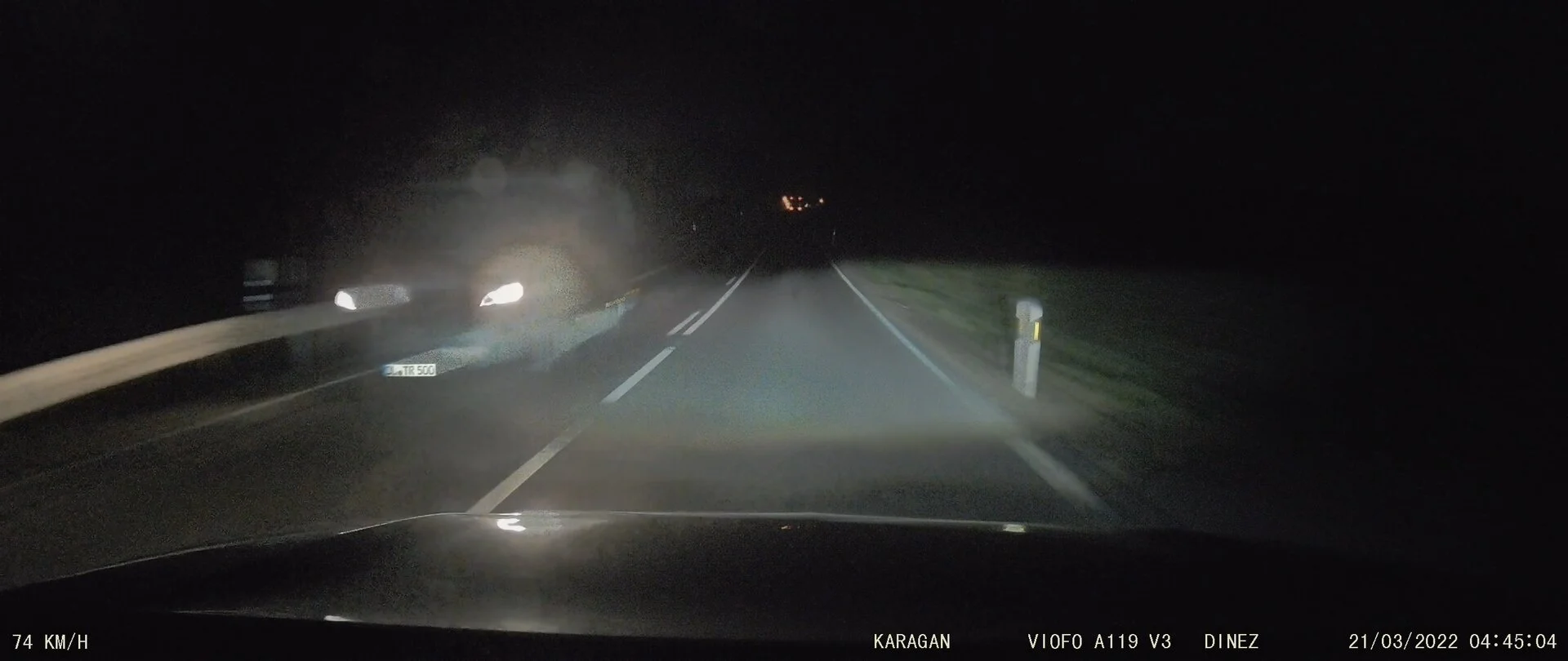

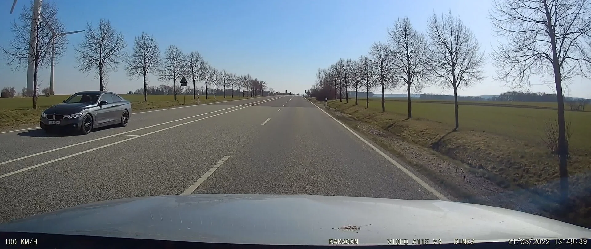

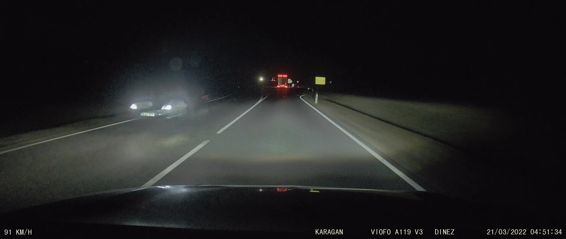

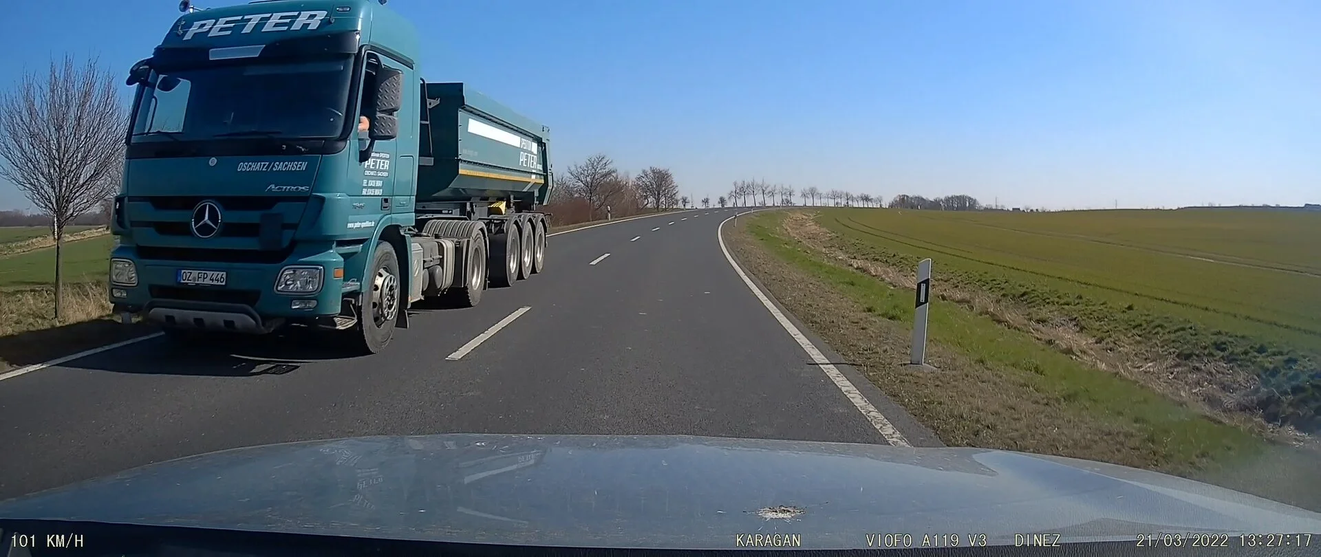

@Karagandinez
The above day screen capture at 101kph is far better, sharper, than the ones I was getting at even 80kph under 2.6t
I wonder why ?
