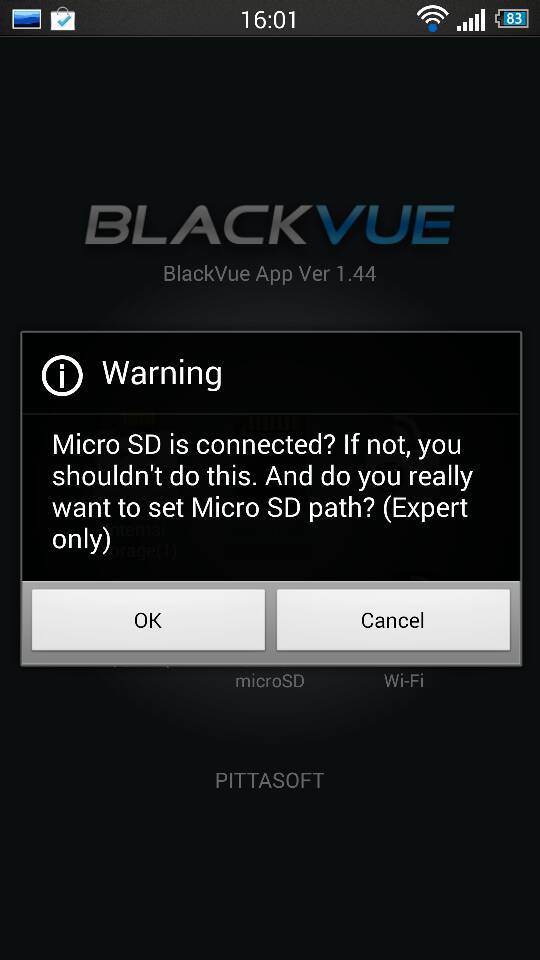

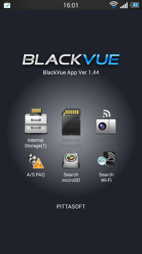

But to overcome your sdcard issue.
Do the following as it solved my issue.
Open the blackvue app.
And tick the option "search micro sd" in the main home screen.
Tick OK...
Then select your sdcard location.
My phone will prompt me these options.
Other devices will maybe have other options.
Tick OK again
If all goes well then you should be able to push the footage to your sdcard...

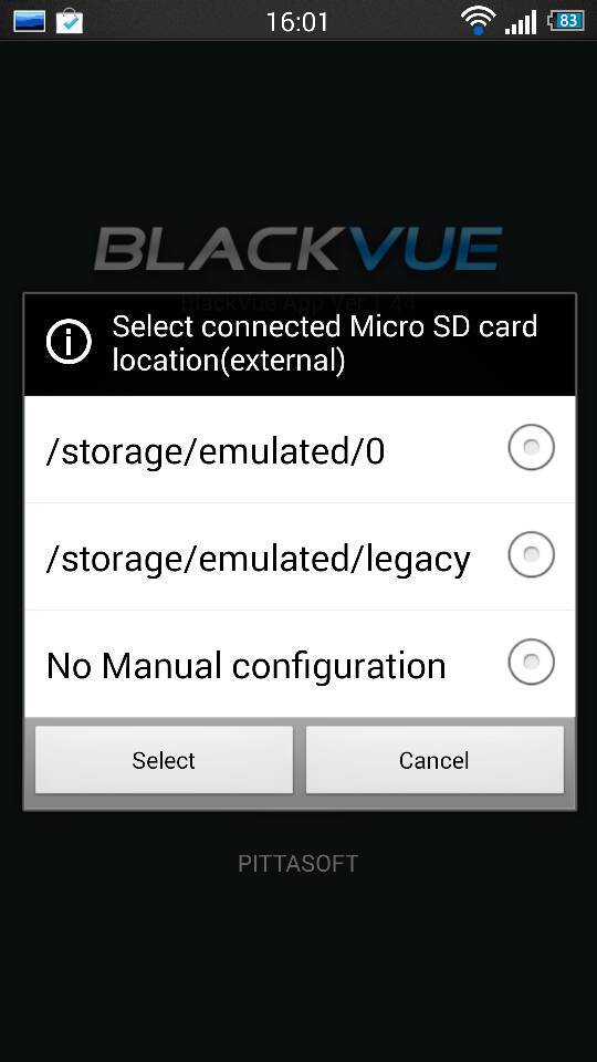

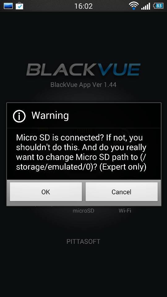

Tick OK again

When selecting the microSD path, are you referring to /storage/emulated/0?
I tried selecting and nothing happens.
I'm on Android 4.2.2 and Blackvue app Ver 1.50
