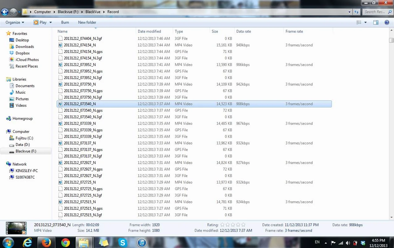

just check, all authentic and nothing fake about it... really regretted buying this camera... camera is giving me more strange problems..like bitrate dropping all the way to 900kbps and fps dropped to 3fps... out of no where...and best luck of all, when that happened, an accident happened and thus, the whole video was so choppy.
How and what did you check it with.
It sounds like a software or power problem as you would be extremely unlucky to get two dud cameras in a row I would be looking elsewhere Car, Connections, a battery on its way out or more likely the SD card
How did you format it and on what PC or a Mac.
It isnt always the camera. Try connecting it to the ciggy socket bypassing the power magic and see if it works OK I still think its a faulty installation
Post your camera settings and we will look at them

local dealer checked all the connections...everything was ok...SD card was replaced with my own sandisk 32gb (real one..checked alrdy)..stll same prob..
Format the card thru PC using Sd formatter.
Look at the weird frame rate and a sudden drop in data rate and frame rate.

Screenshot 1 for Frame and Data Rate.jpg Screenshot 2 for Frame and Data Rate.jpg
