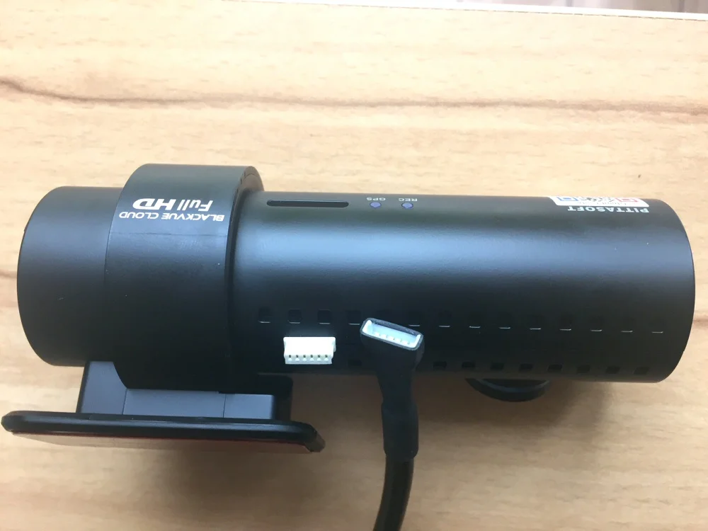

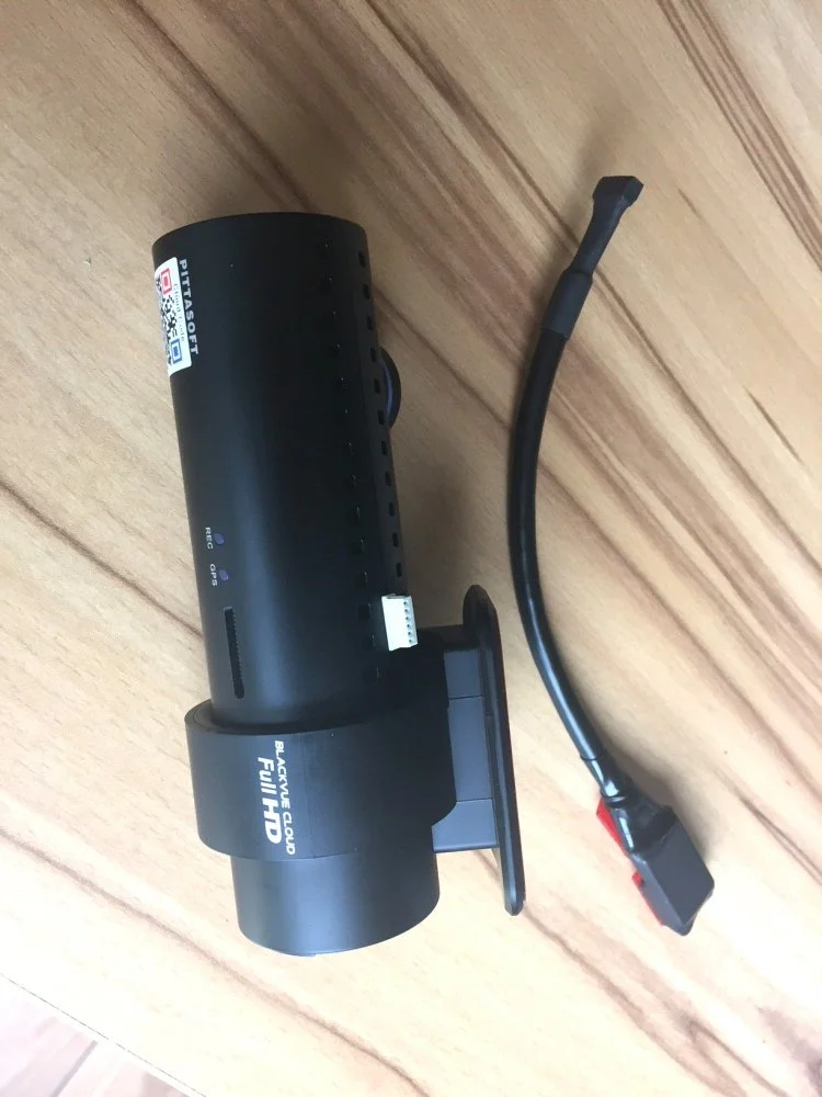

I had a problem with a client that a Tesla S with Thermal windscreen glass and received with great difficulty the satelitte with GPS integrated in BlackVue DR650S 2CH
So I tried to find a solution and it seems to work.
So just open the box and take the GPS receiver. I position the cable so that it can be output in the case.
I ordered a mini JST x6pin male female cable
Obviously it blew the warranty so be careful what you do
