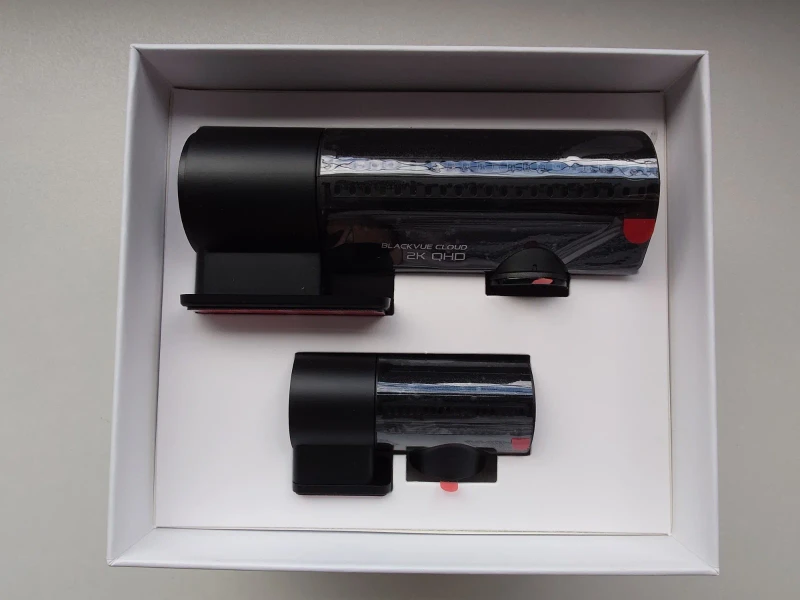

First impressions - BlackVue has completely redesigned their retail packaging.
Gone is the previous brown box with black/blue printing on it.
We now get a white box with full colour. This actually reminds me of Viofo's packaging.
I also note the smaller box size means the reduction of included items.

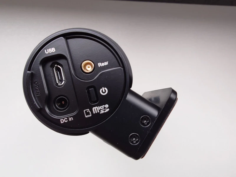

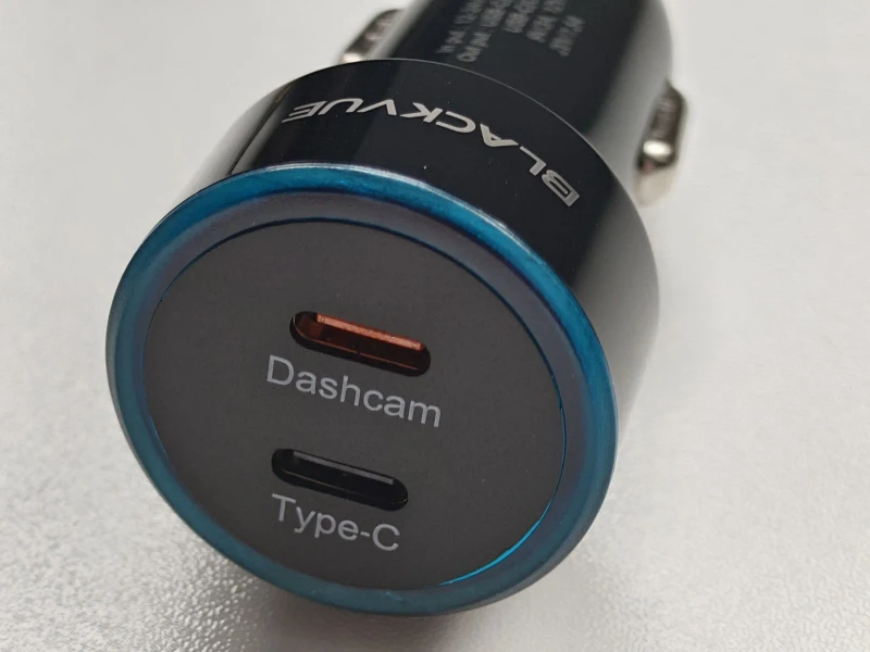

The dashcam only only comes with 1 form of power supply, the 3 pin jack connection to USB-C cable with cigarette lighter adapter.
**Gone is the normally included hardware cable**
Here is the box and what's included;

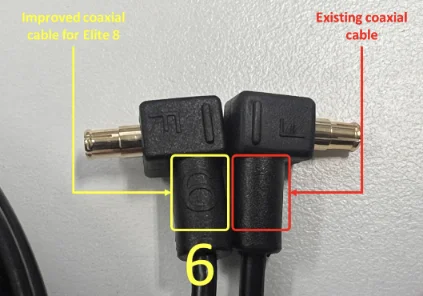

The pre-release brochure of the Elite 8 also stated that they're changing the rear cable to (CC6G-6) high speed rear cable.
On first impression, the cable looked identical to previous cables, so I reached out to BlackVue for clarification.
They confirmed that they've upgraded the rear cable for better interference protection and higher speed.
They sent me this comparison to note the newer cable is marked with a '6' on the front end of the cable (no marking on the rear end).
The good news is that the previous rear coaxial cables still work, so if you're replacing an older setup - the cables are interchangeable - but for better protection against interference or rear camera dropouts, they do recommend upgrading to the newer cable.

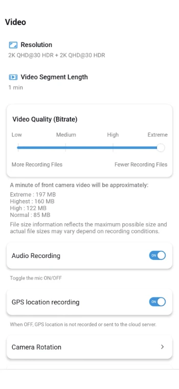

Here are some screenshots of the dashcam settings.
Things to note;

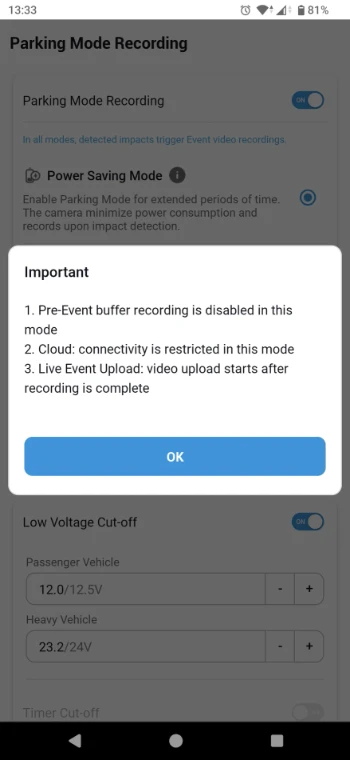

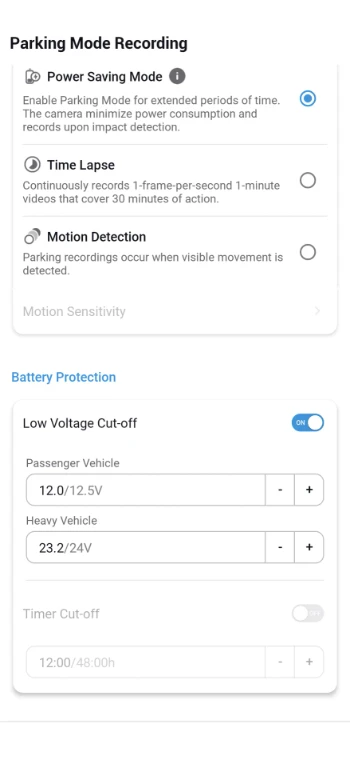

- Parking Modes, now included low power parking mode - the camera must be hardwired for parking modes to kick in - although no hardwire cable is supplied with the camera
- There is currently no 'hybrid parking mode' like Viofo offer, where you can set one type of parking mode for a set period (ie, time lapse for 2 hours), then switch to lower power parking with non-buffered impact detection. I have suggested this to BlackVue and their R&D are considering in a future update
- WiFi hotspot has now been increased back to 3 local hotspot connections (it was reduced from 3 to just 1 in BlackVue prior model range).

The second issue; (UPDATED WITH BLACKVUE RESPONSE)
The dashcam will not go into ANY parking mode state when using an external battery pack and connecting the camera to it using the standard power cable/cigarette lighter adapter.
I wondered if this was a change due to the new power cable/separate adapter - but it's exactly the same with the older cable from the X series dashcams.
For some reason the camera is not going to sleep/timing out when stationary and going into parking mode. It continues to record at full recording state continuously.
All prior BlackVue camera would auto switch to parking mode, even when powering with cigarette port after about 15 minutes of the vehicle being stationary.
Hardwiring the dashcam switches it to parking mode instantly.
Unfortunately, the Elite 8 does NOT come with a hardwire cable, so I've been unable to connect this up to the battery pack as hardwired - and I don't have a spare from previous, so I've had to order a new one separately.
I've reached out to BlackVue about this issue - and they confirmed that the Elite 8 does NOT use G-sensor for parking mode detection, so it MUST be hardwired for it to have any parking mode.
Previous BlackVue cameras using g-sensor to trigger parking mode after about 15 minutes of the vehicle being stationary - whereas the Elite 8 will only use ignition (hardwired by either OBD hardwire cable, or fusebox/battery pack hardwire cable).
Whilst I was disappointed with this initially, as previous models did have this feature, and the dashcam does not come with a hardwire cable - after thinking this over, I can understand the logic behind it - as being ignition based is the only accurate way of entering parking mode - as oppose to being stuck in traffic and the dashcam thinking it's parked.

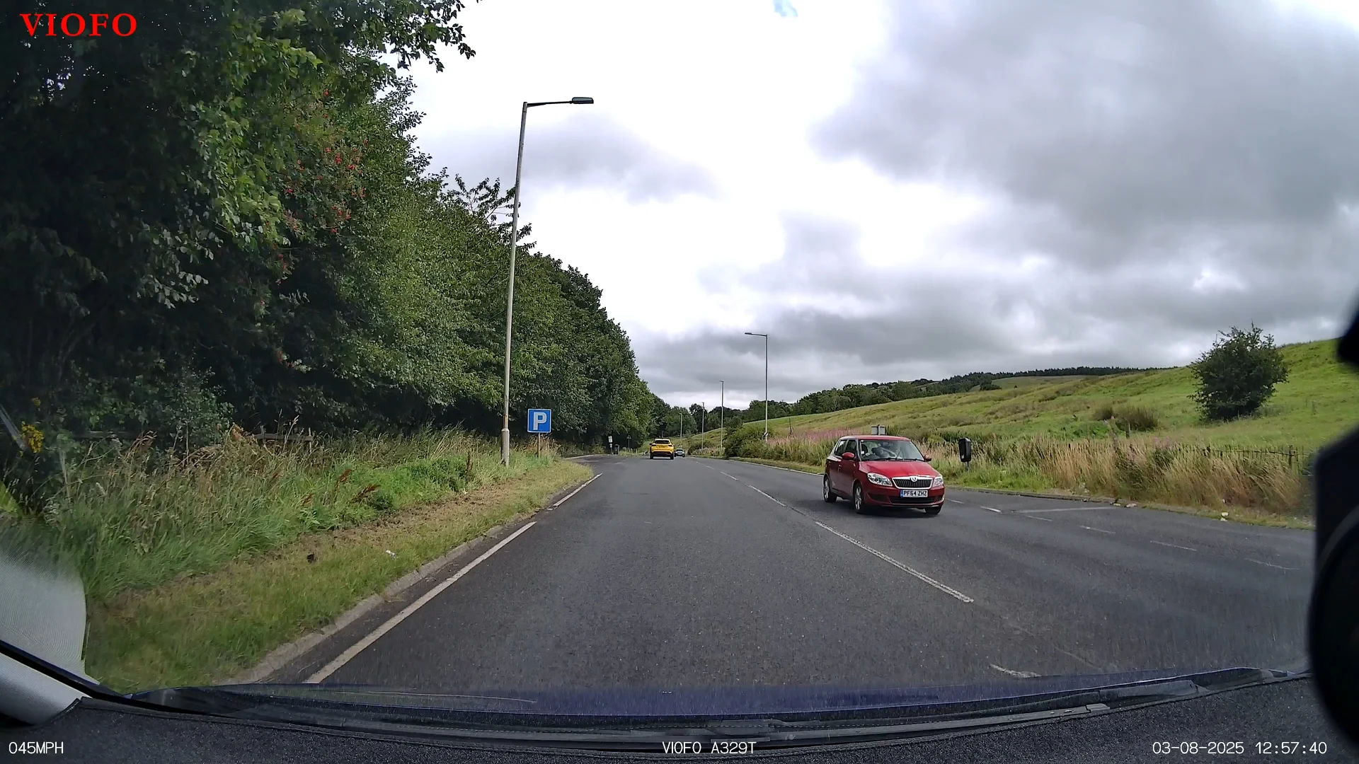

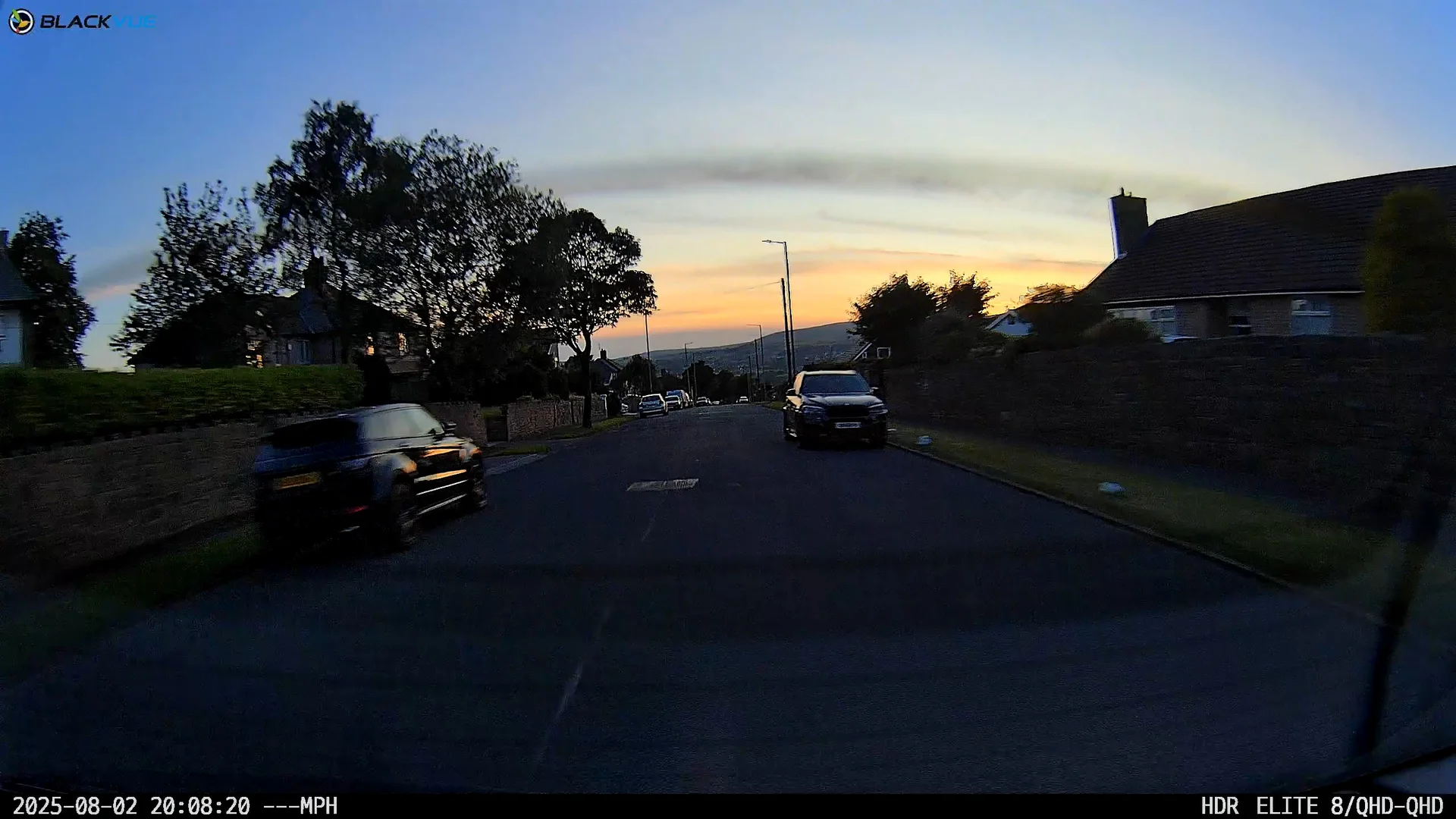

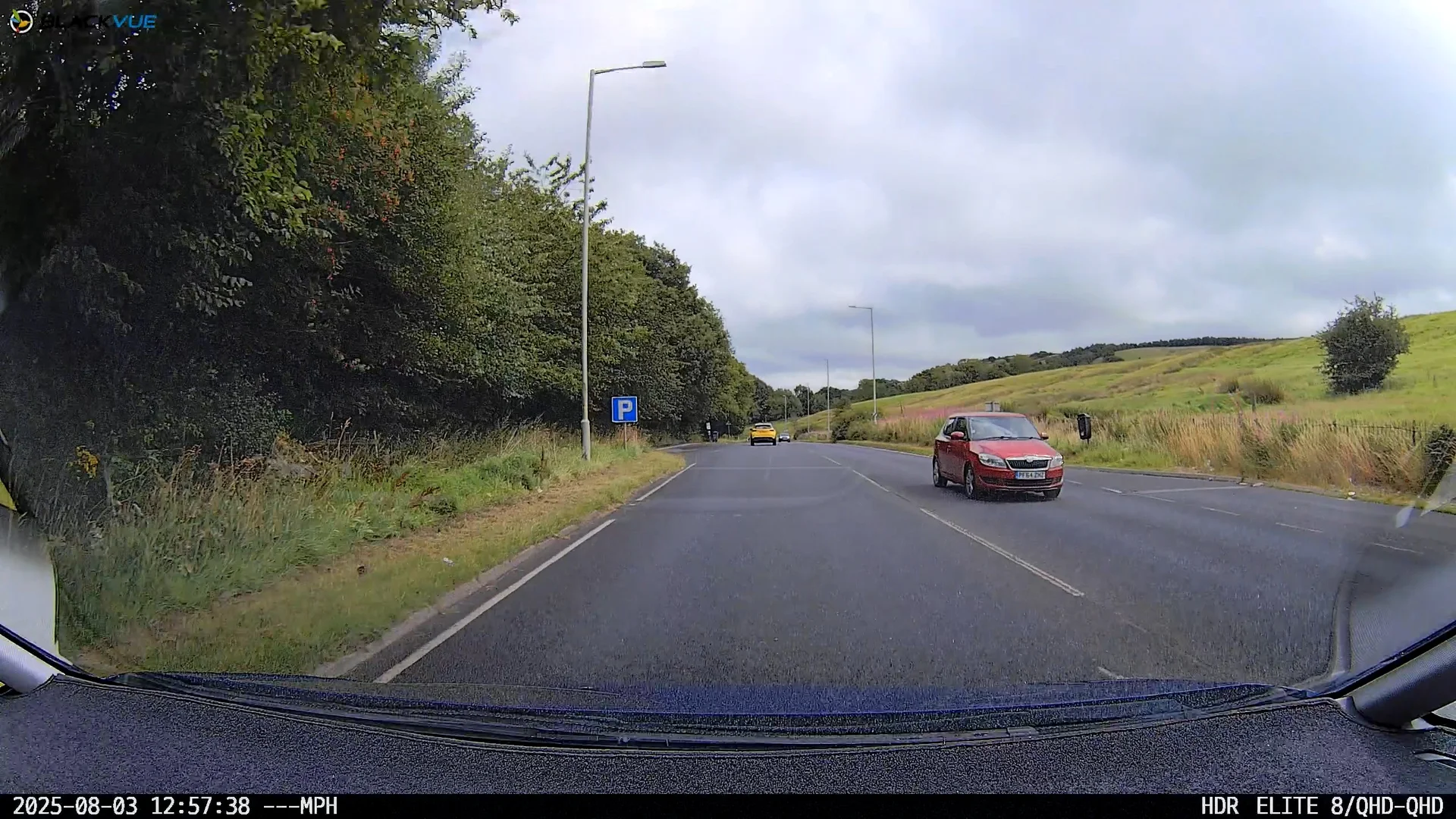

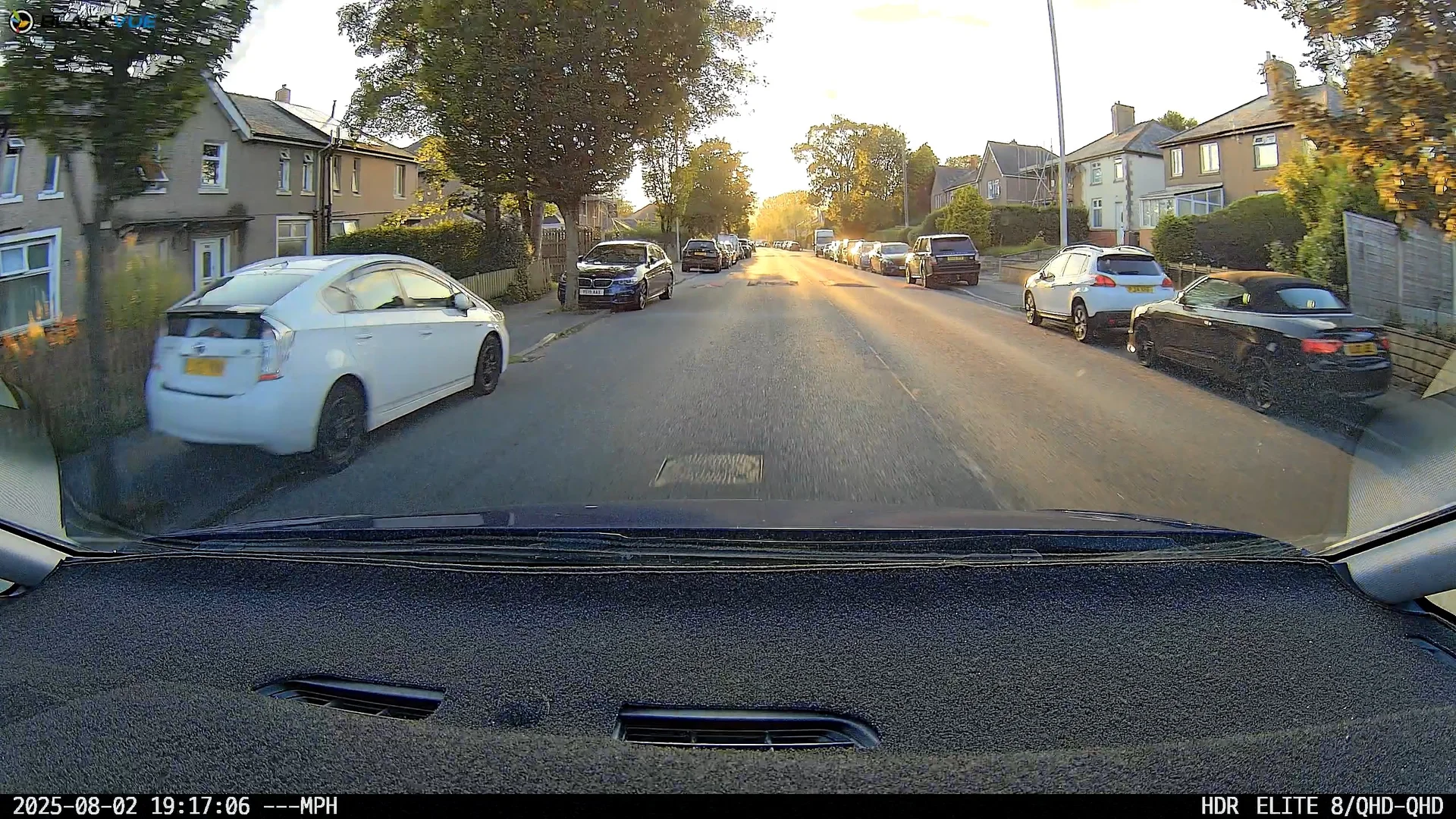

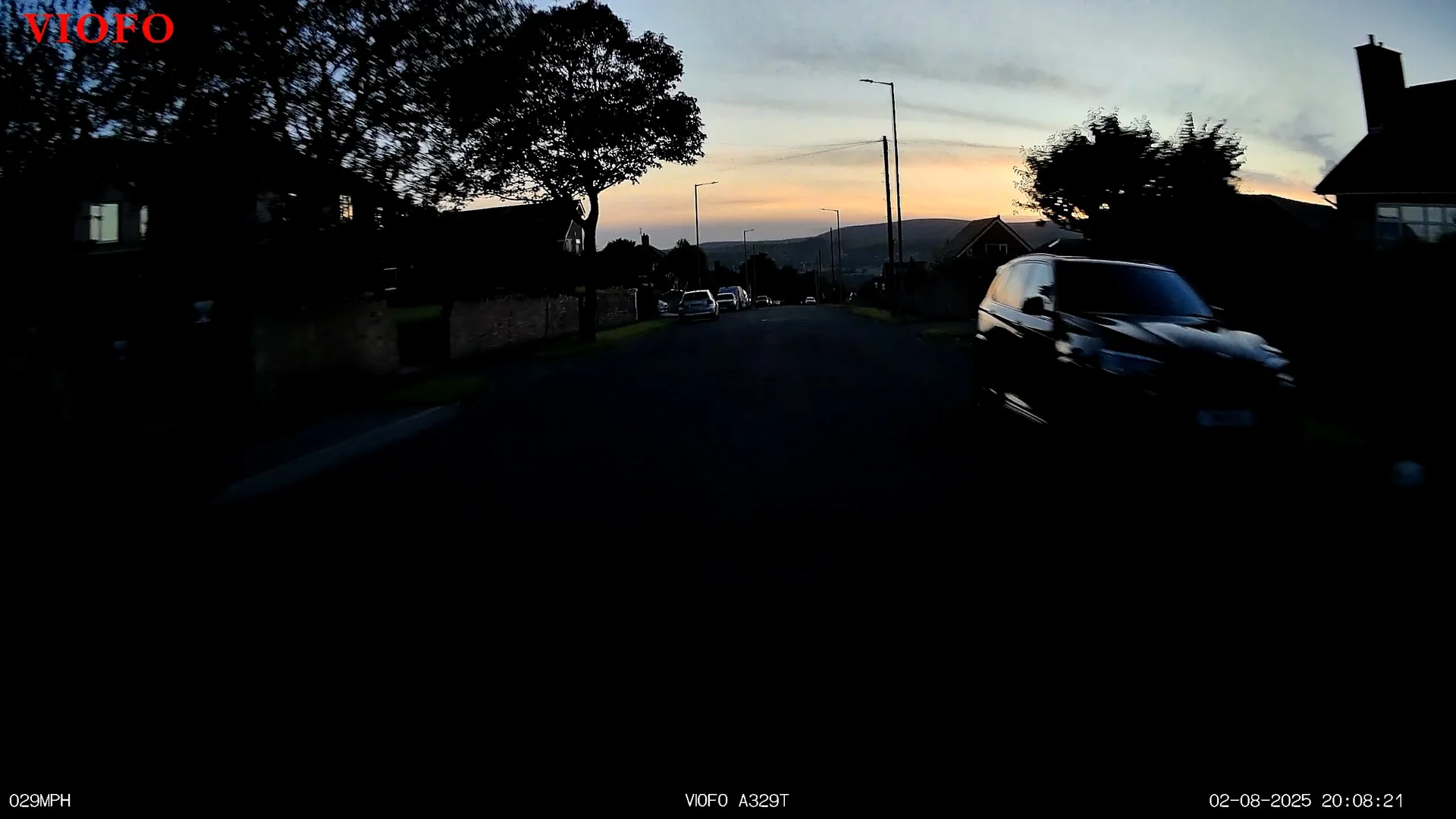

So here are some sample comparisons.
The BlackVue Elite 8 Vs Viofo A329T
(Obviously it is unfair to use the actual telephoto camera as comparison, so I've just compared the front and rear cameras.
(Please ignore the times displayed in the separate dashcams, the Viofo weren't set correctly due to pulling out the SD card in parking mode and plugging the camera in without the card rest the time to 00:00 and I hadn't noticed to set to correct time - which I've realised after the fact, and the Viofo HDR modes which turn on/off at certain times - whereas the BlackVue has HDR on all the time - so I'm having to re-do the night time footage for a fair comparison).
Please also note the Viofo A329T has CPL filters on both fronts and rear - but the BlackVue Elite 8 doesn't have CPL filters fitted - so some of the slight differences may be exacerbated by the filters/lack of filters.

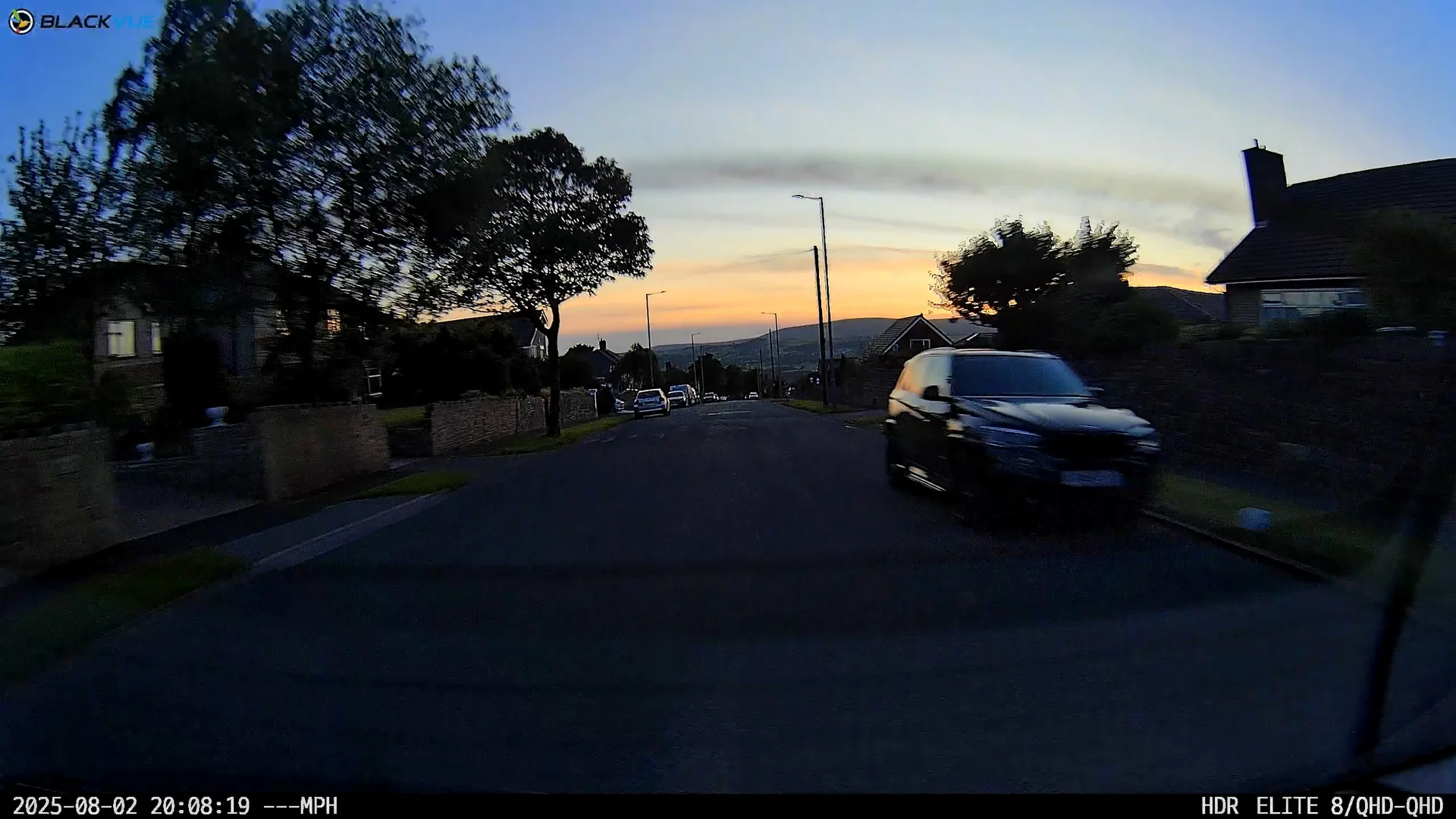

Daytime;
Early evening;
A little frustration about the BlackVue logo in the top left of the footage - they need to put a white border around the edge to make it clear.
Currently in blue sky daytime - the logo just says "Black"
And in black night time, the logo just says "Vue"...

I've also heard back from BlackVue about a number of things;
They've confirmed that the dashcam does not use g-sensor for parking mode detection, as that gave false parking mode issues (in traffic and enter parking mode, or taking too long to enter parking mode when actually parked) - so they opted for ignition only based parking mode, meaning the camera must be hardwired - so either hardwired to a battery pack, the vehicle's fuse box or OBD2 port.
I can understand the logic behind it - just disappointing coming from previous models that did use g-sensor parking detection, and also included hardwire cables, whereas the Elite 8 does not.
They also confirmed the rear coaxial cable has been upgraded - although previous cables are still compatible.
The cable has been upgraded for better interference protection and higher speed.
This is to help progress to future models that have higher data pass-through, so as a 4K/4K model.

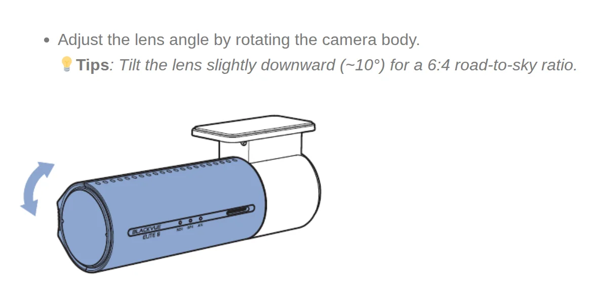

Of course there’s always exceptions like a manufacturer recommendation.
The BlackVue recommended lens adjustment is 60% Road & 40% Sky.
As far as Viofo’s recommendation, well there is no “official” recommendation, but I’ve been informed by people smarter than me to set it at 50/50.
Except for telephoto, (60% Road / 40% Sky).

It looks like 12% Road needs to be added to obtain BlackVue’s recommended 60% Road & 40% Sky.
Now comes a decision for you to make about the Viofo.
Should you “match” the Viofo to BlackVue’s 60/40, or should you run the Viofo at 50/50?

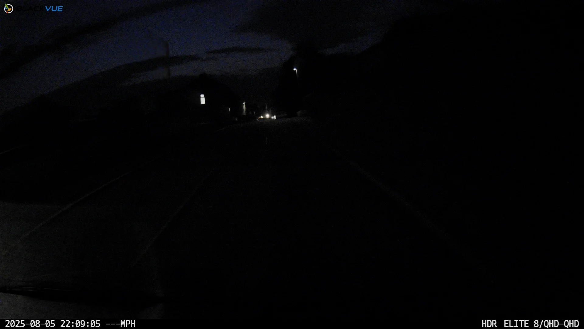

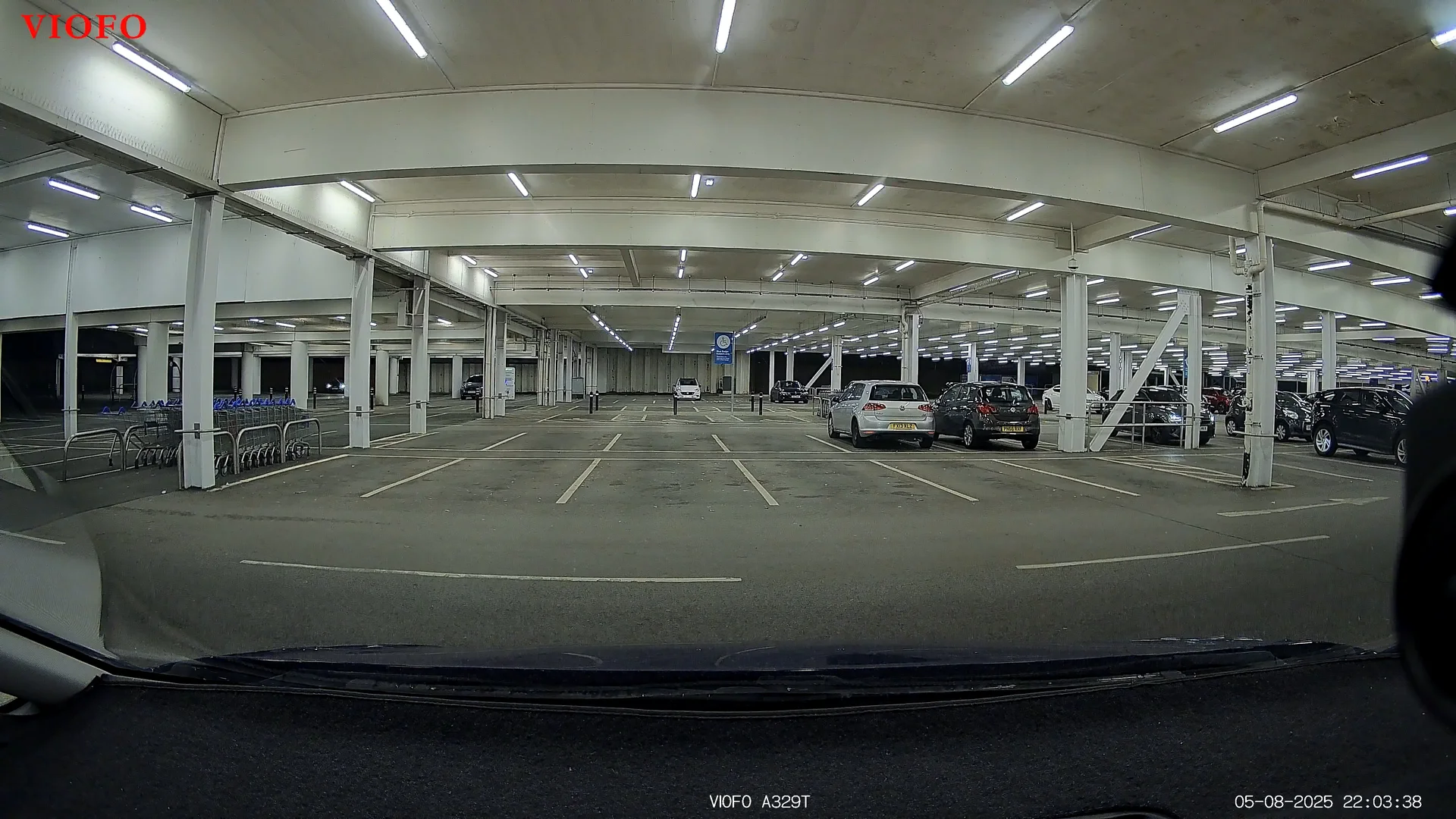

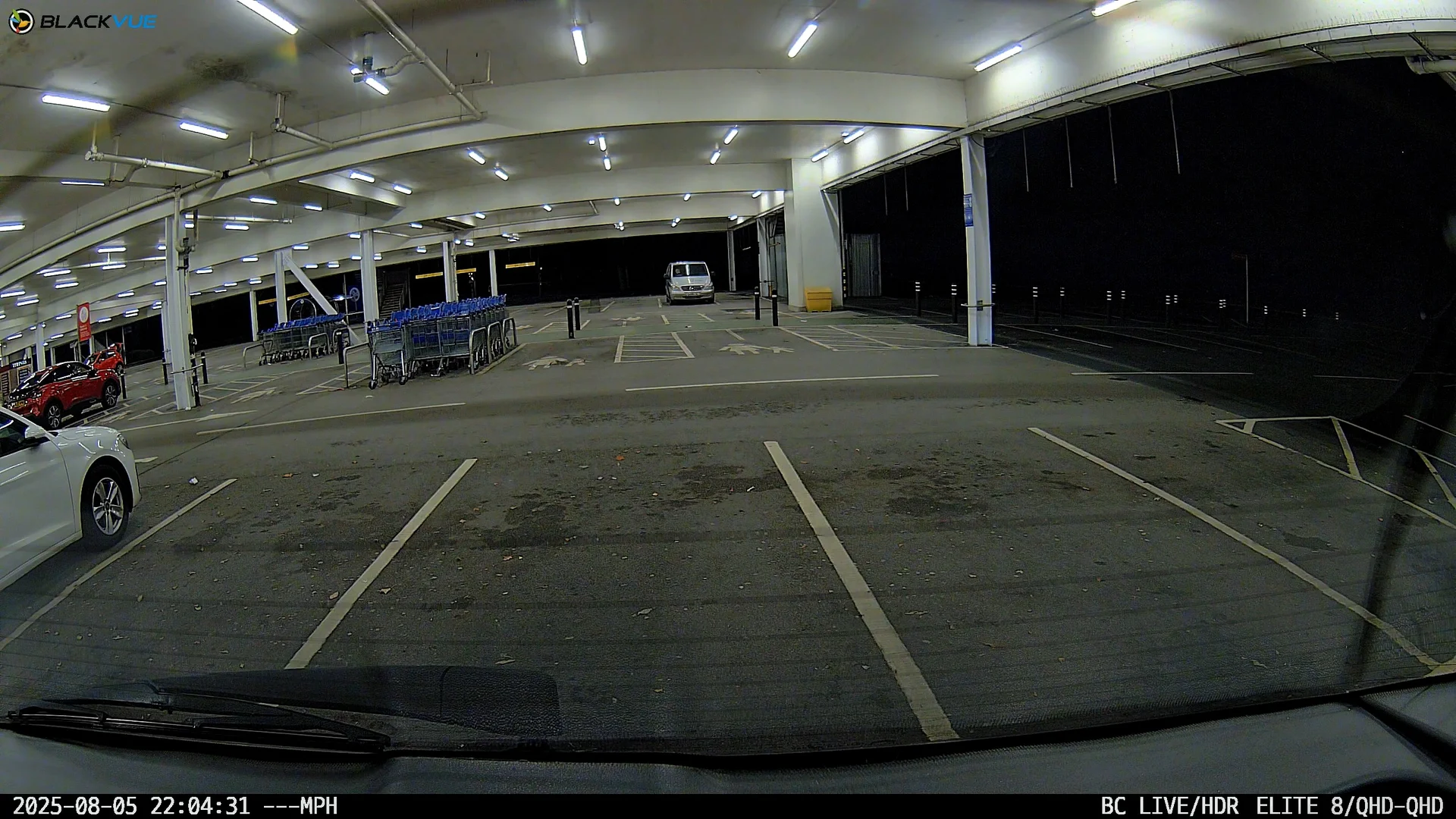

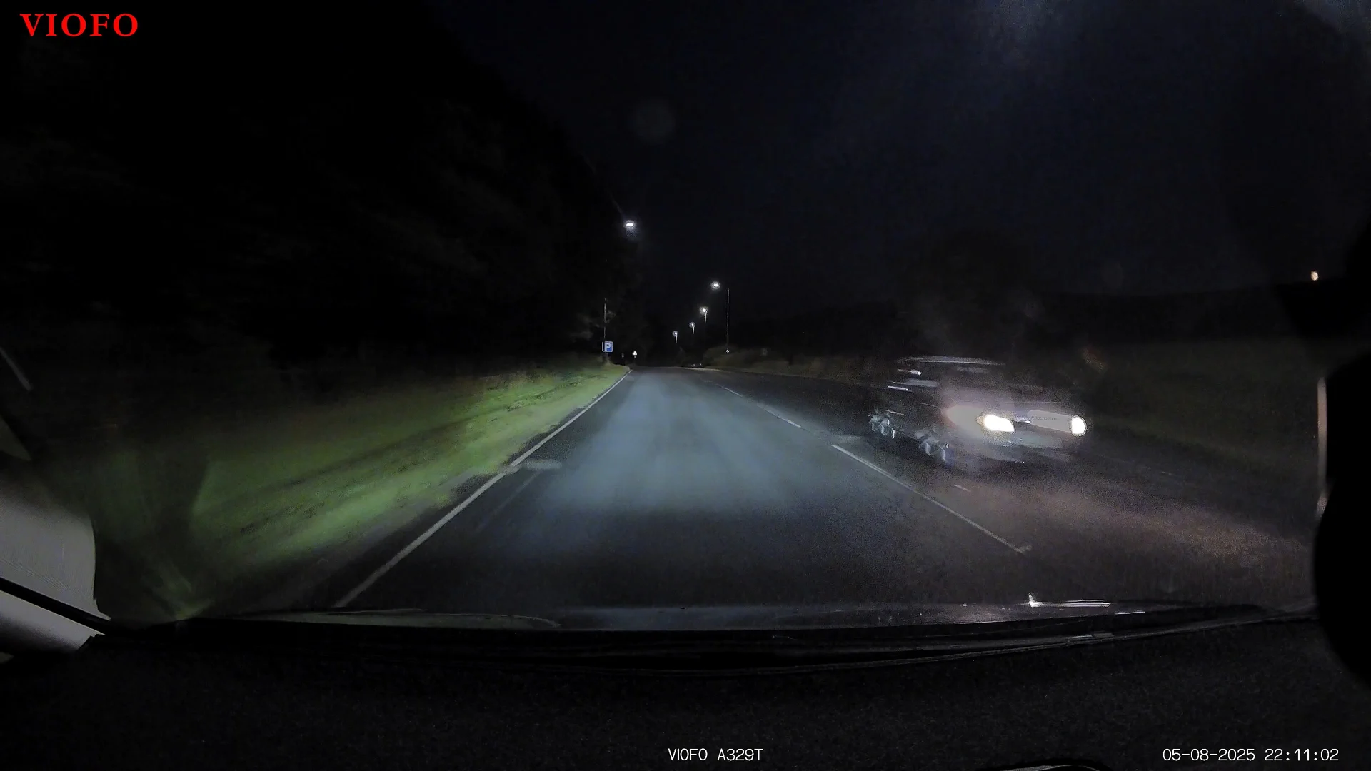

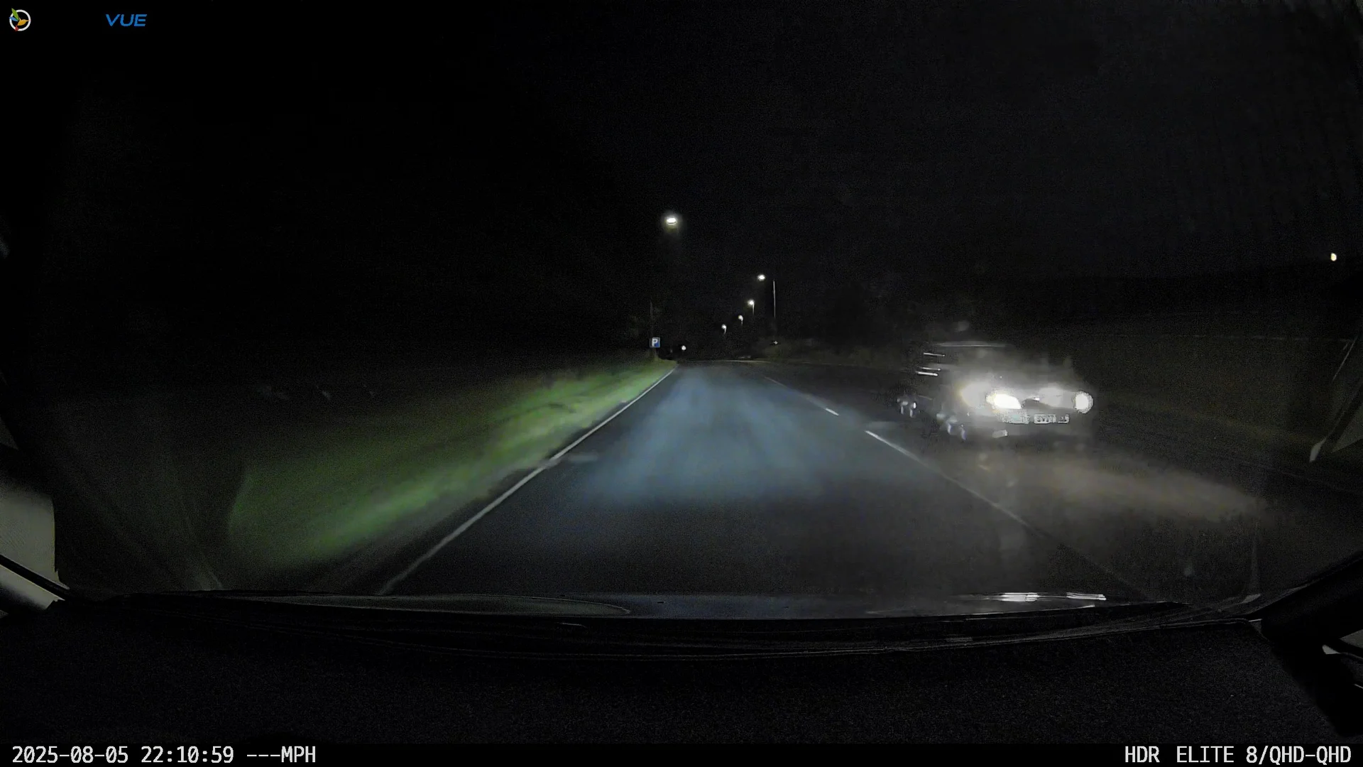

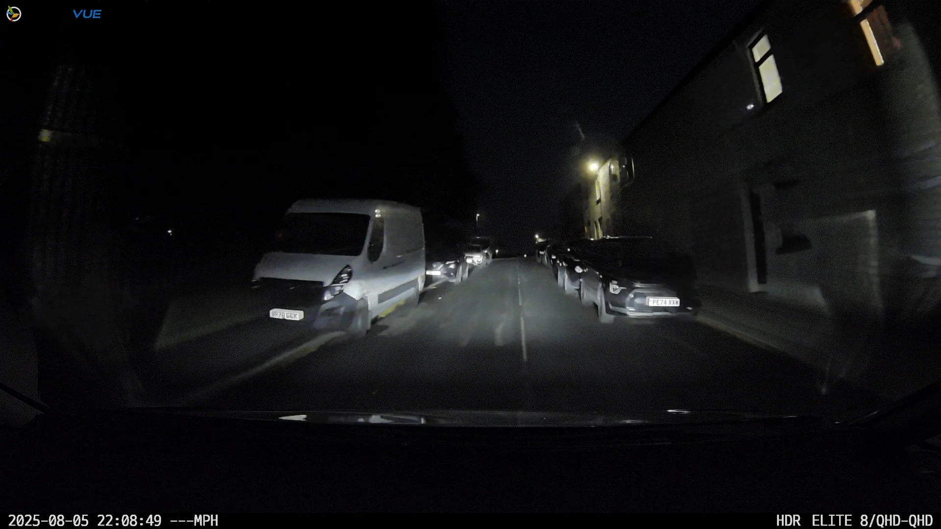

I have now adjusted both front and rear cameras so they're between 50-60% road vs sky as per your recommendation. I thought that was a fair balance between the two.
Both cameras have HDR enabled
Both cameras have NO CPL filters on
I live in a very rural area with very little street lighting and county lanes - so not the usual city night time footage where everything looks nice and bright and crisp.

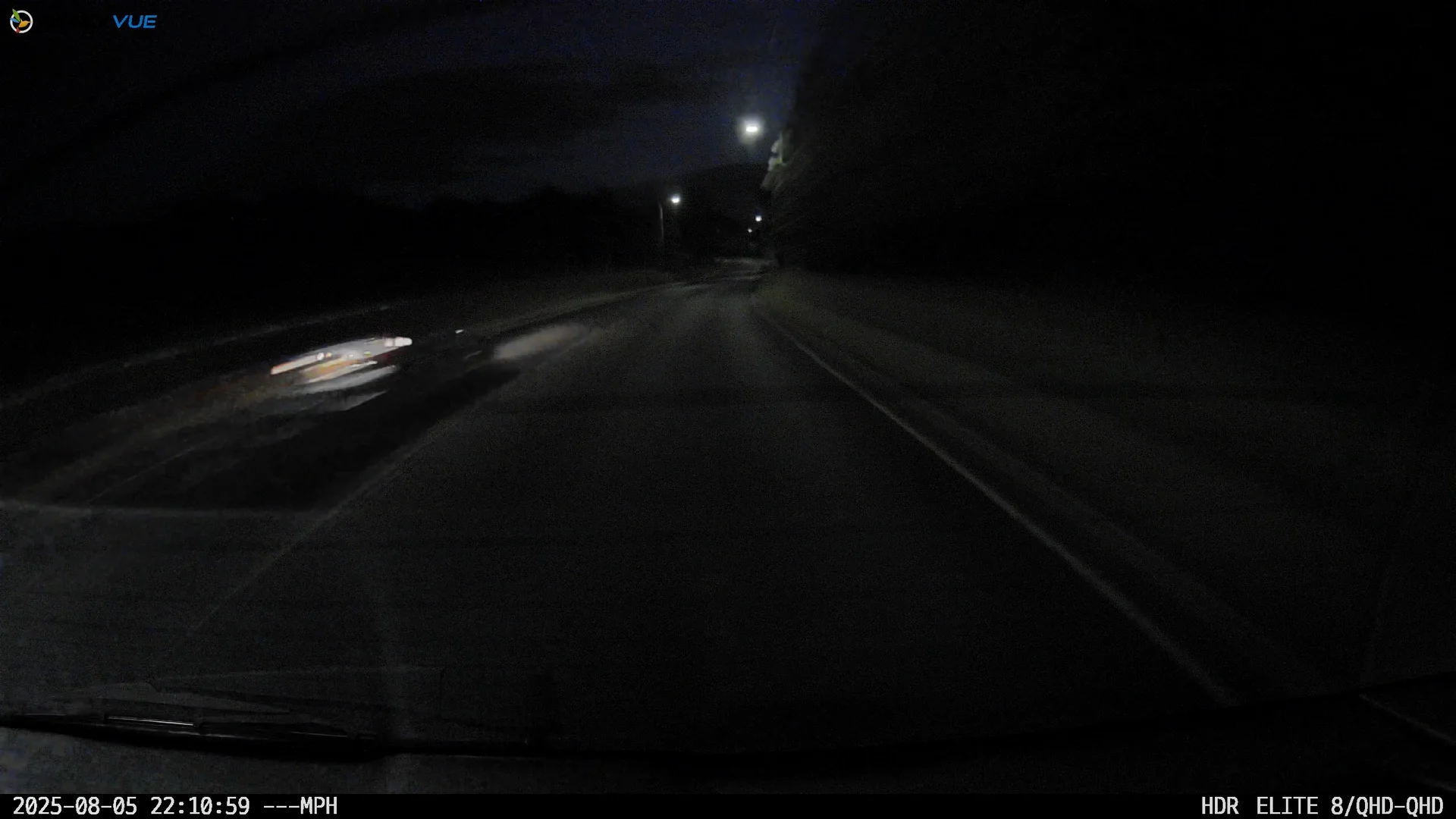

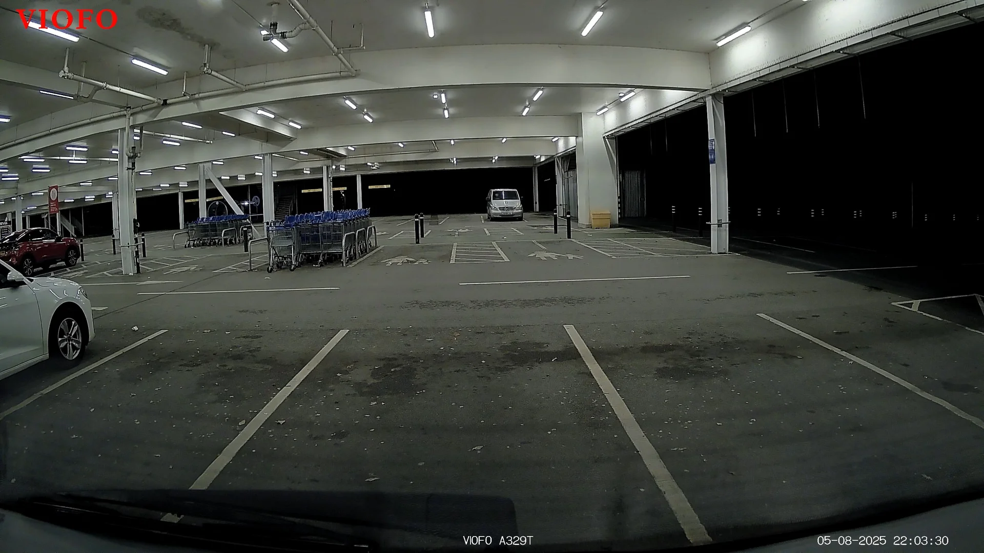

Things I note;
The BlackVue Elite 8 - 2K rear camera has a wider field of view compared to the Viofo A329S/A329T - 2K rear camera.
Despite very poor lighting conditions where plate reading is at almost zero - both camera are reasonably close in comparison.
These are probably going to be some of the extreme night footage samples you'll see as they're pretty much mainly black - but here they are for comparison anyway....
Perhaps it is how the pictures were saved and posted, but that first set night photos look like the glass needs cleaning. Looks like to me, the headlamp beams are scattering their light off a thin film on the glass.
It had been raining on and off, and I'd used my wipers prior, but the windows were clean when I set off - but all the images where whilst it wasn't raining.
You can see the clear glass in the car park images.
There are only 8 minutes difference between all the various examples.

I'm confused, usually it will display "HDR" in the text stamp at the bottom of the recorded footage when HDR is enabled, and be absent when it is not.
Have you disabled the HDR logo on the Viofo footage?

Nice work putting those screenshots together.
Yes sorry - I have 'Resolution' display marker turned off, so it doesn't show the HDR or 4K marker on the screenshots.
I prefer a minimal look on dashcam footage, and I normally turn off the company logo, GPS marker display, and camera name stamp.
I had turned some of these back on so it's clearer which camera is which in the images above - but I'd forgot to turn on the resolution image marker on the Viofo. (3rd screenshot, 5th option from the bottom).
Here are the settings on the Viofo.
HDR is set to Auto on all 3 cameras (front, rear and telephoto). HDR timing is set to turn on at 5pm until 7am (Viofo's recommendation).
There is no option to turn the display marker off on the BlackVue.
VIOFO A329T camera settings
Another rookie mistake from a testing point of view having the display marker turned off - but as you can see the BlackVue HDR display marker is turned on and the footage samples are almost identical between the two cameras - whereas you'd expect a difference between the two if one was on and the other off.

I also wonder whether this new extended Parking Mode could/will be added to the 970 Plus cameras via firmware..?

The DR970X Plus is a long standing camera having been out over 12 months. It's recently had an update to HDR, but current firmware still shows it to having teething issues.
I'm unsure if they'd add in low power parking mode as a firmware update - in the same way that Viofo haven't done that between A329 and A329S/T as it's a sale technique for newer models. Maybe a year down the line they may add it if possible.
