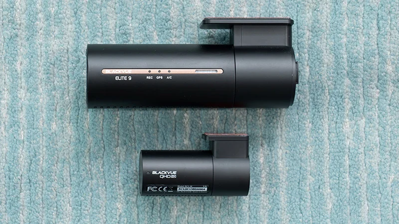

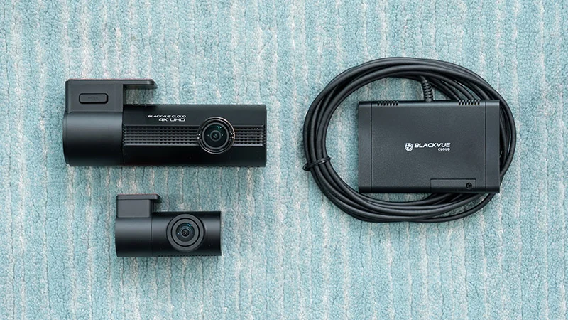

So I've had an Elite 9 on hand for a little over a week. Time to share some initial impressions.
So far I've really been liking it over the DR970X Plus line. I'm seeing better clarity and less grainy noise compared to the 970, presumably due to the updated processor. Impressively, the results are much closer to what I'm used to from dashcams like the Viofo A329S and the Vueroid S1 4K and thus I don't feel like I need to run another dashcam alongside a Blackvue to get both good cloud features AND good video quality. This one is finally giving me both all in one package which is great.
Here's some sample footage from both the front and rear cams.
I'm also liking the low power parking mode and quick startup times like we had with the Elite 8. Also unlike the Elite 8 which is 2K / 2K, this one is 4K / 2K which I think is a better way to go when spending top dollar. (Elite 8 2CH 64GB is $400, Elite 9 2CH 64GB is $495).

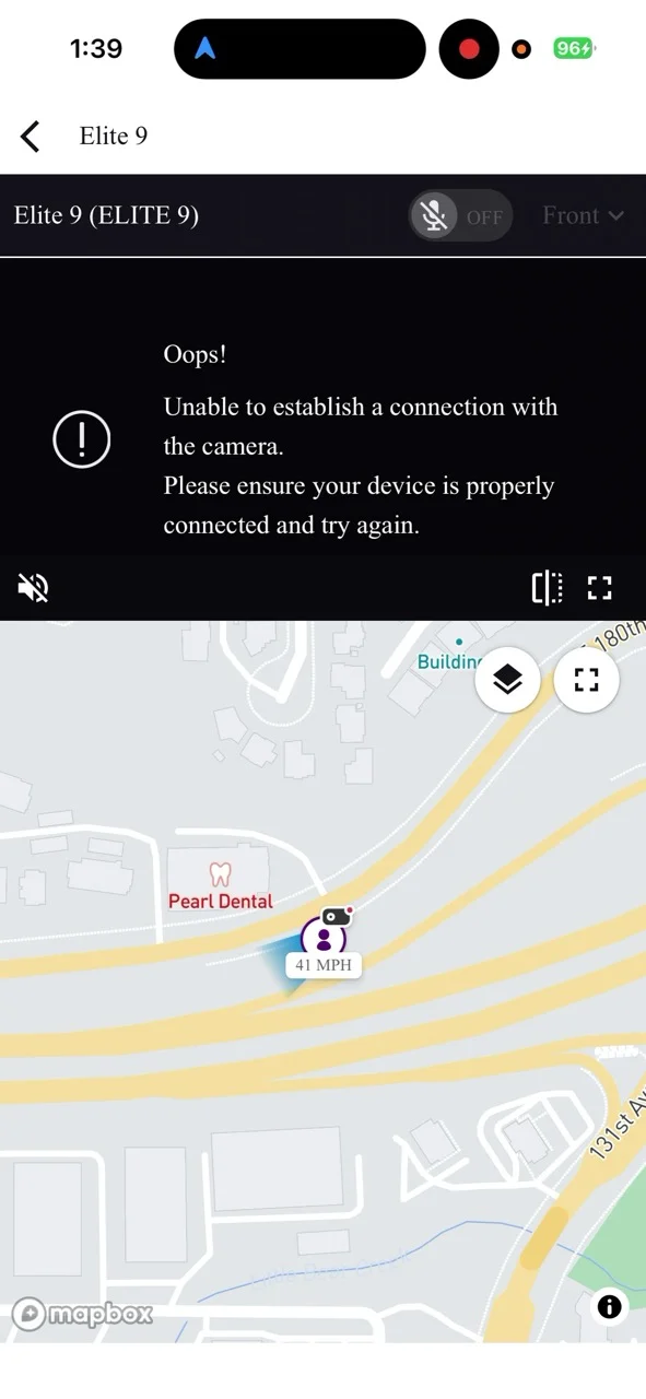

The cloud stuff is pretty similar to the previous line, but I've been having a bunch of issues getting livestreaming working properly, both over WiFi and with the CM100G LTE. The DR970X Plus on my WS right next to it is streaming just fine. I'm also seeing similar issues on the Elite 8. Blackvue has been helping me troubleshoot the issue and they said they've identified the issue so hopefully the livestreaming will resume working reliably again on the Elite series.

Interesting. I've seen the issue on both iOS and Android. Basically when I tried to livestream, it would usually try and pull up the video feed, but would eventually fail. GPS and everything else would work, but not the video.
I could play back prerecorded video, change settings, update the fw, etc., but just not livestream.
I have occasionally been successful at streaming here and there, but the vast majority of the time, it would fail. I tested on 3 different WiFi hotspots and over LTE.
A shot in the dark here....and without the use of @kamkar 's laser range finder. πŸ™‚
Look in your cell phone settings for Cellular and see what your settings are for Data Mode, Limit IP Address Tracking, and Voice & Data.
Turn off Roaming ( probably does not matter )
Voice and Data try straight LTE, or 5G on. Avoid the 5G Auto.
Data Mode try Standard if on LTE
Limit IP Address Tracking ... disable this setting.
No idea it that will help...but it is worth giving it a try. I would also disable any VPN service on the cell phone.

Good suggestions, but I tested on not only an Android with tethering, but also a dedicated T-Mobile hotspot, my home WiFi, and via LTE using a CM100G LTE, so 4 different methods, just one of which involved tethering. The only thing that truly resolved the issue for me was the firmware update.
Are you using the BlackVue app or the Fleeta app?
BlackVue only allow one to run, so if you've got Fleeta it locks you out of the BlackVue app, and visa Vera.
The Fleeta app (paid) has a lot better accuracy and also displays the vehicle's last known location when in parking mode - something the BlackVue app (free) doesn't do - when the vehicle is parked, it doesn't display the location on map.
The reason I raise this, is that the two apps have different background configurations, so this may cause/contribute to your issue requiring a firmware update.
Your new YouTube video for the best dashcams of 2025 includes the Elite 9, and your footage of it suggests you're using the Fleeta app.
Just a thought.
Yeah I'm using the Fleeta app. I haven't really messed with the Blackvue app given that I have multiple dashcams and I assumed that the features would otherwise be comparable. I have also been seeing GPS location issues while parked with the latest version of Fleeta. That feature used to work properly, so maybe something has broken on Blackvue's end?
