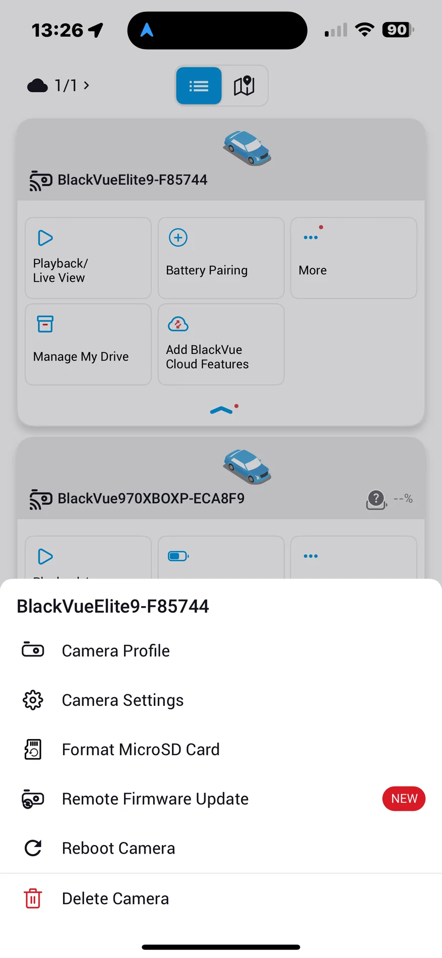

While prepping the Elite 9 dash camera for my power consumption tests, I wanted to update the firmware from v1.001 to v1.002 via the BlackVue app on my iPhone. The Elite 9 was successfully updated to v1.002, but I ran into the same bug I've had with the BlackVue app where it does not recognize the fact that the firmware was in fact updated on the dash camera. The "Camera Profile" in the app continues to show the old version number. I've run into this before with a variety of BlackVue dash cameras. I reported it before, but Pittasoft was not able to replicate the problem, until now.
I captured some screenshots along the way of updating the Elite 9 firmware [showing the firmware was being pushed to the dash camera]. I started a screen recording after the update was processed by the Elite 9. The BlackVue app does not seem to re-query the firmware version of the Elite 9, so the "Camera Profile" was still showing v1.001 as the installed firmware version. This makes the BlackVue app believing it needs to continue presenting the indicator that a firmware update is available.
Yesterday, Pittasoft stated they identified the problem in the BlackVue app causing this issue. The fix is scheduled for a BlackVue app update to be released Monday of next week [12/15/2025].
Using the "BlackVue Viewer" app on my Windows computer, you can see the memory card data was updated to show that firmware 1.002 was installed.
Phone: iPhone 15 Plus
iOS: 18.7.2
BlackVue App: 4.12_4364
Dash Camera: Elite 9
Original FW Version: 1.001
Updated FW Version: 1.002
I had the same issue on mine, but after a couple of reboots of the camera it resolved itself and re-queried the firmware version, showing the correct one and no longer saying update was available.
I assumed it was just my issue because first update attempt said update failed, because I used the phone app but left it run itself and the phone screen went off which causes issues with BlackVue app going to sleep (I hate this when trying to download footage from the app, you have to keep touching the screen so it doesn't go to sleep and stop the transfer).

BlackVue App Update
In post #11, I mentioned the BlackVue app was not detecting that the firmware version had been updated just after the app was used to push a firmware update to the dash camera. It was stated that a BlackVue app update would be released by Monday [15-Dec-2025] to address the bug. I found an update available for iOS devices on 14-Dec-2025. Version "v4.13_4376 (Release date: Dec 12 2025)".
When I connected to the Elite 9 with the updated iOS app version to view the settings and then exited back to the Camera screen on the app, the camera's profile was updated with the correct/current firmware that's installed. The Elite 9's "Camera Profile" now shows a firmware version of v1.002.
There appears to be an Android BlackVue app update available as well. Version 4.17.
