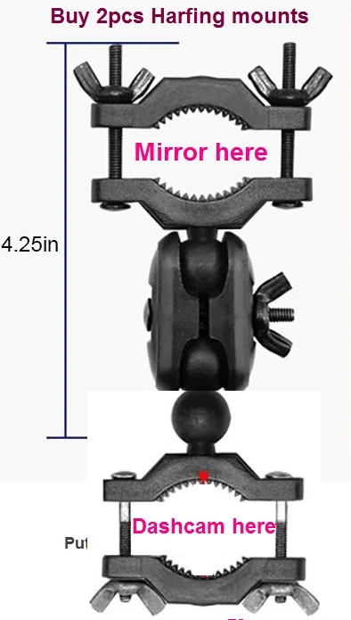

I modified the Harfing product picture presentation just to show you how to use 2pcs of this mount to obtain one mount for B1W.
enjoy,
Mtz
Ahh, that seems like it will work. Thank you very much.

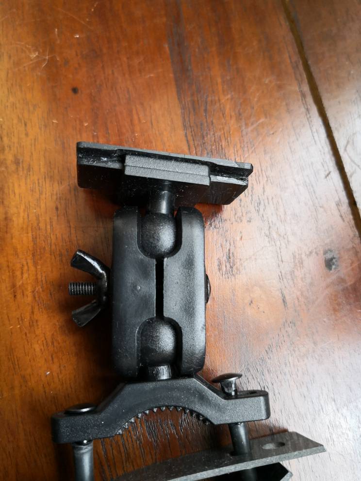

I cut the plastic clip off the g1w mount from blueskysea and just used the cameras adhesive mount to stick it to the flat plastic
Thanks for the idea
By the way, the manufacturer says it is made in hard ABS, but I have my doubts. The glue for ABS does not work at 100% and the plastic is not so hard.

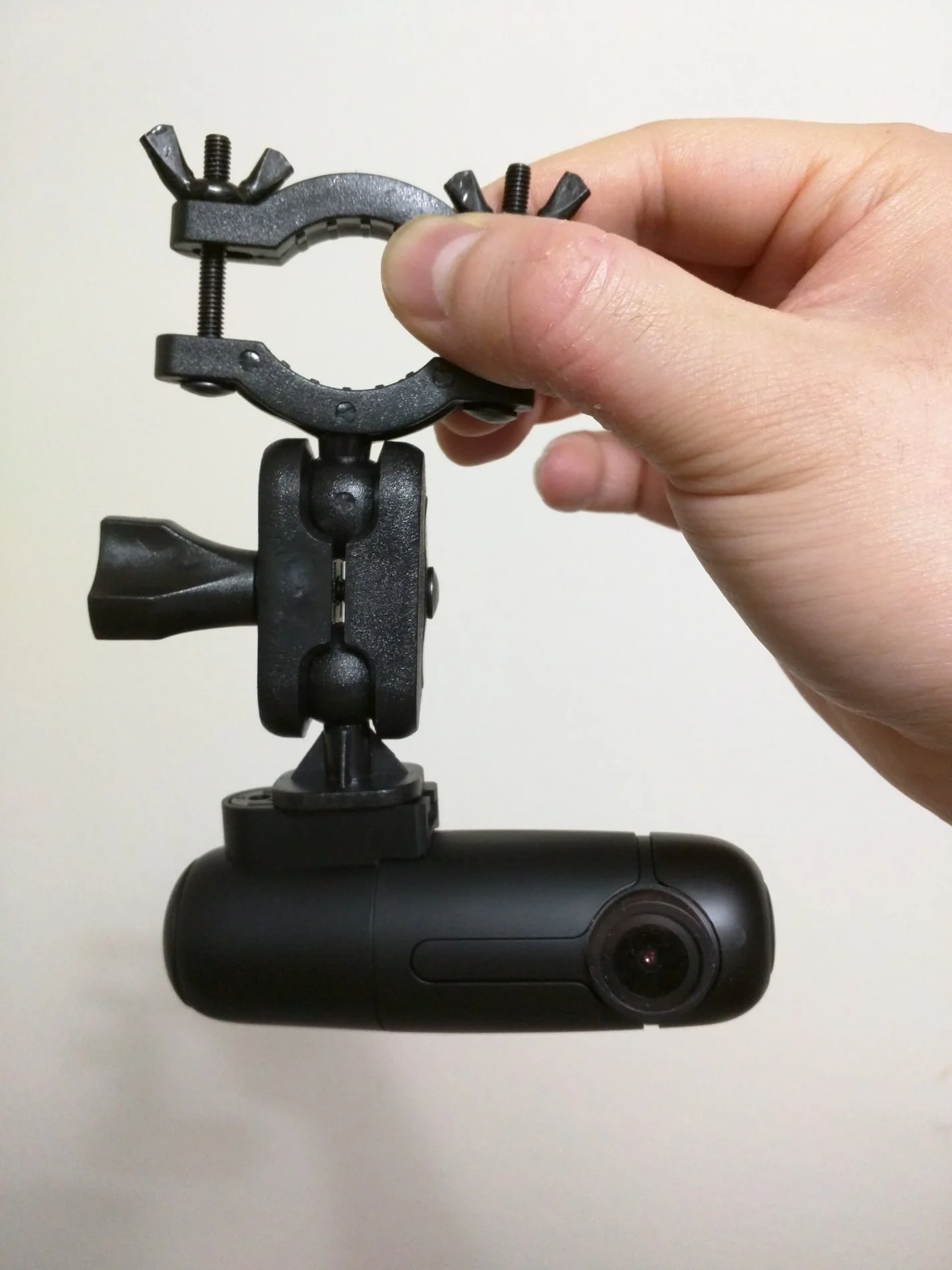

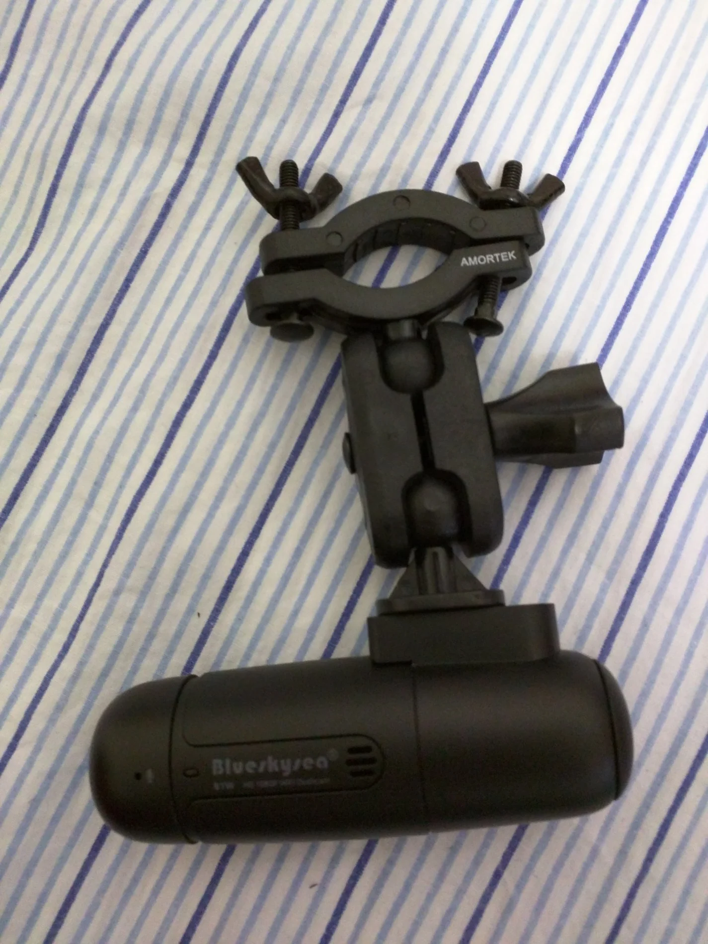

I was able to finally purchase a B1W cam off of Amazon a couple days ago when they had a lightning deal and from member @Mtz's suggestion, I went ahead and purchased two AmorTek mounts (The Harfing mount is out of stock at the time of this post) to put his idea to use.
Upon receiving my packages, I only opened one mounting system to see if any of the joints will work without needing to use part of the other system and I can confirm that it does. One of the joints fits pretty snug and feels like it will hold the cam securely even through some bumpy rides. It does not click to lock in like the factory mount but it did require a bit of pressure to slide off but not enough to where it feels like I'm going to damage something. This would be useful for if you want to unmount your cam.
I attached some pictures to show the mount system in use with the cam.
I hope this post can be useful for people looking into purchasing this cam and would like to use the rear view mounting system like I did.

Thanks for the info. Unfortunately the brand that I bought did not have any piece that adjusted, even regular, which would have made things much easier.

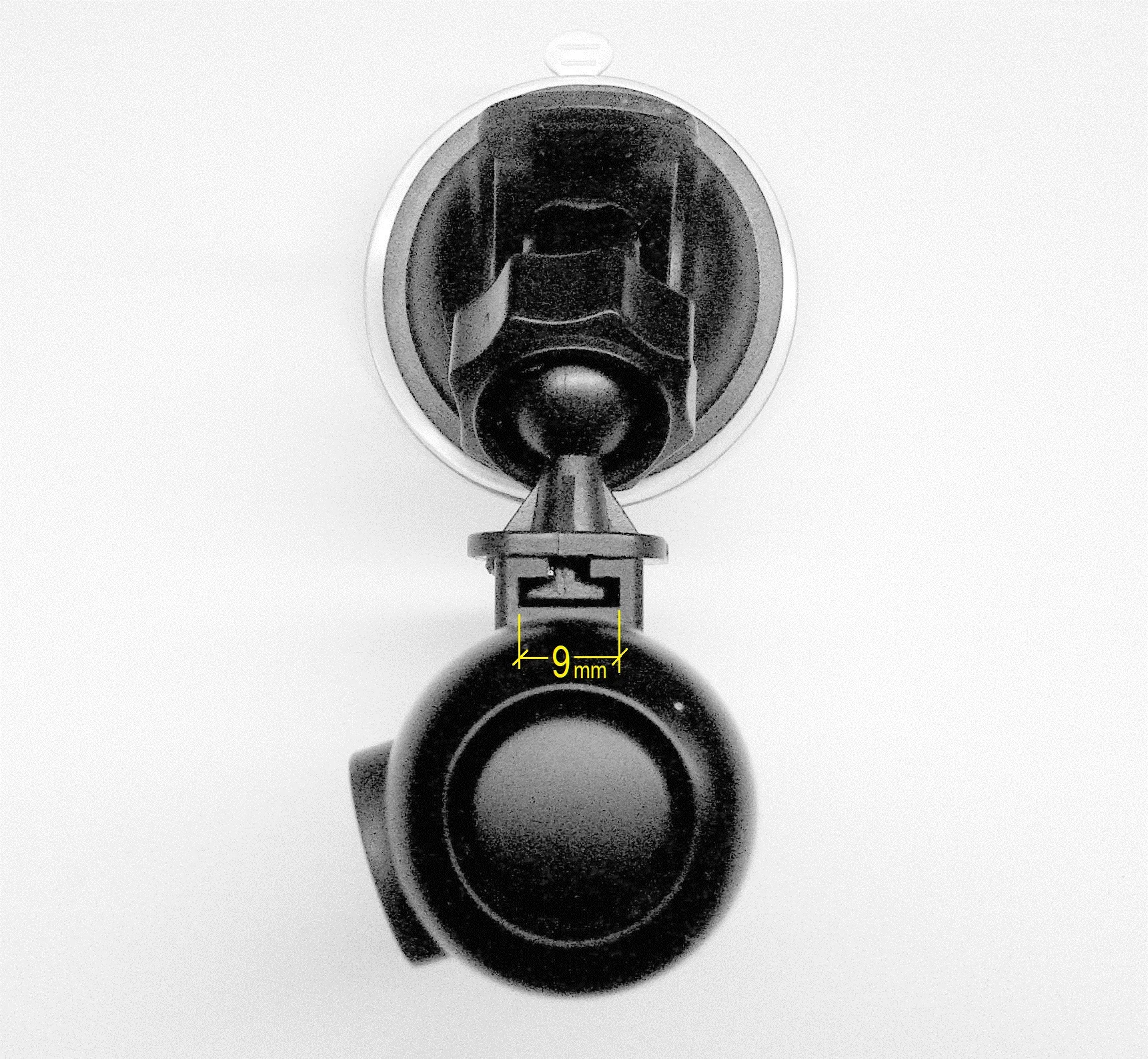

Yes, I use the sucker mount during the tests, because I have to install B1W in different cars.
You can use such as: https://www.amazon.com/gp/B00EMVOV3U or similar.
You may need to modify it a little (Do It Yourself :)). I used the needle file. I also use 3M, keeps B1W very well
suction cup_B1W_DIY_1.jpg suction cup_B1W_DIY_2.jpg suction cup_B1W_size.jpg

Thanks, it looks very good. Although I thought of something that was a clamp, this other solution is better since it does not need to be adjusted every time you put it on.
I do not worry about having to modify the anchor but if what some users say about the operation of the suction cup ... I'll think about it
What is the size of the accessories ball? maybe the ones I have from the support for the mirror
For the mount that I use, the ball diameter is about 15 mm, others may differ
