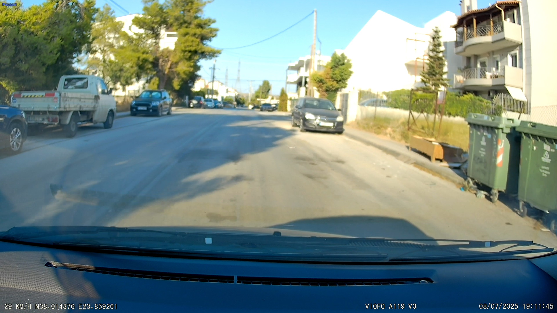

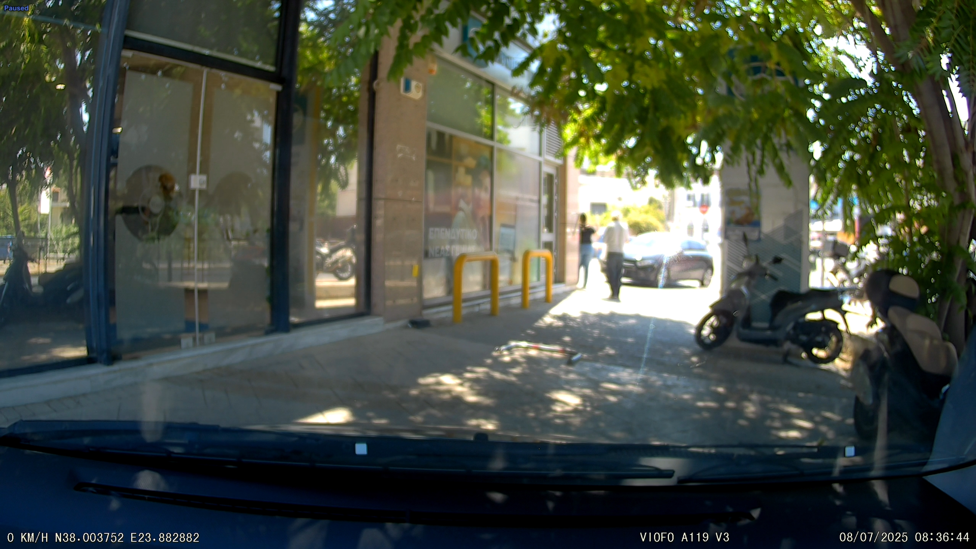

Not sure what to do, I have a camera that is out of warranty , and the left side of the image is blurry.
When one side is blurry it's usually a misaligned lens base. As VooDoo411 so kindly posted above, look at THIS THREAD for more on the subject. Gets a bit fiddly to work with but go carefully and you might find a fix.
